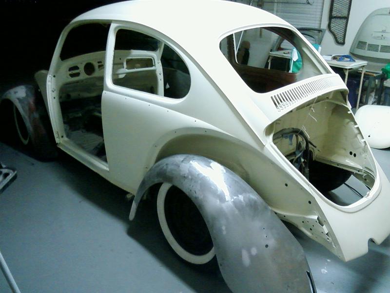

Thanks , I thinks everything will be ok then , I will be using a 1.3 tip on my HVLP gun , is there a certin PSI that anyone would recommend ? Ive done the under side of my hood at 40 psi and had some runs , i believe i should turn it down a bit !!! JUST FYI , Im painting it Agave Green !!! you can see the car on my pics before the DO OVER !!!!

thanks for all the suggestions , it will help me tremendously !!!! jp , heres a pic about 3 weeks ago , i will have more soon !!!
