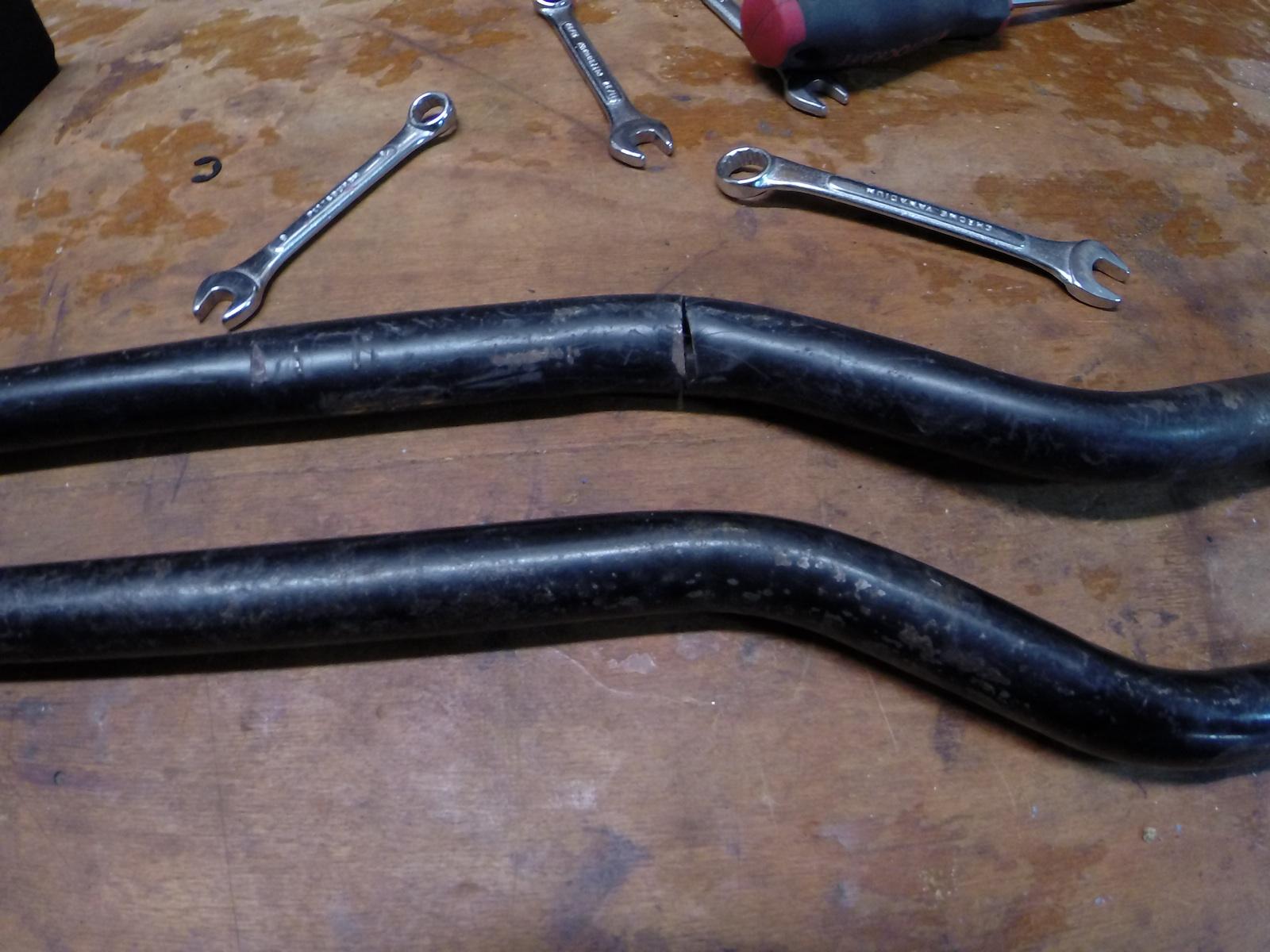

I had same probelm two weeks ago...turned out to be a cracked shift rod…pretty easy to spot and fix. I hope yours turns out to be as simple.
