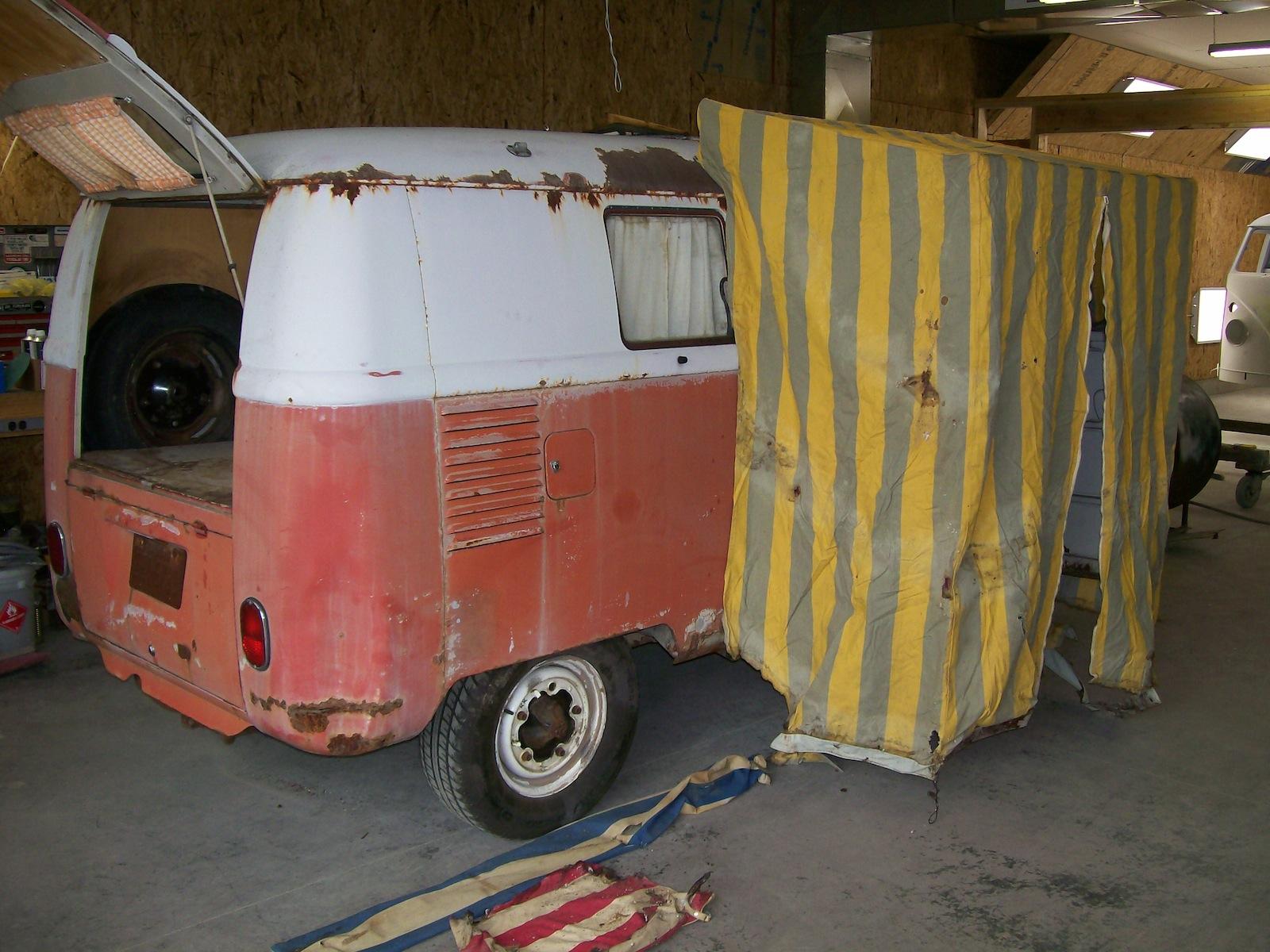

Pic from PO (Kevin) before it shipped
The bus is about as complete as you can get and the PO kept everything together (tent, tire table mount, cabinets, safaris, flipseat, subhatch/hardware)
And when he sent me the title he included a little surpirse:
In addition to all the extra so34 stuff Kevin was nice enough to send the bus with two of his own wheels on the promise that I'd send them back. (two of the so34 tires wouldn't hold air.)

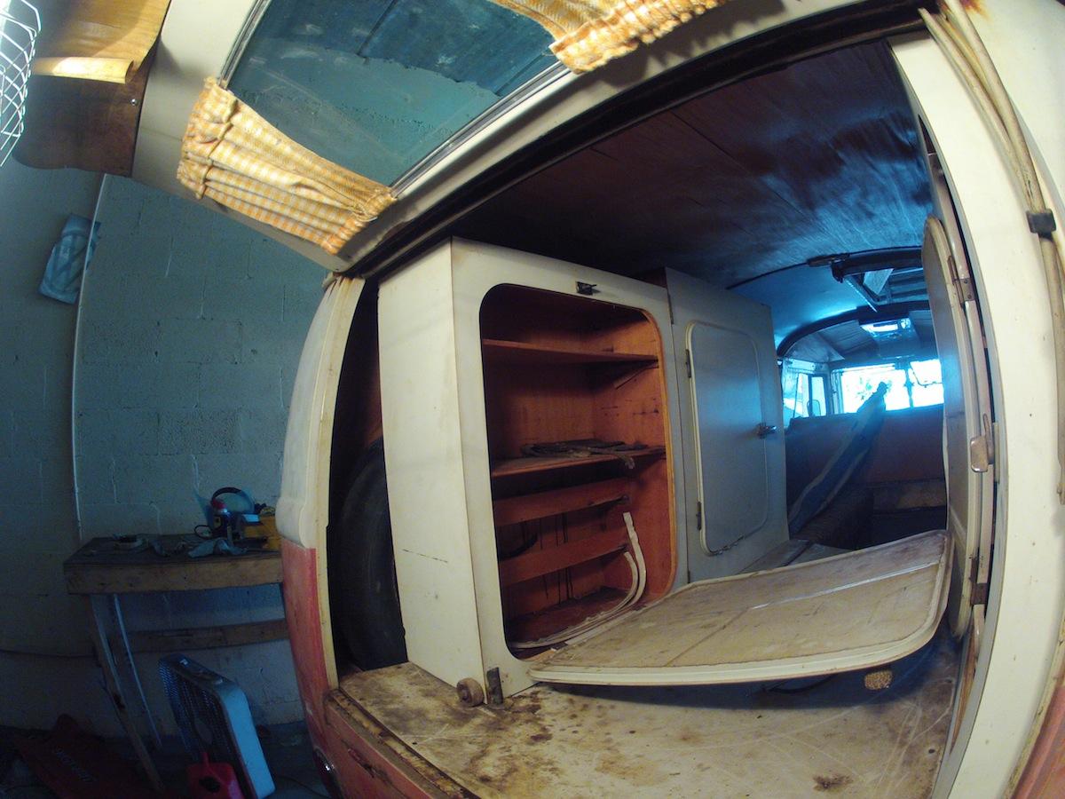

Some more pics:
spare tire table mount and original curtains
better shot of curtains

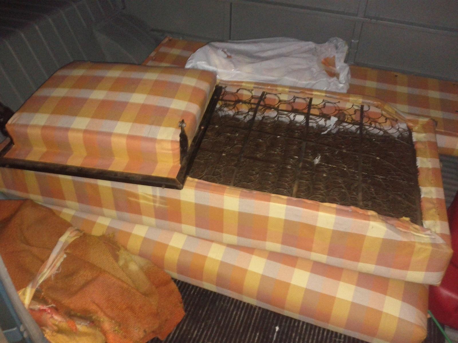

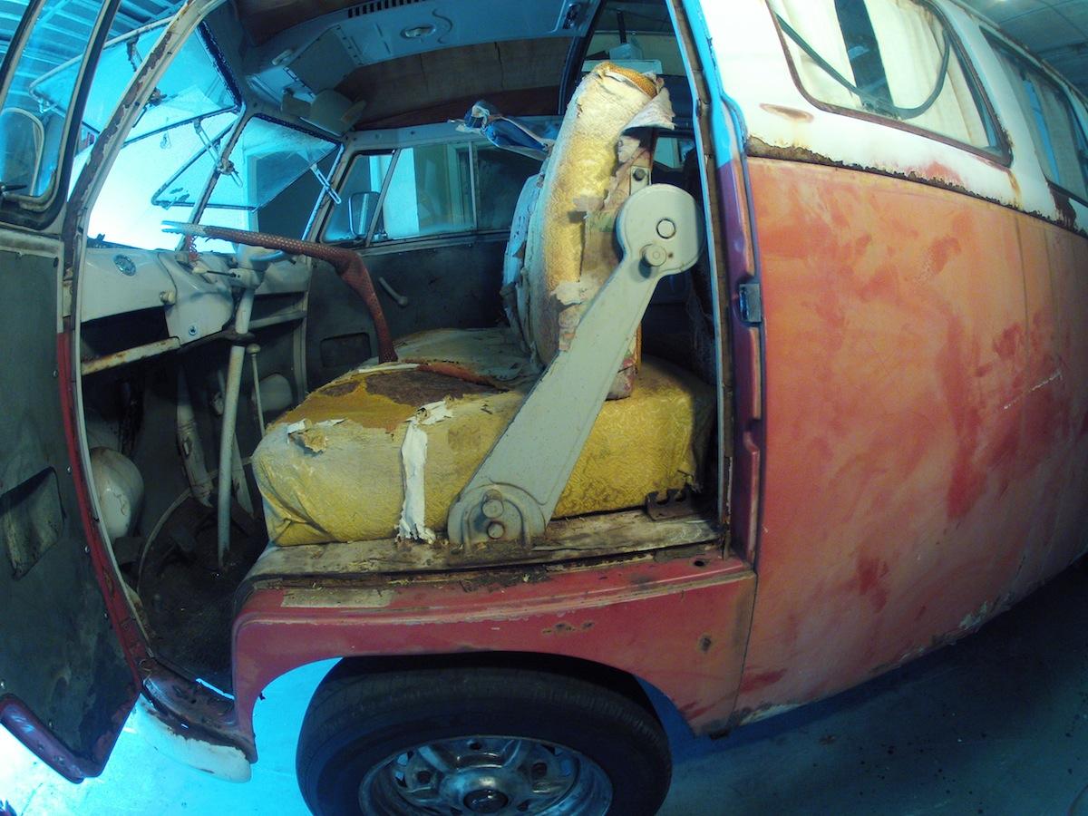

interior had two layers of reupholstering over the original (but totally shot) plaid:

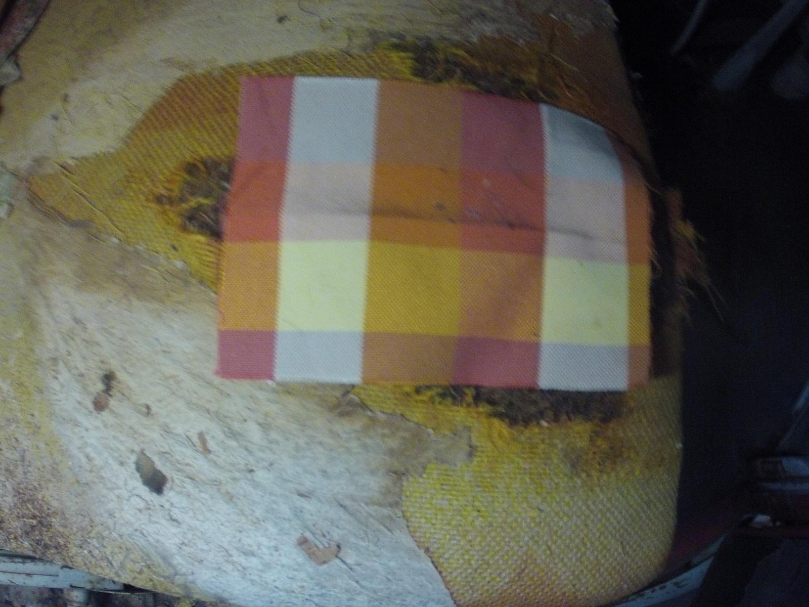

I found a supplier for close match on thesamba classifieds
seats now covered in the new
comparrison to the original (this was the biggest piece that wasn't threadbare)

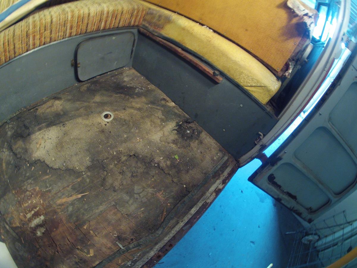

Has all but the cargo door cabinets. The laminate is nice, complete and should shine right up. I had Jeff from thesamba classifieds make me a replica for the cargo door.
Sisal mat is beyond repair but all the metal rings are there. I've ordered a sisal carpet and will try to make a replica. (Stay tuned for pics) You can also see how nice the lower panel laminate has held up...totally dry and firm. Also, a nice view from rear of flipseat.

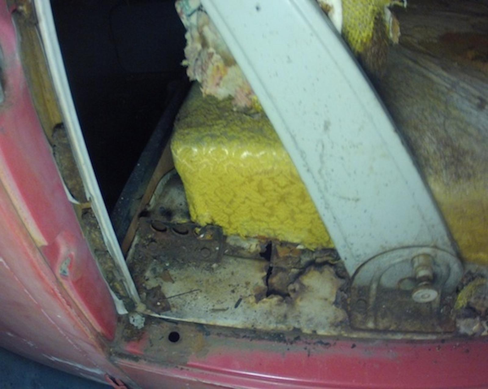

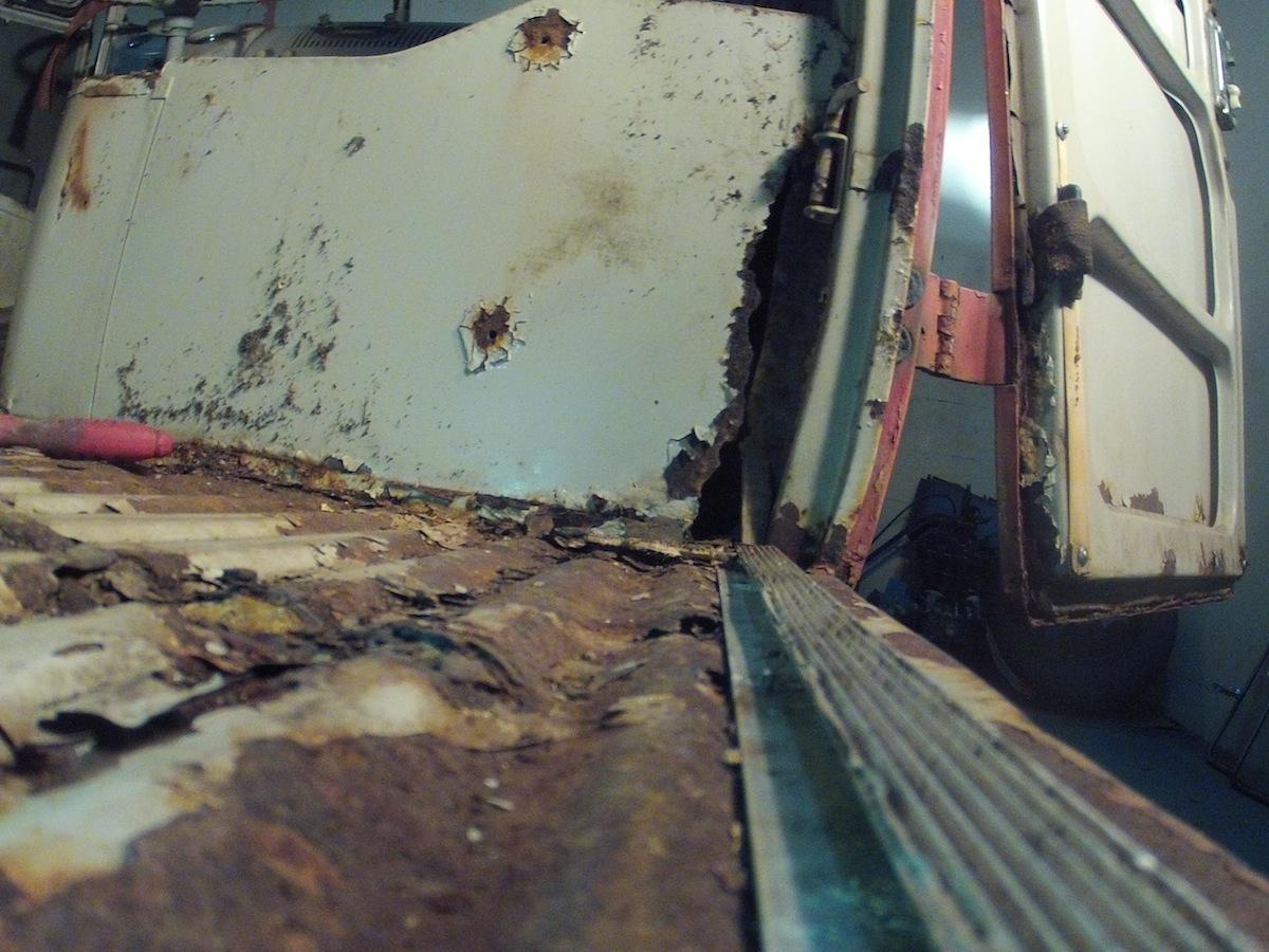

Flipseat arms are perfect but the mounts are totally rusted out
None of the interior wood panels survived. Floor, side and ceiling panels all flaked and thin as paper.

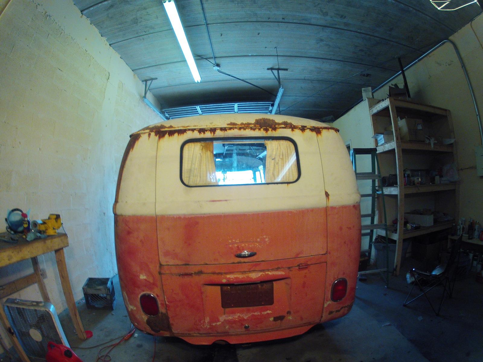

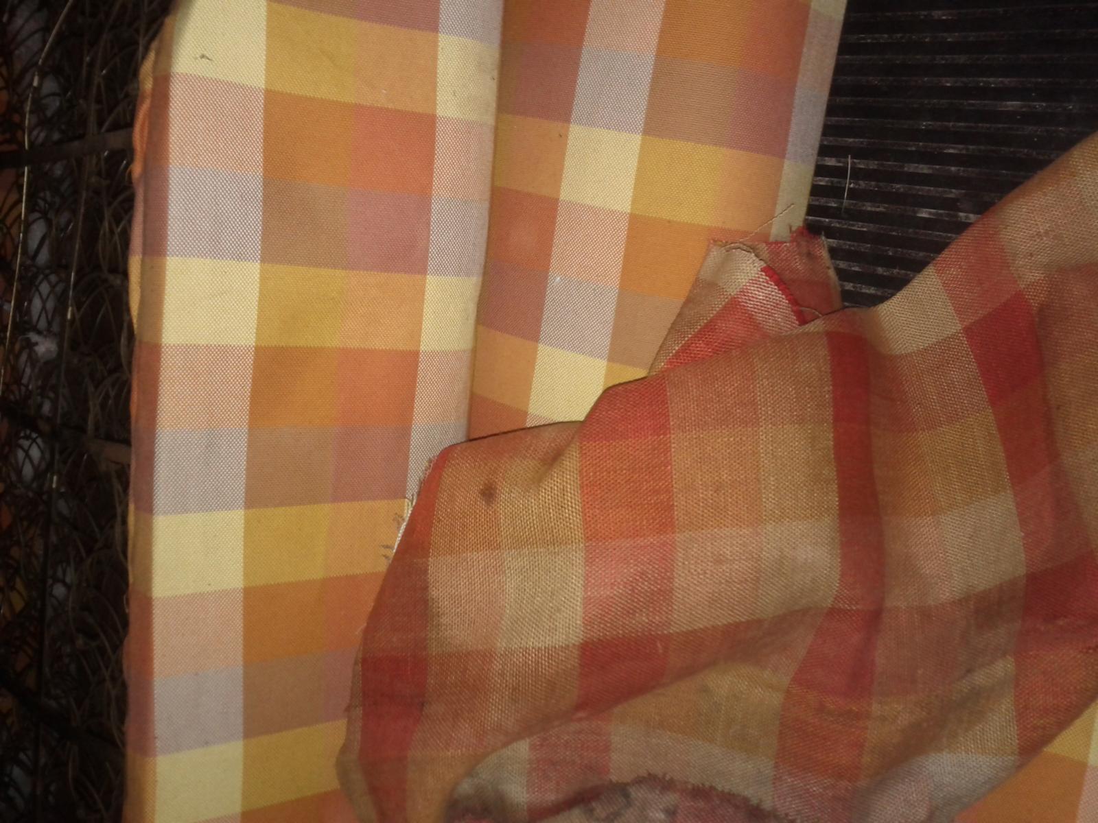

I'm not sure those curtains are original, they're not like the usual single colour yellow or Red ones, but I guess they could have used something different Question

Those strengthening plates under the flipseat arms are massive rust traps, my bus has had repairs in those areas which aren't great and need redoing, the plates are also no longer present, so I need to make some I guess, Fred on here is also looking for some...

Thanks for heads up on the curtains, actually I've only got some vintage ads to go by and I've seen both solid and a yellow/white checker. Moot point anyhow as I went with a matching but different pattern for my replacements.

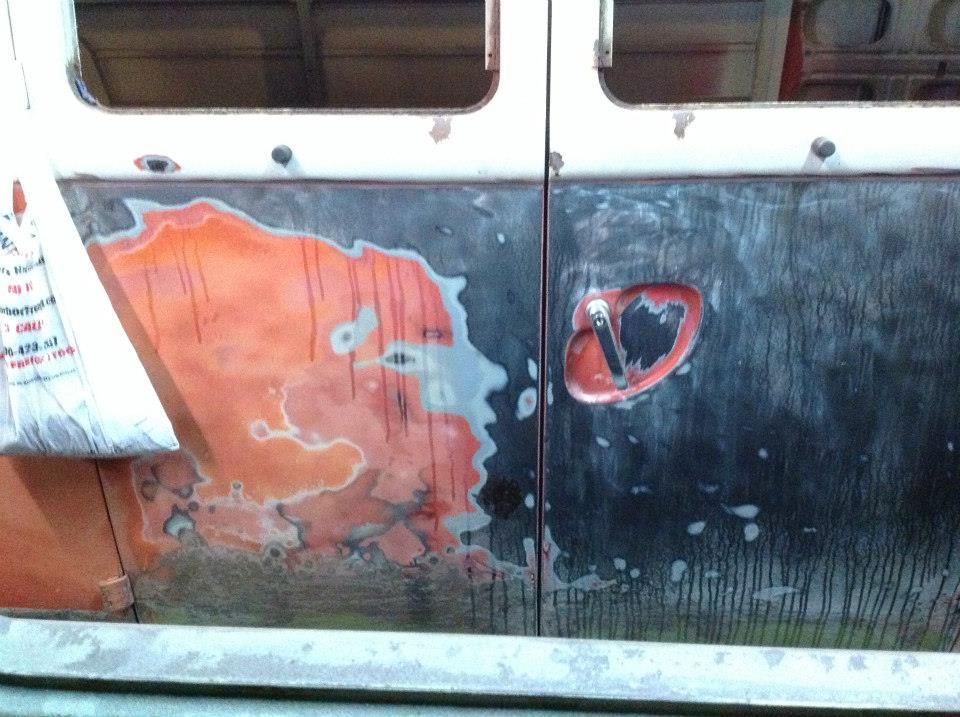

Make sure that anyone who uses a wire wheel wears a face shield (ear plugs, too), as pieces of wire come flying off at high speed. The best setup is a twisted wire wheel on an angle grinder.
You will have a labor of love and it looks like a good project.
She posed for the pic...wasn't really wire wheeling the bus. My biggest problem from those little bits of wire is they get in my t-shirt and stab me when I sit in my car to drive home Confused

I do not know if you own one but, as I noted earlier, you need a twisted wire wheel on a name brand, i.e., Makita, angle grinder. Besides using it with the stock attatchment to grind down welds, you can put a rubber backing on it with disc sandpaper on it. It is a great tool. A small wire wheel with straight wire attatched to a drill is a joke, which you probably just used for the picture.
Yeah, I was just taking a few spots down to see how bad they were while waiting for my brother to wrap up on his bus for the day. Then my wife wanted to see what it was like to strip some rust. She gave it a centimeter pass then I asked her to freeze so I could take the pic.
I still may end up sending it out for soda blasting but I'm trying to do as much as I can myself....bad experience last time I sent my other bus out for blast/paint. If I decide to do the rust myself I'll look into the Makita.

The twisted wire wheels are much stronger than the straight wire ones and they, thus, are better for heavyduty work. I would not recommend the wire cup since the wire is straight and spread out horizontal to the surface that you are working on so you cannot get a lot of leverage like the twisted wire wheel. You can use the straight wire ones for milder jobs but I just use the stronger twisted wire wheel for everything. I have a cup but I do not like it.

Bus stripped and ready for metal work.
Here's Darth Wolfsburg's bus after the twisted wire wheel treatment. Also ready for metal.
