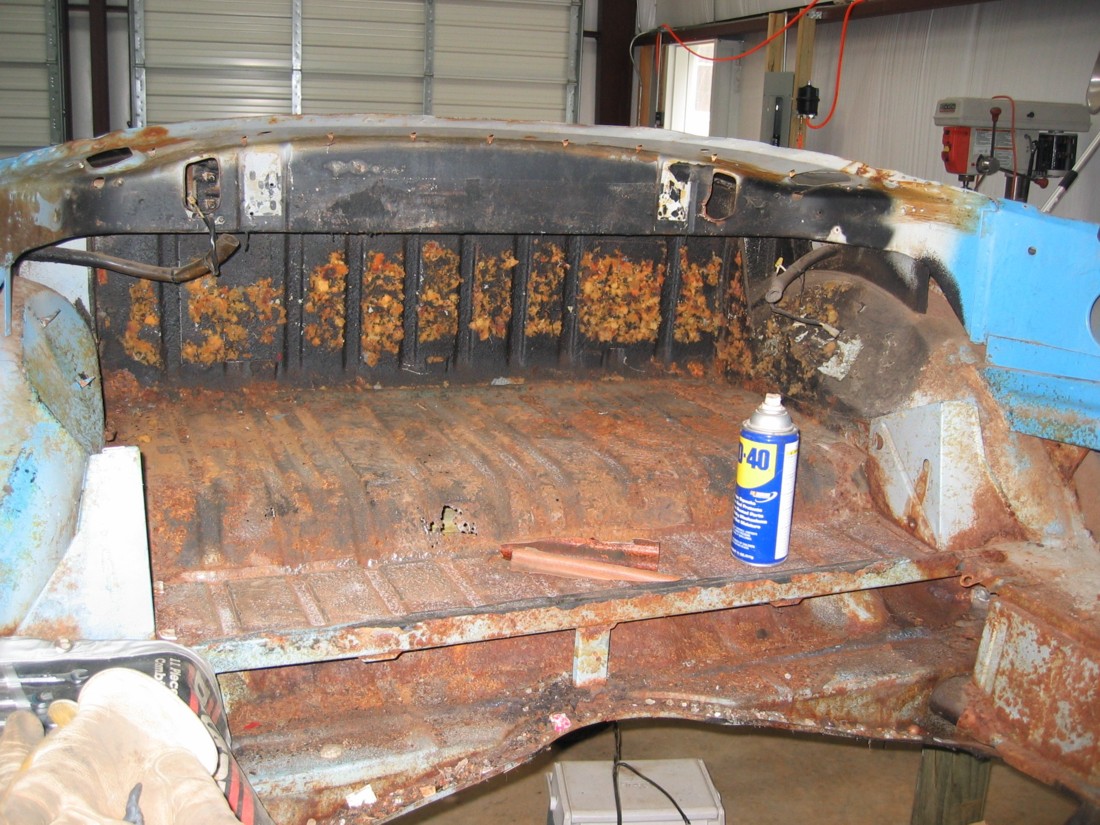

As you may or may not know, my son and I are working on a 70 Ghia vert. This is the first of what hopefully will be many updates. We have been on the car about a month. Tearing it down right now. I swear it takes twice as much time to learn what to do than to actually do the job. A lot of reading and learning that is for sure. It is the first restoration project for both of us. He is 13 right now.
The car has a ton of rust but one major ding in the back engine compartment. This is a picture of it and I am not sure if it needs a new panel or if it can be bent back into shape. Suggestions welcomed. The Left third of the engine compartment is okay except for the molding slot is rusted away. The center third is higher on the right than the left and the right third is alright. Any suggestions?
Here it is body off. Hard to believe my 13 year old son, 11 year old daughter and I got this thing on the dolly. I just couldn't wait an hour for my wife to get home.

Also, the rear of the car needs a bunch of panel replacements and we're not sure if we need a rear clip or not, what do you think? Price would probably be crazy high.
Last question, my rear luggage area looks good on the back of the fire wall but the main floor of it is really pitted out. What are the options here?

Back of firewall and rear luggage looks solid but the left and center thirds and rear apron need replaced.
Rear luggage is pitted through in a number of places and I am not sure how to handle this.

It seems to me that the inside of your front fender will clean up well with media blasting, but do you plan on doing it yourself, or have someone do it? Anyways be careful if you are using sand, as too much pressure and volume may heat the panels, and warp them. Some professional blaters use nutshells, soda or other less agressive media, so you may want to go that route.
As for the parcel shelf, here I am on thin ice.. but it seems to me that your best bet would be to find a replacement shelf. I know they make decent replacements for the beetle, but I dont know if they fit. Others in here may know that. I know the rear inner fenders are marketed as the same for beetles and Ghias, so there is a chance they fit. The other option is to go to a place like HouseofGhia and ask whether they have used parts.
