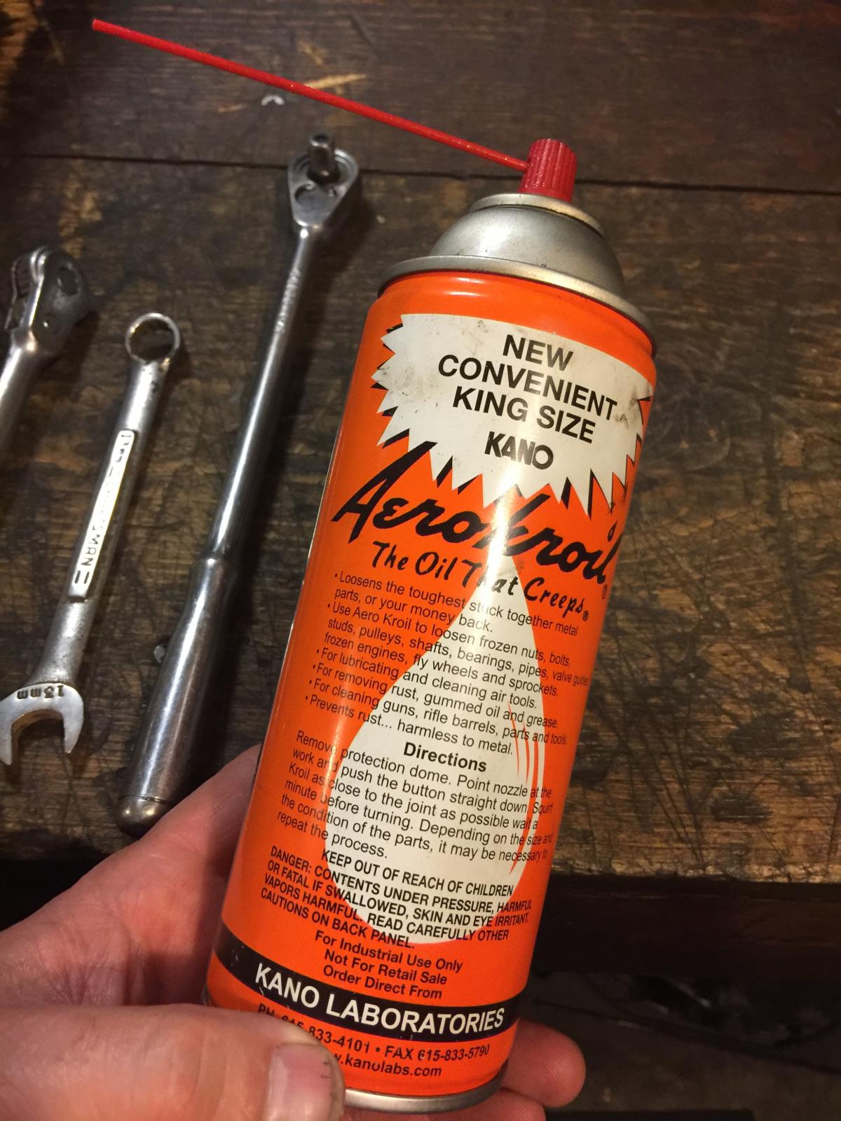

PostPosted: Mon Apr 10, 2017 4:44 pm    Post subject: Re: Stuck Lug Bolts on 61 bus Reply with quote
This works a lot better than PB blaster

PostPosted: Mon Apr 10, 2017 7:39 pm    Post subject: Re: Stuck Lug Bolts on 61 bus Reply with quote
It could work better than PB Blaster and still not work a whit.
PENETRATING OIL is a myth. It names a product that sells you hope, but does not penetrate. It cannot. The rust in the threads makes an interference fit of a few thousandths.
I've dutifully soaked with penetrating oil, then gave up and sawzalled the the nut lengthwise. It does not penetrate.
Have you ever seen a leaf spring on a modern US truck from the rust belt? That rust will swell so much that it will break the leaves or pull apart rust weakend U-bolts.
The only thing that works is HEAT and leave your propane at home unless you have oxygen also. You need to get the outer hole RED HOT to get it bigger than the inner bolt PLUS a few thousandths of rust.
ONCE IT IS MOVING, PENETRATING OIL IS GREAT. KEROSENE WOULD DO JUST AS WELL, or motor oil.
Luckily, the wheel bolts are usually not badly rusted.

PostPosted: Tue Apr 11, 2017 6:04 am    Post subject: Re: Stuck Lug Bolts on 61 bus Reply with quote
Al
A myth yes indeed that's why the worlds largest airline has used the product I showed you for years. Tens of thousands of mechanics and engineers believe a myth. Hahahah.

PostPosted: Tue Apr 11, 2017 6:17 am    Post subject: Re: Stuck Lug Bolts on 61 bus Reply with quote
Zundfolge1432 wrote:
Al
i know engineers who use it for hinge bolts or inside a lock mechanism. not for lug bolts

PostPosted: Tue Apr 11, 2017 9:30 pm    Post subject: Re: Stuck Lug Bolts on 61 bus Reply with quote
PENETRATING OIL is a myth. It names a product that sells you hope, but does not penetrate. It cannot. The rust in the threads makes an interference fit of a few thousandths. ...
Al
Well, maybe I should have spoken more carefully. Penetrating oil will not penetrate rust seized threaded fastener assemblies (bolts and nuts rusted together).
At least not those TIGHTLY rusted and seized.
And please do not tell me that any airline allows its fasteners to become rust seized like the mossy rusty bus in Clara's picture above.
OF COURSE it will work fine for stuff still moving freely that has some clearance between the parts.
And, I agree that the product you have shown may be quite a good product, especially for keeping lube in tight places and those that move infrequently.
Where do you buy it?

Rust may provide an interference fit... "grows" in void space... but it is not a necessarily a fully homogenous mass.
On a micro scale... think open cell foam.
Kroil: "creeps into openings as small as one millionth of an inch."
I've had it in the squeeze can with the plastic dripper type tip . After years... the can was getting low & I hadn't used it much. Turns out, it was coming out the pinch-seam of the can... the seam down the side... and the bottom.
It penetrates.
