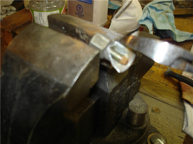

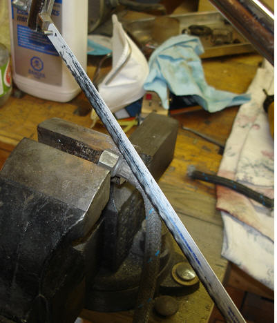

These 3 pics show the removal of the existing hose connectors
The ends of the hose barb has surface rust and will be removed

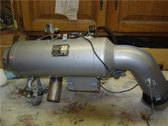

These are pics of the B2 unit partially assembled...

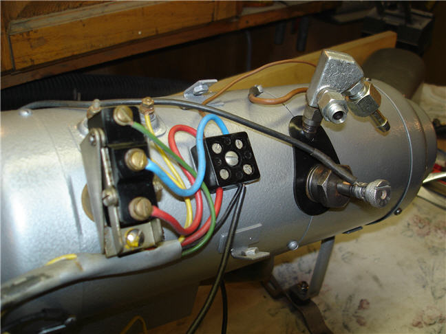

Detailed wiring and components

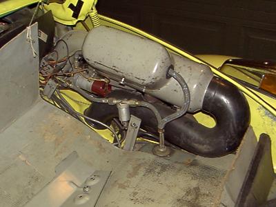

I had a B2 in my '66. It was easy enough to tap into the fuel lines at the bottom of the tank for the pick up and into the filler neck for the return. The neck was on the same side as the heater.
However, with the '70, the filler is external and on the other side of the car.
Is your gas tank already drilled for the factory Eberspacher pick-up/return? Do you have a plan to drill it without removing/draining the tank?
You can see where it goes into the tank in this pic.
