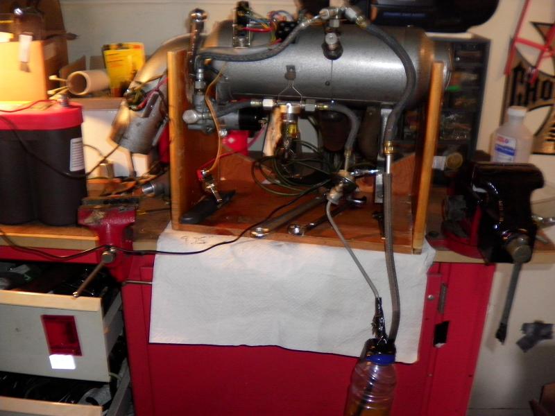

Making some head way.
My fuel pump output through the main metering jet is about 4.5 CC/min.
Glow plug glows red after about 15 seconds.
Fan runs slower while glow plug is energized then speeds up when I disconnect the glow plug.
I interrupted the fuel pump circuit with a switch so I could get the plug hot prior to injecting fuel.
BUT I still cannot get the heater to light off.
If I have run the fuel pump for say 90 seconds without the plug connected (not intentional as I had a bad plug ground) then heated the glow plug could there have been too rich a mixture to allow combustion?
This was the way I ended my heater session about 11 pm last evening...more tonight. And I will check fan rpm with a mechanical tach.
Pete

Still no light off!
I rechecked the fuel flow of the metering jet and it appears to be more like 6 or 7 CC/min as opposed to the manuals recommended 4.5 cc/min.
Checked the RPM and right on spec ~5000 rpm during start up with glow plug in the circuit.
The glow plug glows orange and touching a fuel soaked tissue lights immediately so why no combustion in the burner can?
I tissue tested the intake to the combustion blower and there is positive air flow in the correction direction.
What am I missing?
As said previously I interrupt the fuel pump during start for 30 seconds to let the glow plug get to temp then bring on the fuel. How long should it take for combustion to occur? I let the fuel flow for a minute of so and when I smell fuel shut everything down.
I am using 100LL av gas and once 35 years ago could not get a 2 stroke race bike to run worth a darn so will try tonight with auto fuel.
Any help is appreciated,
Pete

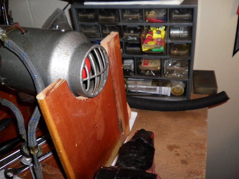

OK pete 180 ,today was the day . I finally got the damn thing to lite up. Mine was doing the same as yours.Had everything running.Fan;glow plug;fuel pump,and it wouldn't do anything.I was beginning to think heat exchanger was the problem.Anyway here's what I did ( I'm stoked man) I put a switch on the fuel pump to delay the gas, this probably helped the matter.But I think the big solution was I reset the Thermo switch.If you haven't done this you might try it.I took it out a few months back but didn't mess with the setting screw.So it was easy to come out.Turned the screw in until a click then slowly out until another click then back in 120 degrees or 1/3 a turn.When it started making a weird sound it never did before I knew what was about to happen.Well it started blowing enough heat to probably warm up my one car garage.After I shut it down it kept running like it was suppose to but I couldn't remember how to fine tune the thermo switch.Ran back upstairs to computer pdf file .Back down to garage, turned screw back in just a hair and it shut off. Its suppose to run on 3 minutes I think. I also ran a hose from the intake air like it would be on the car.Anyway here's some dangerous looking pictures to some. Didn't leave off any real bad emissions .Not any black smoke.My wife will notice the smell when she gets home from work though.
regards
Tom

This is another B2 I bought last fall for an offer I couldn't refuse.It's a 12 volt if I ever need it. It has the missing parts I'll need for the 6volt install.The guy I bought this off of had another eber. from a Thing I wish I would of grabbed up on ebay.I think it went for under $50.Didn't want be greedy i guess.

I put some tissue soaked in auto gas in the glow plug and finally got the heater to light off. It worked as advertised meaning dropped the glow plug out of the circuit after about 30 sec. After about 5 minutes the heater cycled off due to the high limit switch opening the fuel pump circuit. After the fuel shut off and the flame went out the fan continued for ~ 3 minutes after shutting off the power on/off SW. I have not been able to get it to light off again and seems the glow plug is not hot enough. There is always fuel in the combustion chamber and the glow plug does glow red (orange) every time tested. Does anyone know how to get in touch with a service person?
