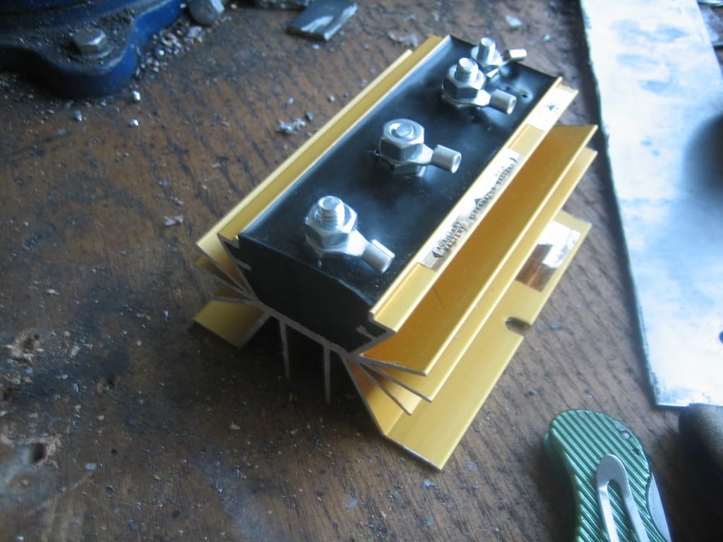

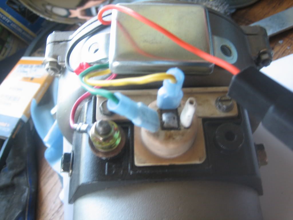

Im still a little confused on this I have a rebuilt 80amp motorola alternator with a external regulator. I would like to hook up the 4 post isolator. I think i just need to clarification on what goes where... here is what im working with... thanks in advance
