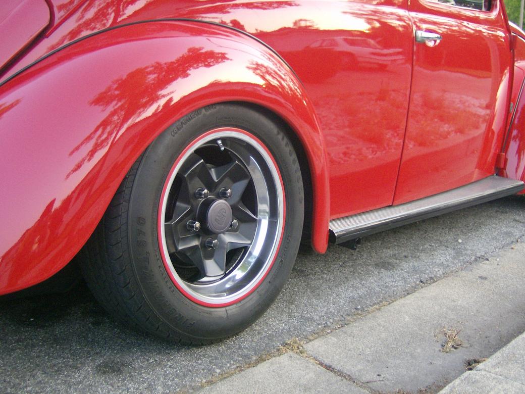

2 notches in the rear and drop spindles on the front, stock beam
not hood ride low or anything, but as a daily driver I wouldnt go much lower. the back of my car is so low that I can hardly get in my driveway, which is virtually flat, also be prepared to scrape in parking garages, inclines, and worst of all speed bumps. as for the front, I want to go lower but that would require smaller tires, adjusters, and a narrowed beam. as is, the 195/50/15s do not rub unless the car has a driver, 2 passengers and at freeway speeds
heres an idea of how much the rear scrapes...
Ive only been driving it for 6 months now and Im already missing 3/8 inch off my header and cracked the paint on my rear apron
however I get a lot of compliments on how low my car is even though deep inside I wanna go lower  _________________ MAIMAS... read it backwards

Maimas13 Samba Member
Joined: July 06, 2004 Posts: 642 Location: Redwood City CA
Posted: Mon Jul 07, 2008 2:45 pm Post subject: |
the rear is 4.75 inches off the ground. the real problem is that this low point is about 18 inches behinf the rear wheels, so when going up a slight incline it hits no matter what. of course this is with a merged header, id think with stock exhaust there wouldnt be any problems
in the pic you can see how flat my driveway is and that my car still makes some nice scrapes in the asphalt. _________________ MAIMAS... read it backwards
