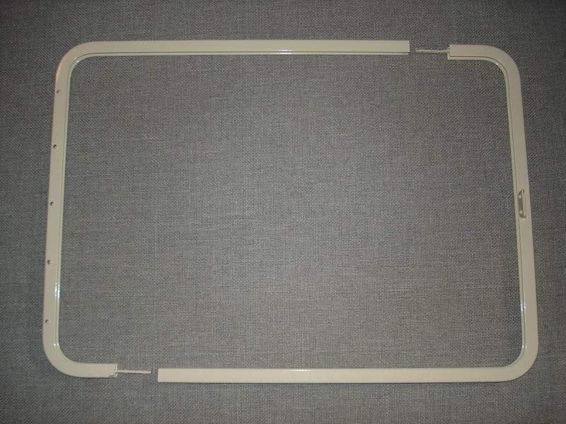

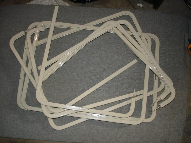

I sent the frames out for sand blasting, zinc primer, and powder coat. Then proceeded to reassemble.
Reassembly:
Frames were beautiful after powder coat. I re-tapped the holes after the powder coat as even with the little rubber blocks, coat / paint fouled the threads. I had to remove the outside edge of the powder coating from the threaded tab that slides inside the other frame half on each side, as the powder coat build up made the connection to tight. I used a sharp razor blade to remove the powder coat from the edge, being careful not to scratch the visible portions of the frame (see picture below). Work on playing with the various halves and see which ones fit well together, complete your planning before starting assembly.

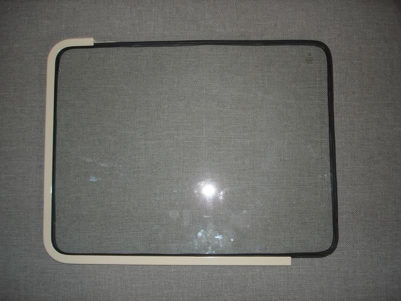

Fit the glass to frame seal on the glass. I did not need any adhesive, and had no issues installing the Wolfsburg seals.
Get two frame halves, and work the details / fit, and screws / screw holes into a decent fit without the glass. They should fit tight, but not be hard to connect or screw together without the seals and glass in. No clamping at this point just do the fits now instead of mid assembly.
Slide one frame half over the window. Hit the outside of the rubber on the glass to frame seal with 3 in 1 silicone lubricant, only on the one half. Watch where your logos end up. Should be on the upper rear corner of the assembled window, so pre-think a little, reverse opening fronts would be different then rear two and driver’s side is different than passenger (technical, but as long as you are going through the effort…). Once you get the first half of the frame mostly on, I pressed down on the frame on a soft surface to get a little better completion.
Now 3 in 1 the other half of the seal, and slide the second half on. You will NOT get a tight connection, that’s what the clamps are for.

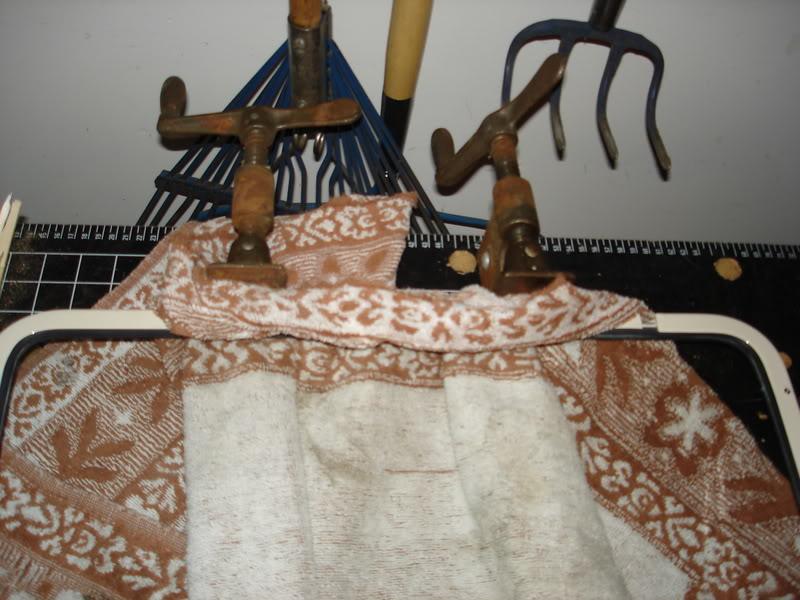

Use screw type bar clamps. Easy with these, and it will not really be possible with anything else. I placed the now ready to assemble window onto two bar clamps, the clamps underneath were going top to bottom in the frame (see picture). Use wood scraps or towels, etc to prevent from scratching up your frames. Gently, not tight, tighten down the two lower clamps until the frame is squared up (see picture). Then install the two top clamps, front to back (use wood here, the screw pressure is greater), and tighten down evenly between the two bar clamps (alternate). Use the clamps until everything is tight, and you can see the screw threads through the frame. Install the four screws, 2 top, 2 bottom, and remove clamps.
