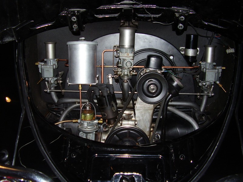

I am about to complete the plumbing for this oil filter...
Are there any problems running this filter? It's supposed to use a roll of toilet paper as the filter media. I'm mostly concerned with any low oil pressure that might occur. The oil comes out of the filter through a 1/16" hole into the 1/4" piping.

This was NOT designed to be a full flow oil system. It is a bypass system. A portion of the oil flow is diverted from the the oil pump and then through the oil filter and from the oil filter the oil is dumped back into the oil sump.
A bypass type of oil filter does reduce the oil pressure at the main oil galleys.

I agree.
If your engine looks like the one that you have shown then its a match.
If your engine is for function and you desire effectiveness then I think
the one you show is just a BYPASS filter and
the flow through itself isn't critical because its just a
branch circuit and not the main flow.
Viewed as "better than nothing" it was a vintage thing and the engine oil did all pass through it
eventually over hours of driving.
If thats the era and look I was going after, then I'de have one!

Thanks for all your comments guys. I'm not afraid of using toilet paper as the filter media...
http://www.frantzoil.com/TOILETPAPER.html
The concern I have is the amount of oil pressure loss by having some of the main galley oil flow go through this filter. I was thinking of checking my oil pressure before I hook this up, then hooking it up, and rechecking for any differences in pressure.

Is there some kind of restrictor or flow limiter that goes with a bypass?
Even though its small tube, that is a lot of flow when left un-governed.
In theory, the end-of line pressure spring should just hold back more to compensate the lost volume (to an extent).

PostPosted: Fri Oct 17, 2008 6:59 pm    Post subject: Reply with quote
Ok it's on and I didn't lose any oil pressure. When I first start I have about 60lbs and than once fully warmed up I idle at 15lbs. I guess the small 1/16" intake hole for the filter keeps the oil pressure high enough to work.

PostPosted: Wed Oct 22, 2008 7:00 am    Post subject: Reply with quote
Here's a pic a friend took at a local car show. The plumbing is done and it runs great. I have the return line going back through the stud that holds the dizzy clamp in place on the block. I had to modify a metric coupler nut and drill the stud with a 1/8" hole to make it work. Seems to be running good so far.
