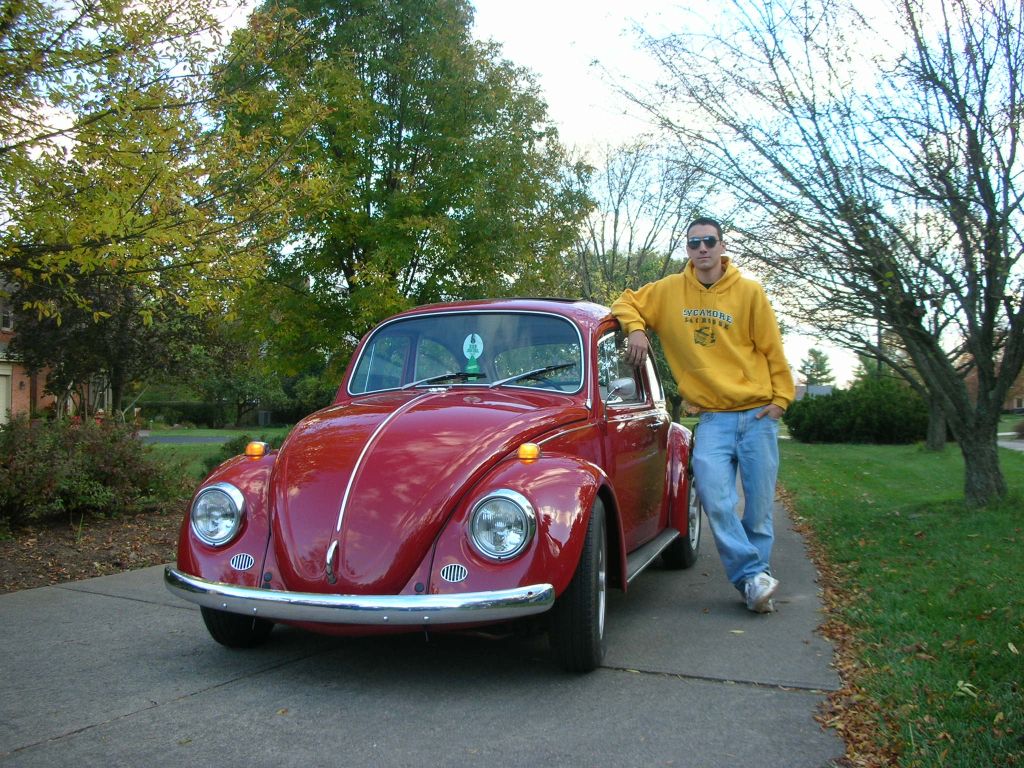

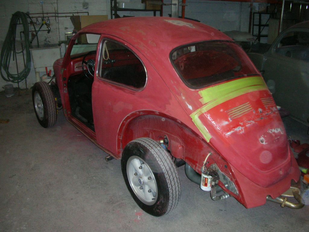

After working all summer and searching the Samba for months my 18 year old son found this 1967 Beetle locally. After careful inspection he decided to buy it for his everyday driver. The PO had done a great job with the engine but had not gotten to the body - but it was rock solid needing only paint and a headliner. Paint work started immediately and took about three weeks since he and I did all of the sanding at each step.
After paint it was on to the window seals, trim, and headliner. My son and I did the window seals and my wife did the headliner. The headliner, an original style, not the one piece, took two full days but came out very nice with only two areas where we learned what to do differently next time.

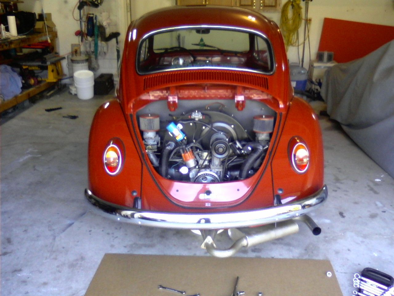

Finally, we pulled the 36 HP doghouse shroud and installed thermostat flaps and a thermostat. What difference that made!

Too damn cool Cool ! The bug is certainly timeless in its appeal - your son has good taste Wink . A red '67 with a sunroof.... awesome Very Happy

WOW!!! That is one nice car!! You guys did a awsome job. What color red is that??

Thank you! L456 Ruby Red

A couple of corrections; You do not have a 36 hp engine. It is a 40 horse or larger. Your gnerator stand bolts to the case but on a 36 horse it is cast as part of the case. Find the engine # below the generator stand and look it up on this site. Stock would have been a 1500 cc.
Not all fan shrouds are "dog houses". A stock fan shroud for a 67 would not be a dog house shroud. The DH shroud has a house in the back of the housing to make room for the offset oil cooler that takes it out of the cooling air flow for cylinder #3. Started with @ 1972 model year.
Very good idea installing the thermostat and flaps.

Sorry if I wasn't clear. The FAN SHROUD is a 36 HP doghouse type. The engine serial number is HXXX XXXX but modified to a 9.5:1 CR 1600 with dual Kadrons, a full flow oil system, and Gene Burg merged exhaust thanks to the PO. My son and I modified the aftermarket shroud to accept the thermostat flaps.
