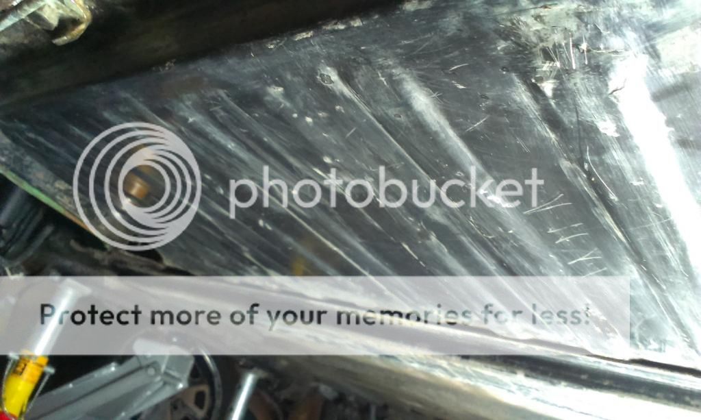

Spent the afternoon removing the og wax/underseal stonechip coating from the underside. Not much fun, freezing cold.
Nice original paint pan with no rust Very Happy
It was lifting and flaking in places so it had to be done as it has to survive the UK weather.
Anyone know what was used originally?

My two ex-US Cabrios have had what appears to be a 'dealer' or 'PD' (pre-delivery....not factory) applied plastic-based sealer. It seemed t work OK,.. but bith my cars are dry-state cars
I have 'restored' the chassis with priming, then apply a polymer-based stone guard type texture finish that is impervious to water etc
Then overpaint with colour/chassis black
