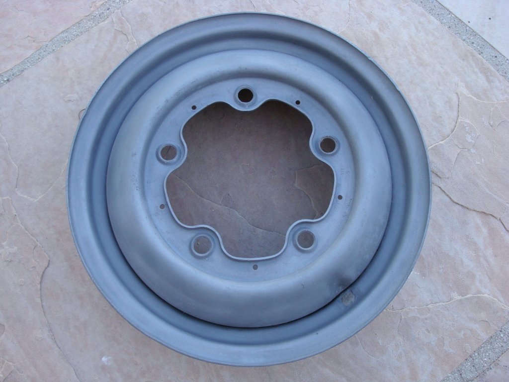

9/50 KPZ wheel:
7/53 KPZ wheel with recessed valve stem, fully riveted on back:
3/54 Lemmerz wheel

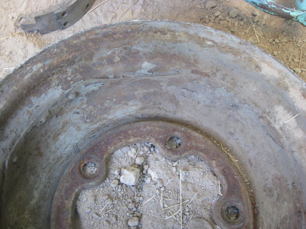

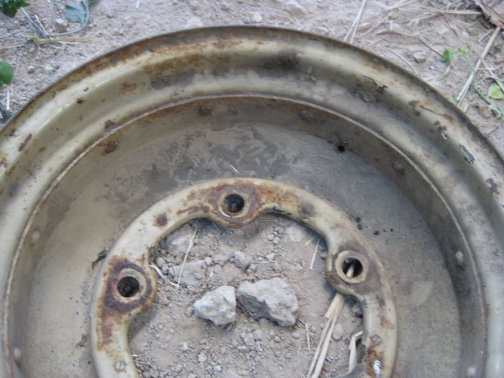

My rims
Date Manufacturer Recessed valve stem
1. 1/52 UNK welded NO
2. 2/52 UNK welded NO
3. 1/55 UNK riveted (unregular) YES
4. UNK KPZ riveted NO
5. UNK KPZ riveted NO
Number 4 and 5 has stamped an "S" and "415"below the S.
Note the different way these rims were riveted
This is Number 3
This is for numbers 4 and 5.
Regards
Marcos

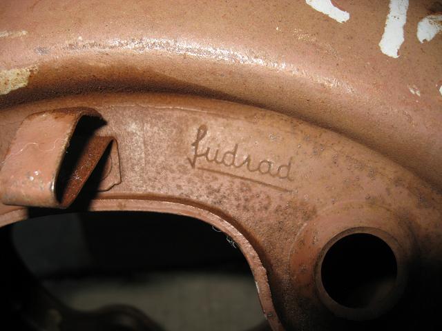

nos 11/58 fudrad
not nos anymore though...

Learn German, mate!
The company was called "SÜDRAD", not "Fudrad".
"Südrad" means as much as "South wheel"
Regards,
Jurgen

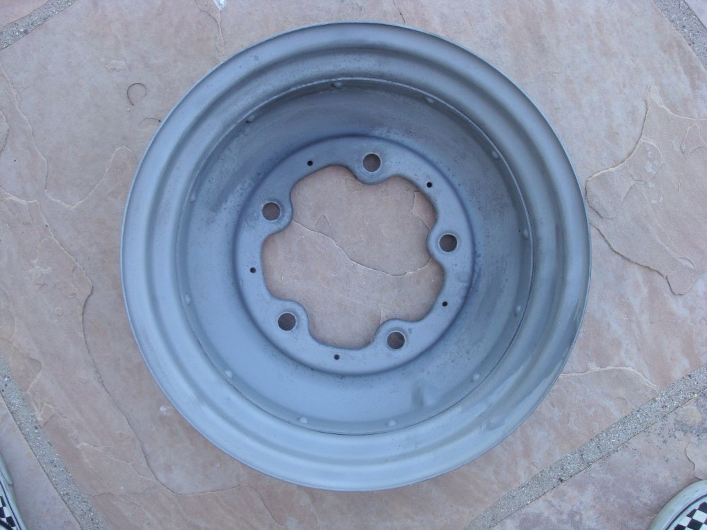

My 12/54.
8/54 lemmerz / welded / no recess.
8/54 kpz /riveted(3-3-3-3)/no recess.
9/54 kpz /riveted(3-3-3-3)/no recess.
My 1/55.
11/52 kpz /riveted(fully) /with recess.
10/53 kpz /riveted(fully) /with recess.
UNK kpz / riveted(fully) / with recess.

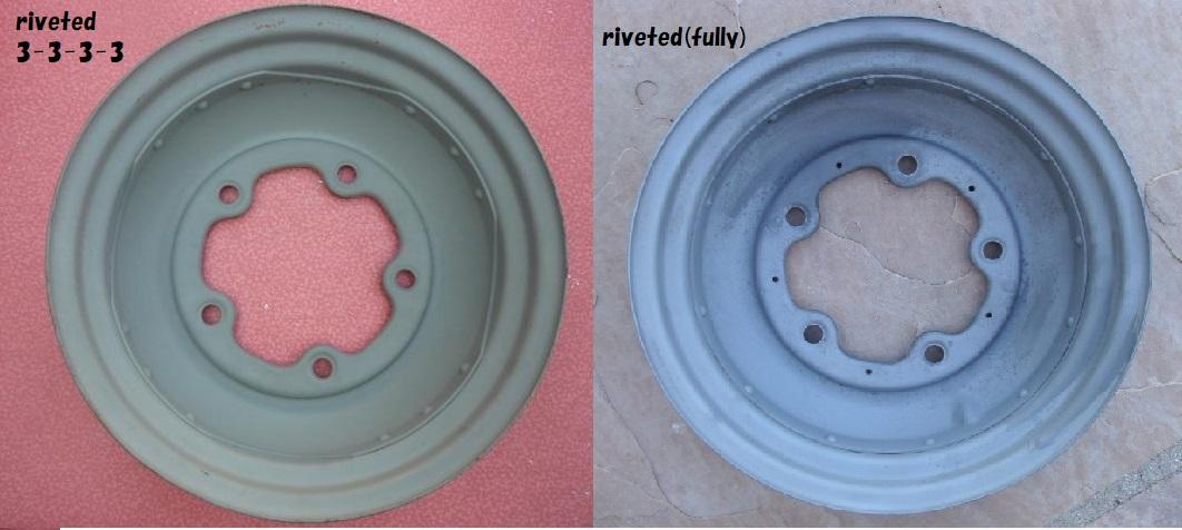

It is a question.
There are two types of rivets
as far as I know.
11/52 fully (mine).
7/53 fully (EverettB).
10/53 fully (mine).
4/54 3-3-3-3 (I bought It from arturo).
8/54 3-3-3-3(mine).
9/54 3-3-3-3(mine).
1/55 3-3-3-3(Buba).
Is there change time between October, 53 and April, 54?
Is having recess or not a timing same as the change of the rivet, too?
