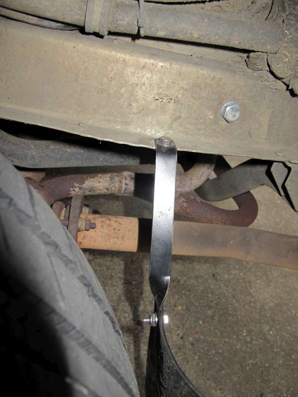

I made a bracket for the rear mudflaps out of 3/4 inch wide aluminum stock from the local hardware store, about $4 for a 4 foot length. See photo for details. It's reasonably secure. It has a 90 degree bend in it, made with pliers and a vise.

I like it! Good work around for a too $$$$$ add on.
