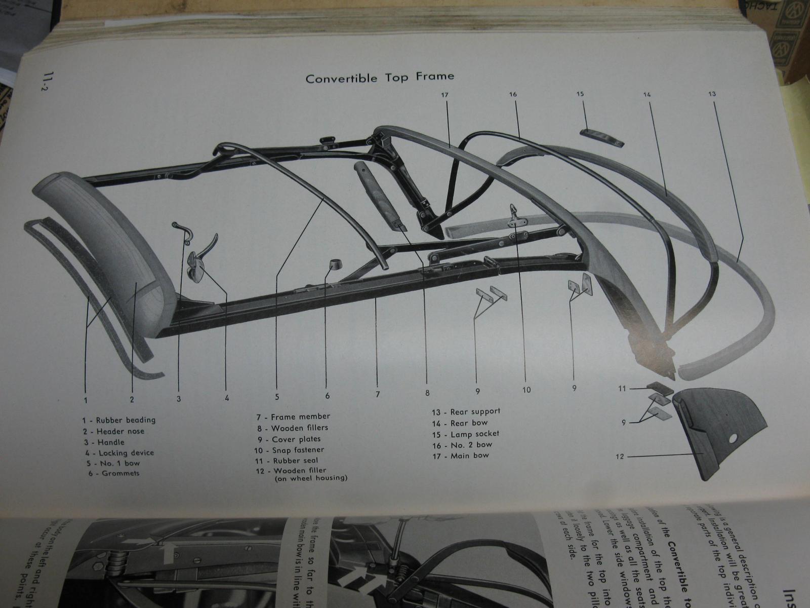

I have two Oval Beetle Kabriolett roof frames deep in storage for an upcoming project, not sure whether these photos from a few years back will help...
The fully restored and black powder-coated frame I bought from Chuck's Convertibles way back in 1995 or so when I originally purchased the project Kabriolett. I'm no so sure that the black frame is "correct" for my 1957 Kabriolett?
I bought the OG paint used frame at the Seattle Vintage VW meet around 1998 or so because it was too good of a deal to pass up. It appears to be correct.
Hopefully these shots might help?

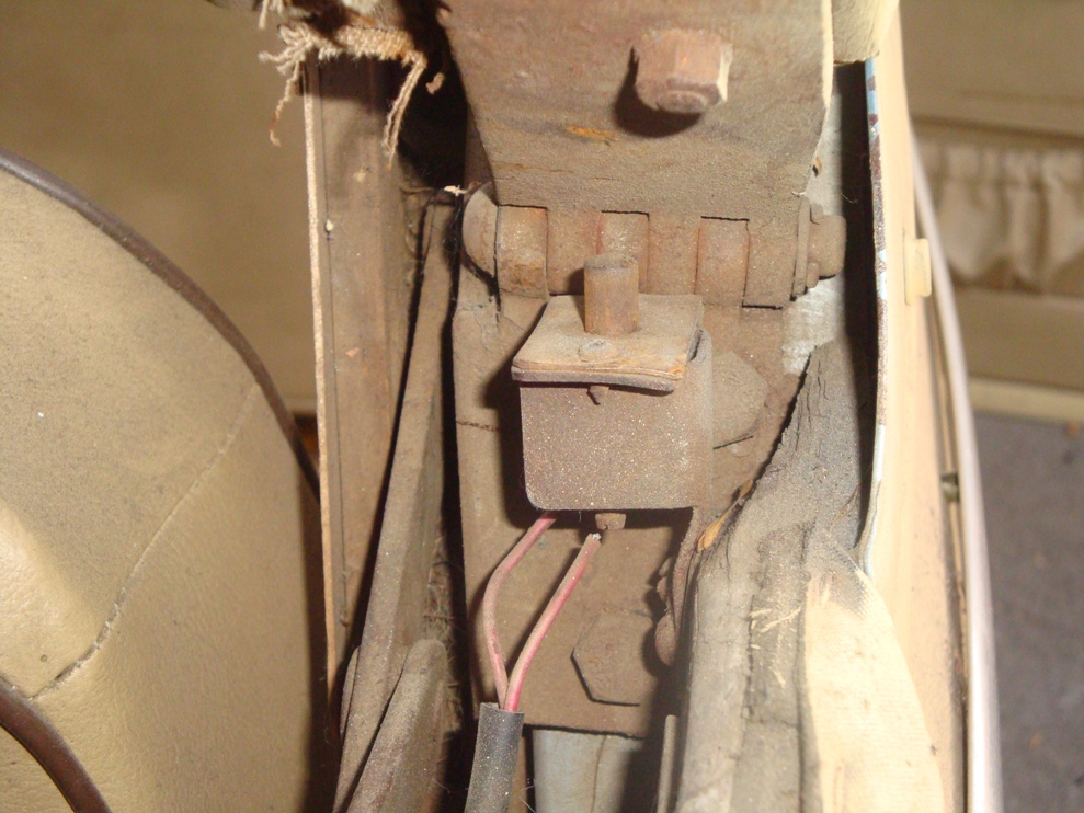

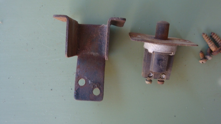

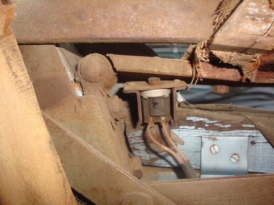

56Cabrio wrote:
soldeli wrote:
1) on a 56' vert, am i supposed to have a switch for the dome light when the top is open like on this pic :
.. My car does not have this switch and i think it's right but want to be sure.
Christophe.
The switch is so when your top is down the light does not go on.
More pics of my switch.
Top open
top down
Bracket & switch.
it's exactly how mine is looking like. unfortunally wires are loose and i would like to know how they are linked to the dome light.
in this picture, two wires for the bracket are coming from the main harness,two from the rear to be linked to the dome light.
now, bracket wiring isn't mentioned in the wiring diagramm. how does it work? suggestions warmly appreciated!
56Cabrio
Joined: May 22, 2008
Posts: 2046
56Cabrio is offline
PostPosted: Mon Jul 01, 2024 11:12 am    Post subject: Re: Official Oval Convertibles thread and Registry Reply with quote
This might help, a post from lovethatconvertible
https://www.thesamba.com/vw/forum/viewtopic.php?t=641862&highlight=convertible+dome+light

PostPosted: Tue Jul 02, 2024 12:30 am    Post subject: Re: Official Oval Convertibles thread and Registry Reply with quote
@56cabrio - tks for clarification! now i must see if red wire to the cutoff bracket is connected to the frontal fuse box and all wires are undamaged.

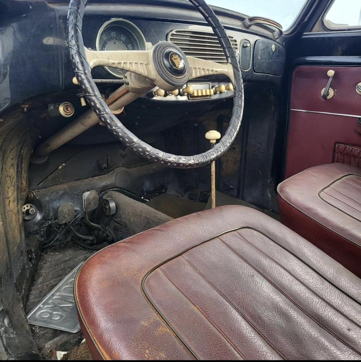

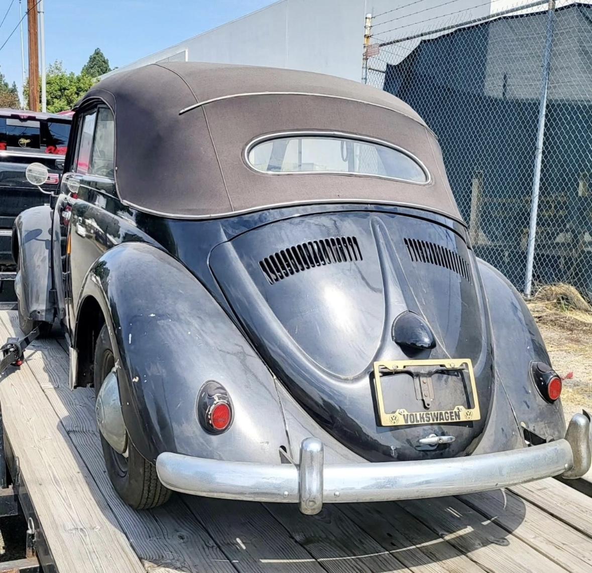

Who else on here tried to reach out to the owner after this ad was posted for a 1954 convertible beetle for $18k. I was one. I guess Kevin Zagar was the lucky one who was able to purchase it. He posted these pictures on Facebook yesterday. Keven said the seller was overwhelmed and had over 100 people reply back to the ad within the first 24 hours. Here is a link to the ad with no pictures.
https://www.thesamba.com/vw/classifieds/detail.php?id=2706115
Here are the pictures Kevin posted online.

Hey Bill,
which book is that page taken from - the one with the break-up of convertible top?
Best,
Marc
BulliBill
Joined: July 09, 2004
Posts: 4754
Location: St Charles, MO
BulliBill is offline
PostPosted: Tue Oct 15, 2024 6:14 am    Post subject: Re: Official Oval Convertibles thread and Registry Reply with quote
Hi Marc,
It is from the VW Service Workshop manual (edition 1952/57) issued to VW dealerships for the Oval era Beetles, in the "Body" section, chapter 11, page 2.
Bill
