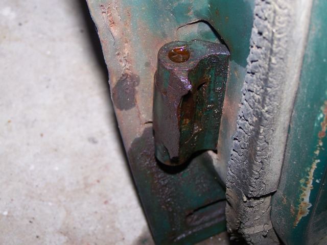

Alright folks... Got another one for ya! I removed my passenger door from my square knowing that the bottom hinge weld was broken, but now what? I have a donor car (68' square) with perfect doors and hinges. Question is how to make the swap with the least amount of headache...
As you can see by the photos... the hinge is pretty much jacked! No idea how the PO did this, but nevertheless... what's done is done. Thanks for any help! [/img]

Use the edge of a grinder and start working at the welds.
Then, you should be able to weld the donor one on.

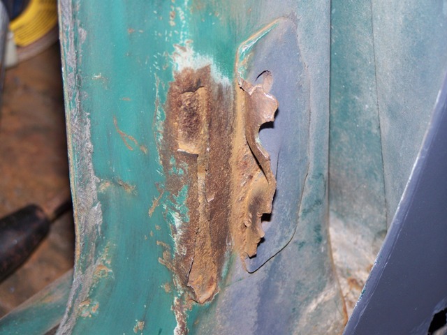

Alright folks... I worked on getting the old hinge off yesterday and this is what I ended up with.
I have no earthly idea how I will get the donor hinge off of the frame without entirely destroying it, seeing as getting this portion of the hinge off was a NIGHTMARE!!!
The only thing I can think of is like BobNotch said, to cut around the hinge and grind down the metal behind the hinge.
If anyone out there has experience with doing this, please let me know before I completely destroy my donor hinge. Thanks...

I would recomend a multi layered sanding disk on an angle grinder. Get one in the 60-80 grit range. It will make short work of grinding the back side of the old hinge off. It also leaves a nice surface to weld to. I just used (2) of these to remove all the metal off the back of the seat brackets I am swapping out from a donor pan. Thet sanding disks are a bit pricey ($10 a pop at HD or Lowes, but Harbor Freight sells them for $5 each).
