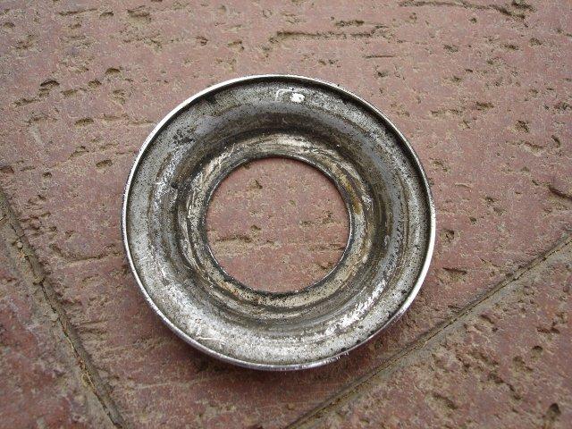

I searched, but couldn't find anything. My early 57' deluxe has the "stepped" escushions on the front doors. Are the cargo door escushions supposed to be that early style as well- or the flat chromed ones? Thanks-
Posts: 71896
PostPosted: Wed Feb 05, 2014 9:30 am    Post subject: Reply with quote
Stepped but chrome.
