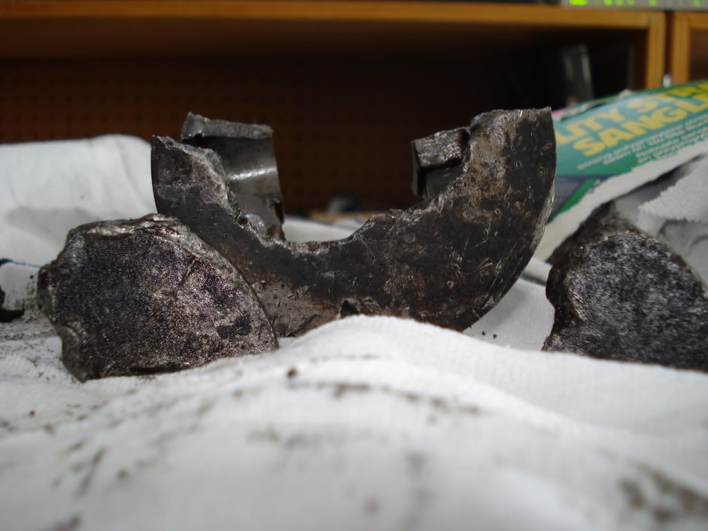

Not as much carnage as we were expecting, many parts are salvageable. Here is the culprit, say hello to Piston #2 or what remains of him, I'm going to piece this back together with JB weld and and keep it in the car as a reminder to take every "funny" noise very seriously:

SWEET JESUS! I think I just died inside a little! That sucks man, my condolences!

That's great to know the piston "fell apart" but why? Pistons don't often do this for no reason. Something got in there and probably started it by bashing the top of the piston is and it went downhill from these.
Keep looking for the cause. Could be a nut dropped in the carb during a repair or any manner of things. How are the valves on that cylinder?

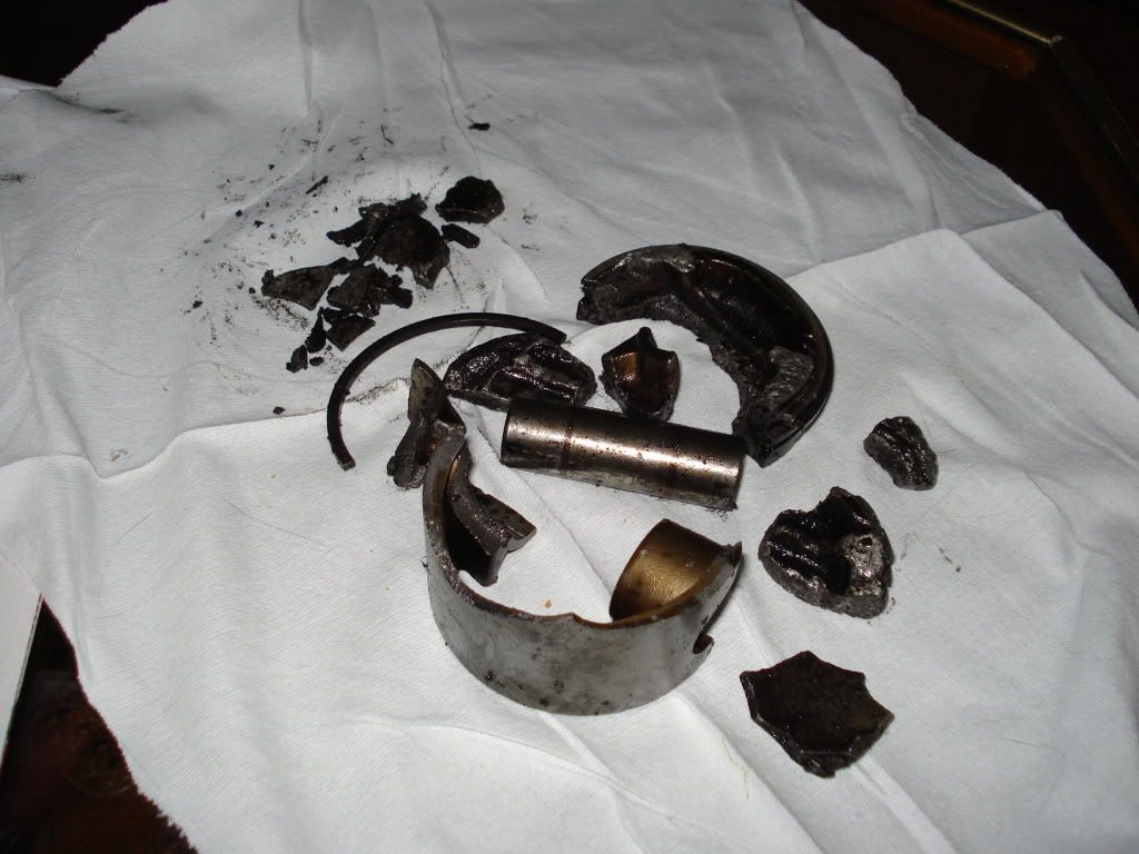

No idea what caused it but we are pulling down the whole motor to find out and changing out many worn things. The top of what remains of the piston has many dings in addition to the grand finale:

Motor is almost reassembled now, whatever happened in there took every other piston with it (one exploded, 2 cracked down the side, one had a giant chip out of its skirt). Mechanic (Old time VW Guy, knows his stuff) says hes never seen anything like it, also said that whoever rebuilt the engine before torqued everything to the maximum possible limit Sad
Good news is, cylinders and heads are all fine, only thing I had to replace were pistons, which luckily he had in his shop. Replacing all the other little now-easy-to-get-at things as well.

I am just amazed that it still limped home........... Look at that mess.......

Hate to be the bearer of bad news, but you are wasting your time and money!
If the pictures you posted are from your engine, it needs much more then just pistons.
How can you break the rings and not score the cylinders? And how much metal went through the oiling system? And how the heck did it not damage the case? And why would you think about reusing a case that has been over torqued? And how did this not damage the heads?
Just because your VW guy has built a lot of engines, dosn't mean he knows what he is doing. This sort of reminds me of the automatic transmission commercial where the guy says the transmission shop is good because they fixed his transmission 19 times.
You have a lot of broken pieces, and a lot of metal went through that engine. You need to think about that before you slap another set of mismatched pistons on this thing and try to get on down the road.
