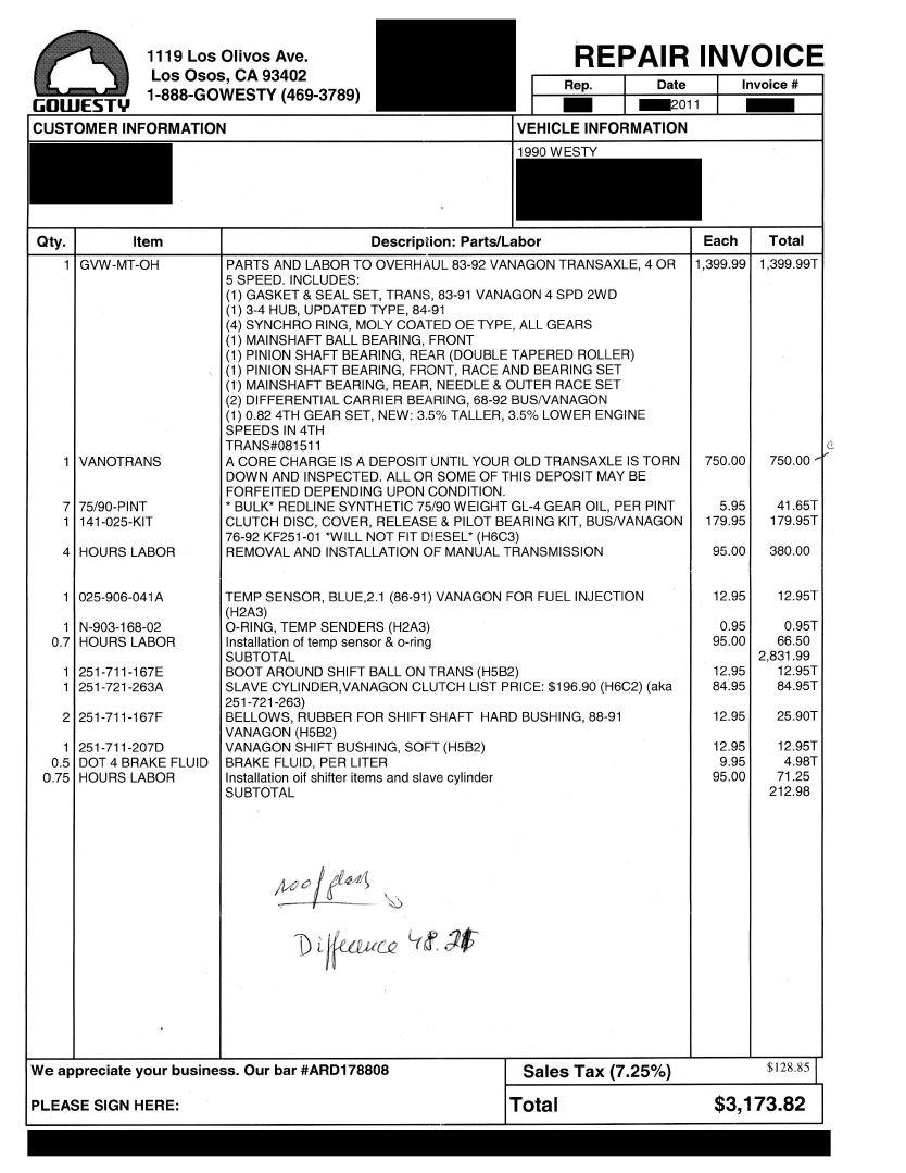

Attached at the bottom is a screen grab of a GW invoice for rebuilding the TA in 2011. Of particular note is 4th is now "taller" than the OEM gear. With the GW 2.2 motor and GW EFI, the top GPS speed on the flat, and loaded for travel is 83 (woohoo).
Until I saw the invoice, I had no idea the ratios weren't stock. I now get why the engine seems to be a little ...ah... "thin" in 4th. Any appreciable incline or significant headwind is enough need serious "gear jammin' action" to keep rolling. My inclination is to return to the standard ratio.
FWIW, whoever did the job at GW stepped on his necktie. Specifically, note the invoice shows the clutch was replaced. A little over a year ago (about 10 years later), I had the rear crank seal replaced. When the TA was pulled, the flywheel was dished to the point where the clutch point of contact was a band on the order of 1 1/2" at the outer edge of the flywheel. There was zero wear (original scuff marks still visible) I replaced the clutch and flywheel, of course.
At this point, I'm down to deciding whether to replace the TA outright, or have it rebuilt. I tried locating Matt Streedle, without success. Does anyone have for-sure contact info for him?

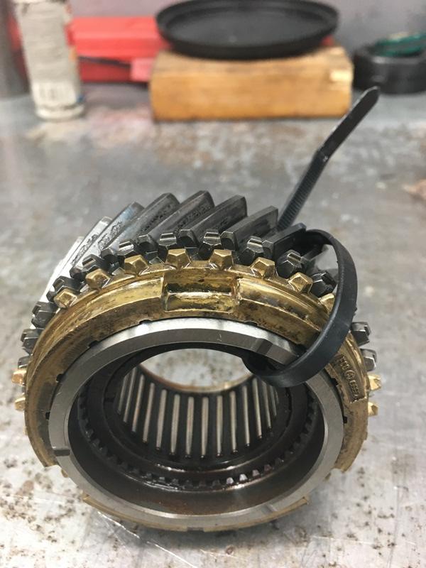

This is a picture of my Weddle 4th gear. Maybe 50,000 miles. Towards the end it was very noisy. Weddle said it was expected wear and no credit to a replacement. I’m now running a GT square cut 4th. Hoping the load and wear on the inner main bearing inner race is reduced. Beautiful looking part. I’ll tear it back down at 60k miles for an inspection.

wow. those gear faces are chowdered up bad for 50k miles. looks like shallow or no hardening. i love the whine of a straight cut gear but maybe not in the van. how is it to you in the van?

The sound is noticeable but not a deal breaker if it actually improves longevity. Time will tell. You don't really hear it at highway speeds. Enough other noise that it blends in. On surface streets, I'm usually in 3rd which is stock. If I select 4th on slower roads, you can hear the gear enough that my non mechanical wife asked what that noise is.
The Weddle gear noise was more pronounced because the gear set would get quiet when the load came off and on, most noticed going down a slight highway grade with the cruise control trying to maintain a speed. So it sounded like something was wrong, which it was.
The straight cut gear on and off load, the sound does not vary like it did with the helical gear prior. Eventually you don't even notice it. Usually when I haven't driven the van in a while. For my application, I would not utilize a straight cut 3rd. I spend too much time in 3rd and 3rd doesn't have the same issues 4th would.
If you are going down this route, you may want to consider one of the new GT billet gear carriers. I rebuilt my transmission during the pandemic and the carrier was not available at the time. If it had been I would have installed one. I did spend the money to add a Peloquin since I sold our syncro. Adding the Peloquin for the most part on a rebuild like it sounds you need is not really additional labor. Didn't catch if your's was a syncro or not.
The 091/1 is a fairly straightforward transmission this is relatively easy to work on for someone with average skills. It does require a few special tools that are available for less than it costs just in shipping back and forth cross country. The gear set above was from a reputable pro built transmission specifically for a TDI powered van. There was no provision beyond stock for securing the main shaft bearing. So decided I could better control quality if I did the work. Parts availability was difficult back then. I have not used Matt Steedle, but have talked with him on the phone and seemed very knowledgable. I was looking for factory 3/4 slider that does not come with the hub. We also sent an owner to him and didn't hear a anything negative.
