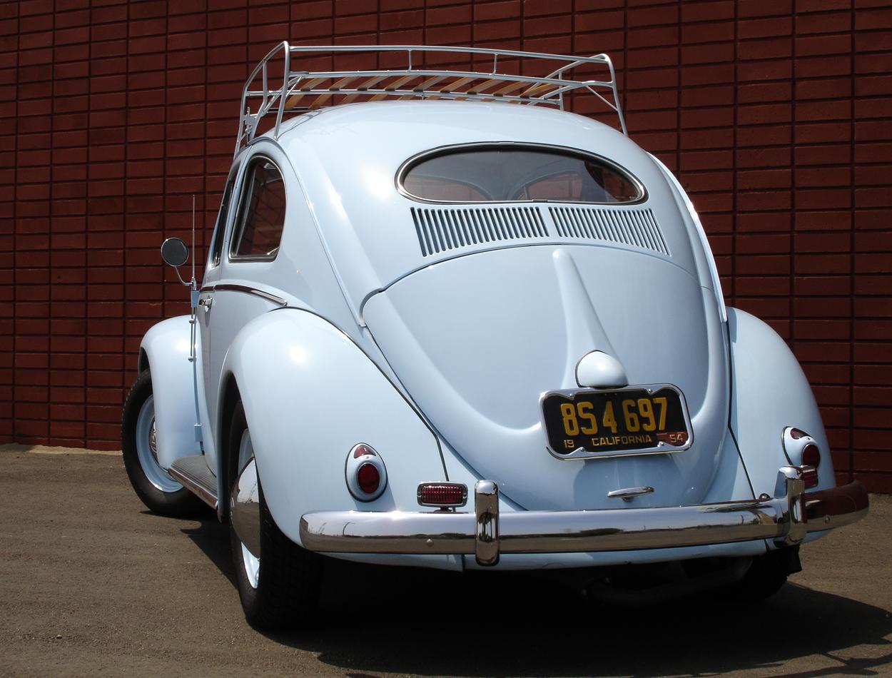

I have seen several "late" 55s (bullets, snowflakes) where the tail lights are very low, almost the same as hearts or eggs where the bottom of the taillight is at the same level as the rear bumper. What confuses me is there were no bumper guards (american) so maybe it is an earlier 55 with the turn signal option prior to it becoming standard? Somewhere I read progressive refinements lists the "snowflake" position is higher on the fender for 56 production year. Is this correct?
So is this fender the rarest of all if real?

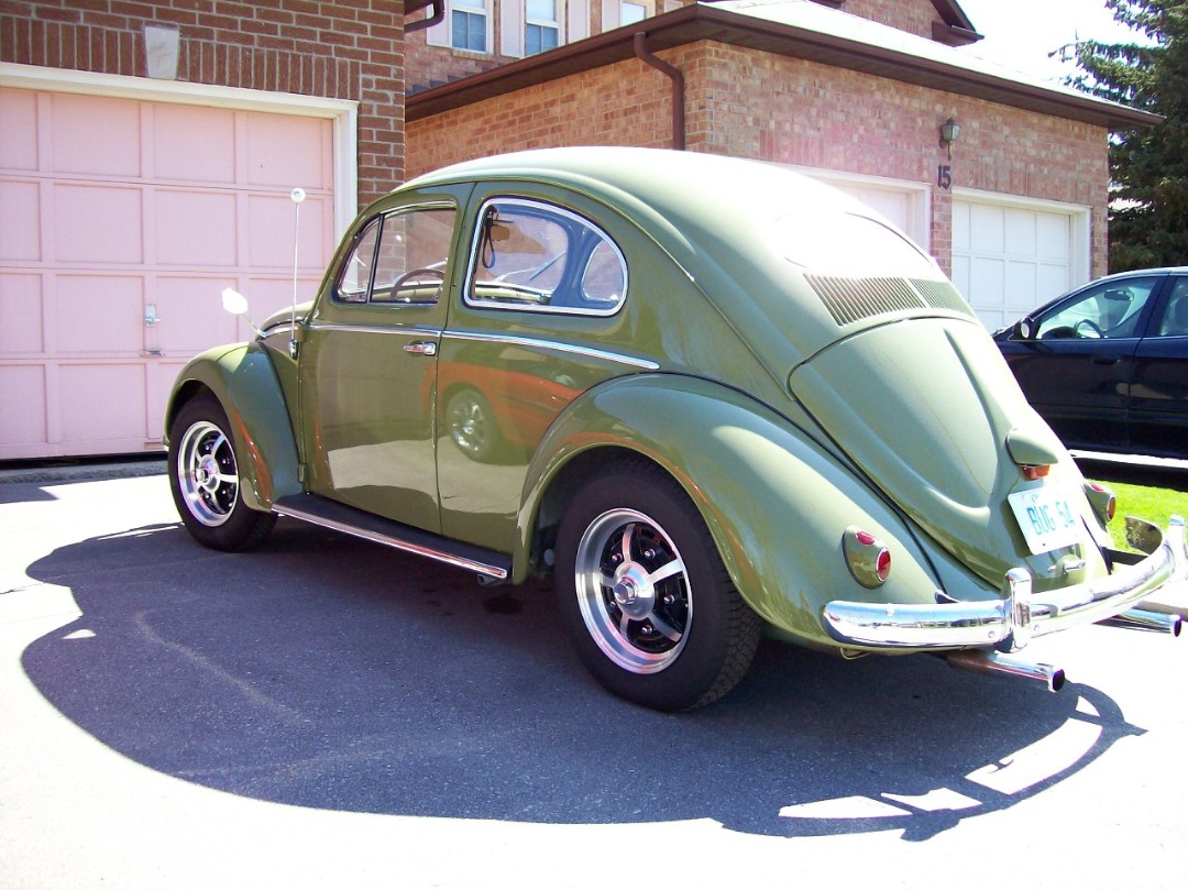

how many of those rear fenders are original "dimple" type. The first two look like standard 55-61 export light placement. Are the second two original placement or repro fender?
The ones I have seen are euro bumper so the rear lights are LOWER than the first two but are not obstructed by the export overiders.
A few years back in HVWs mag there was a 60 euro vert in rock gray with the same Lower snowflake position. Is this just a euro thing?
Here are some pics from the gallery of heart/egg placement, imagine the bottom of the heart is the same as the bottom of the snowflake housing. The ones Ive see are closest to the egg placement

The lights were moved up 60mm up for 56. So a good estimate of the early position would be 60mm lower than indicated on this chart.
