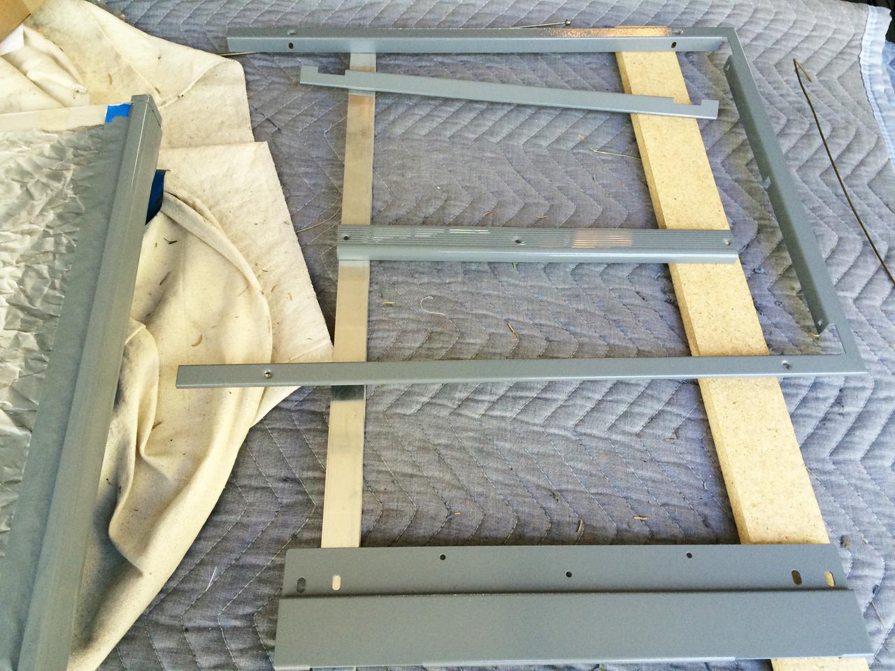

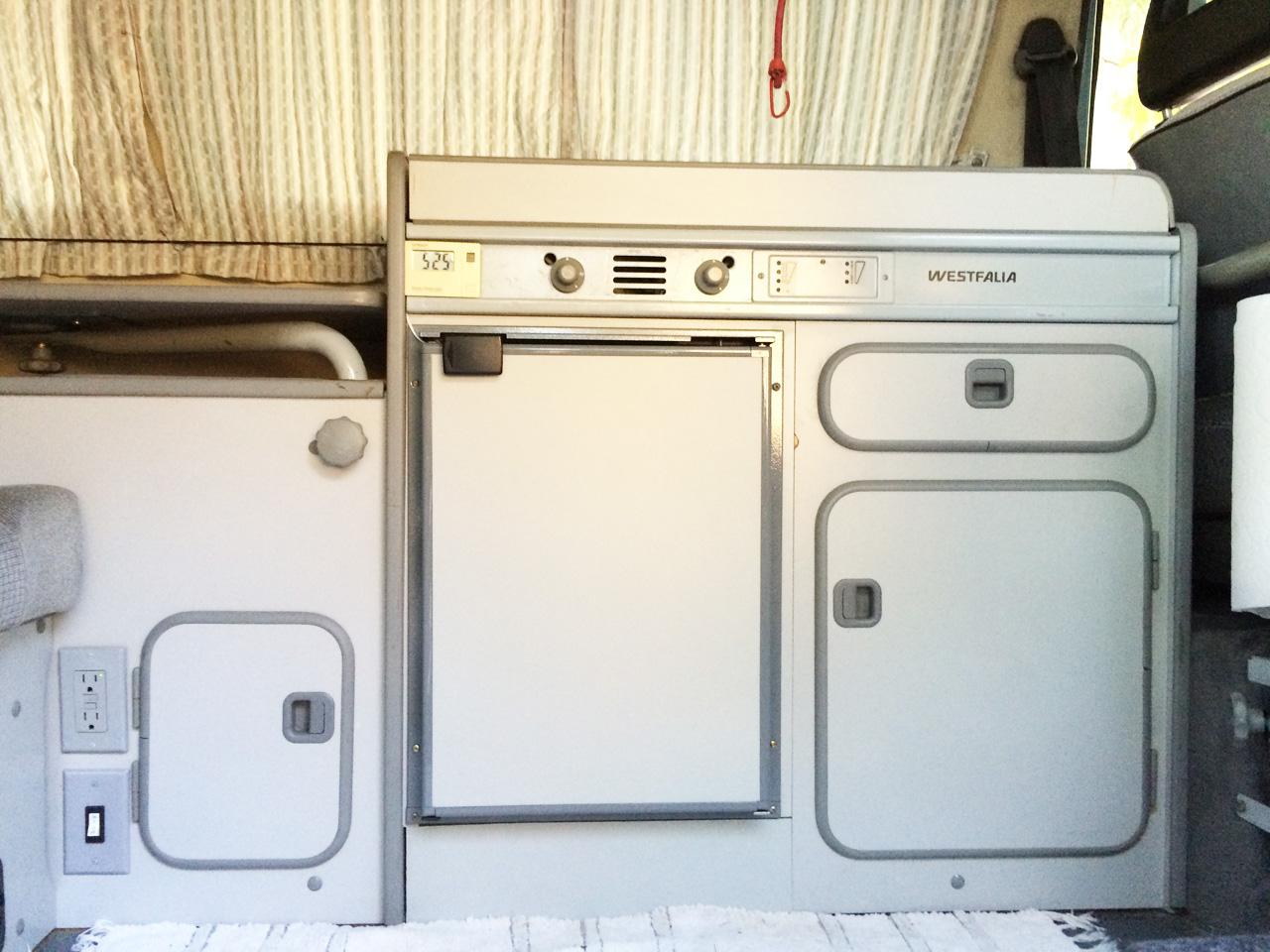

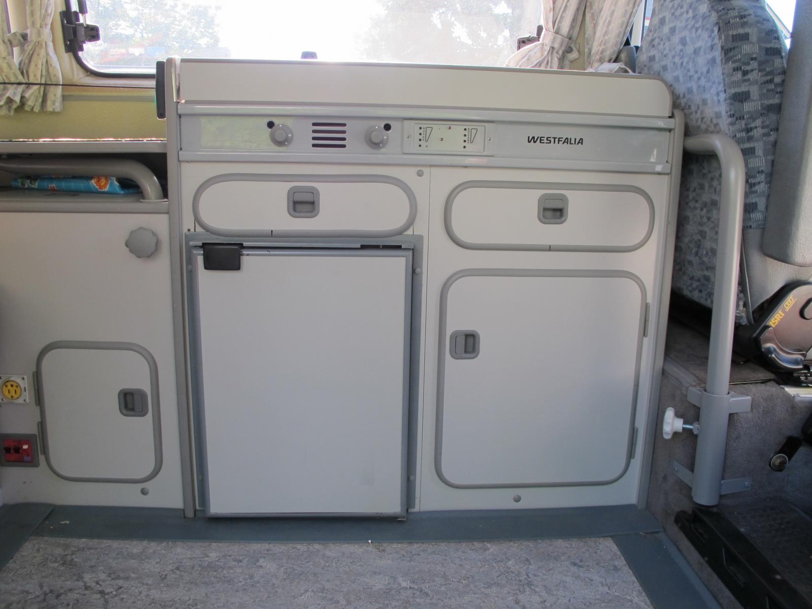

Nothing new here . . . . thanks to all who preceded me on this thread.
50 shades of grey interior . . . original laminate and vinyl trim, Stove plate, electrical box plates, Fridge trim, GoWesty laminate, floor, upholstery, carpet, curtains . . .

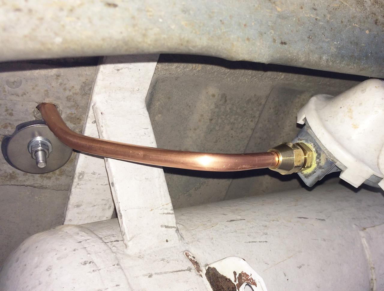

VitriFrigo CS51 AC/12V. Trim painted grey with Rustoleum, propane line replaced after removing Tee on regulator. Fridge wired to Blue Seas fuse box behind drivers seat (12V) and relocated (A/C) outlet. Will eventually add drawer beneath fridge like others have done.
Finished installation (except for future drawer):
Complete install notes/photos:https://picasaweb.google.com/13VelosdeRemi/FridgeR...eplacement
Painting the trim:
New propane line:

PostPosted: Mon Feb 16, 2015 12:09 pm    Post subject: Nice work Reply with quote
What exact color of Rustoleum paint did you use to match the grey trim?

PostPosted: Mon Feb 16, 2015 9:37 pm    Post subject: Re: Nice work Reply with quote
7786 Smoke Grey . . . got it at Lowe's

I hope you'll add a grommet to the entry point in the floor for the propane line if you haven't already. Did you use any adhesion coat for the gray paint? I doubt regular enamel is going to stay adhered to bare plastic for long. Looks good otherwise!

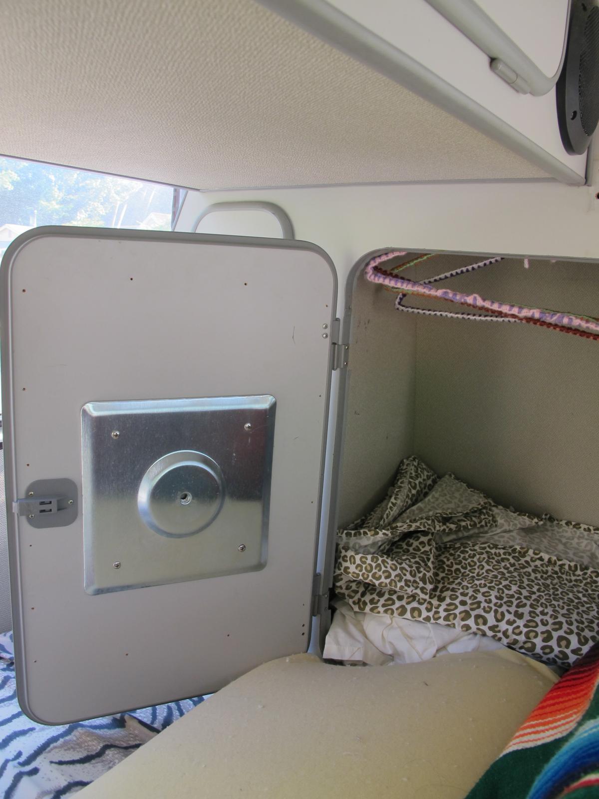

Here's some shots of my refer project. First off thanks to Jay, thatvwbusguy, for answering all of my stupid questions.
Here's a shot of the refer install.
I used the recommended Rustoleum Smoke Grey paint #7786 and while it looks good, it is definitely darker than the interior grey. Maybe because I have a Euro spec Joker, or there was variation in the paint, but the particular rattle can I used is darker.
I went for a drawer above the refer. I used the Go Westy laminate for the new refer door panel, a great match.
I got edging from Gunzl. I ordered both kinds they offer. The wider one (17mm plate height) would have done a better job of covering the door edge, but is way too light in color. The narrower one (13 mm plate height) is perfect on color and only a bit too narrow. You only notice the exposed door (or drawer) edging when the door/drawer is open & you're looking straight down the edge.
As far as the refer itself goes. I ordered the Vitrifrigo for the European quality. Maybe the q.c. guys were out having an espresso when mine rolled down the line but not only is the handle rather flimsy, but one screw hole was completely stripped. That aside it does cool down nice. Only tested it pre solar panel, but got 3 days off the new aux battery.
Here's the original refer door getting reused as a closet door. I made a door for my '81 and liked having it open in this direction. It does mean you need to relocate the bottom hinge, but that's not too hard to do. If you do this use the old refer front as a template and be sure you hold back from the marked edge enough when drilling the corners with your 4" hole saw.
The door does double duty as the front table. A nifty mod that I shamelessly stole from another Sambanista. Feel free to do the same from me.
[/img]

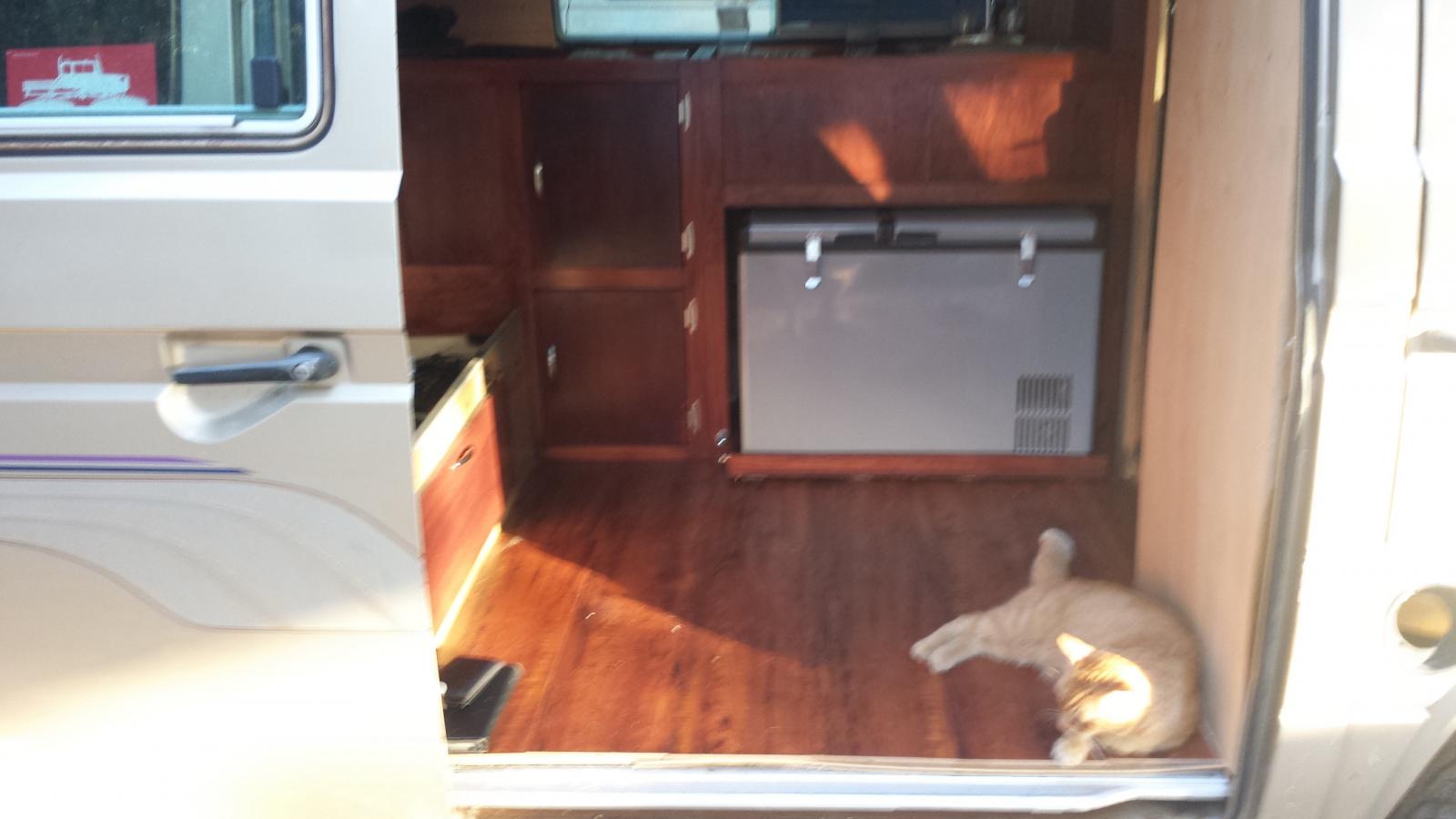

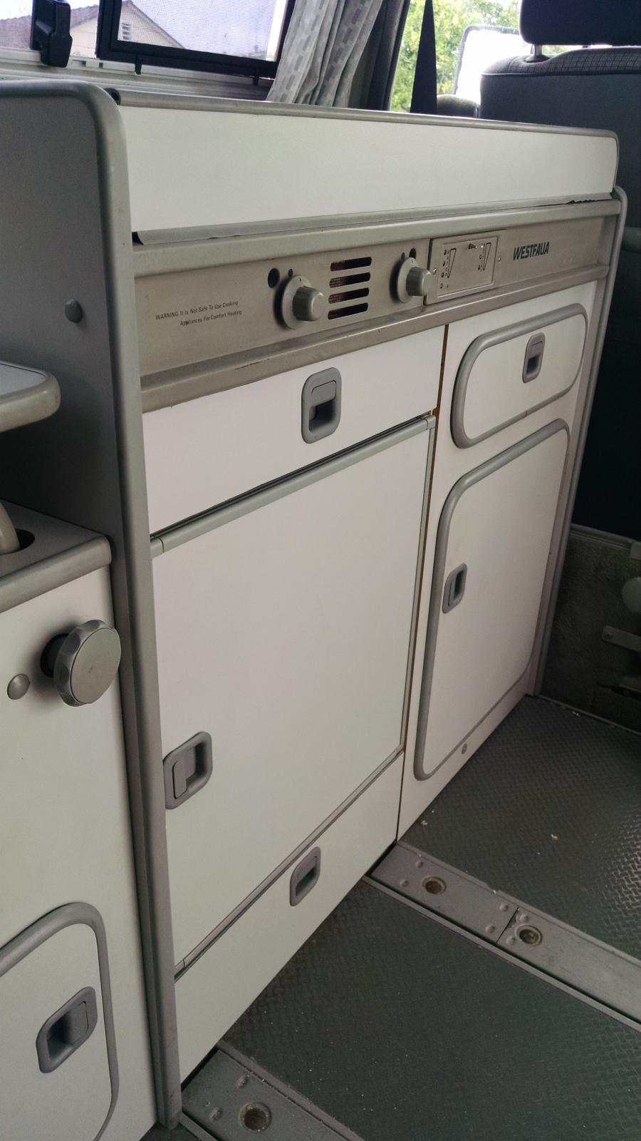

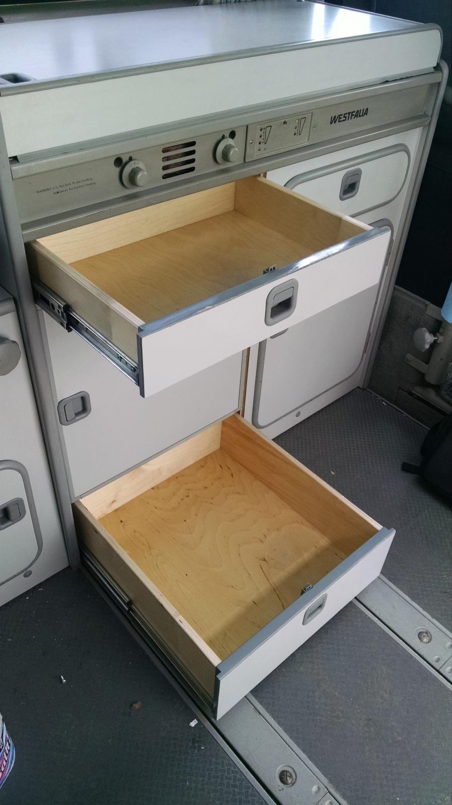

Here's mine, it's not a replacement, but a full custom build, the fridge has separate freezer and fridge compartments. I built it on a sliding shelf, so it can be pulled out and then push back out of the way.
More pics of my build can be found here..
https://imgur.com/a/XWQWo

PostPosted: Thu Jul 02, 2015 3:16 pm    Post subject: Reply with quote
@David...
what fridge do you have there and what size?
thanks
DAV!D
Joined: September 10, 2013
Posts: 980
Location: EL CAMINO
DAV!D is offline
PostPosted: Thu Jul 02, 2015 4:12 pm    Post subject: Reply with quote
0to60in6min wrote:
@David...
thanks
It's a Whynter dual zone it's 62qts. I picked mine up from Amazon, here is a link to the model I have.
They have smaller ones, but this was the only one with dual zone. The cool thing is you can set both sides as fridge or freezer in any combination you want.
I personally love it, but the only draw back is the power plug goes into the right side toward the front. Due to the way I built my cabinets, the plug just barely clears and my first week with it, I accidentally knocked the plug out and had to toss everything inside because I didn't notice it for almost a full day. It's awesome to have ice cream on your trip or be able to freeze meats and so on while traveling.
Eventually I'm gonna get one of those Oven/top burner set ups for my van and I'll be able to cook just about anything I want after that. Like being in a home kitchen just smaller.
