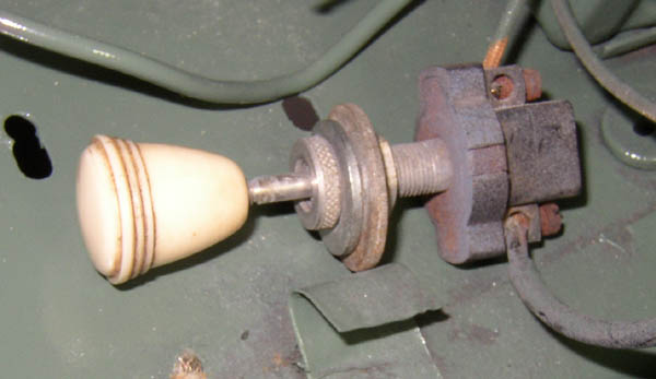

For my Zwitter, is this my headlight or wiper switch or none of the above?
I need to get a good book about my car! Thanks
Brian Waz

Looks like a wiper switch...

Get the Bentley manual, it covers your car pretty good

It is definitely wiper.

it pretty well shows, but I should have mentioned it was two wires. Now what's the headlight switch like?

the headlight switch is going to have many many wires going to it, like 5 or so, I have to vote for "none of the above" for that switch in your picture, its clearly got a not very VW like knurled & threaded collar for mounting, most likely an accessory switch for fog lights or something, I'm thinking even on a zwitter the wiper switch was mounted in the conventional manner with a propper smooth collar behind the knob and a screw into the bottom of the dash from a bracket on the switch

Yeah, it's an acesory switch - I have a similar one on my car, wired by myself for the fog lights. Even more, even if the ivory button looks like a normal dashboard ivory button - the thread for the ivory button is thinner than the thread on standard dash buttons ( such as headlight switch, found later stock beetles )/

X2
I agree. It's an accessory switch.

looks like a this http://www.thesamba.com/vw/classifieds/detail.php?id=690626 with a regular bug knob.

There were 2 terminal (and 3) wiper switches for single speed wipers. I have some of each, NOS, in the bag with VW dealer part numbers. But I agree that it could also be an aftermarket accessory switch.
