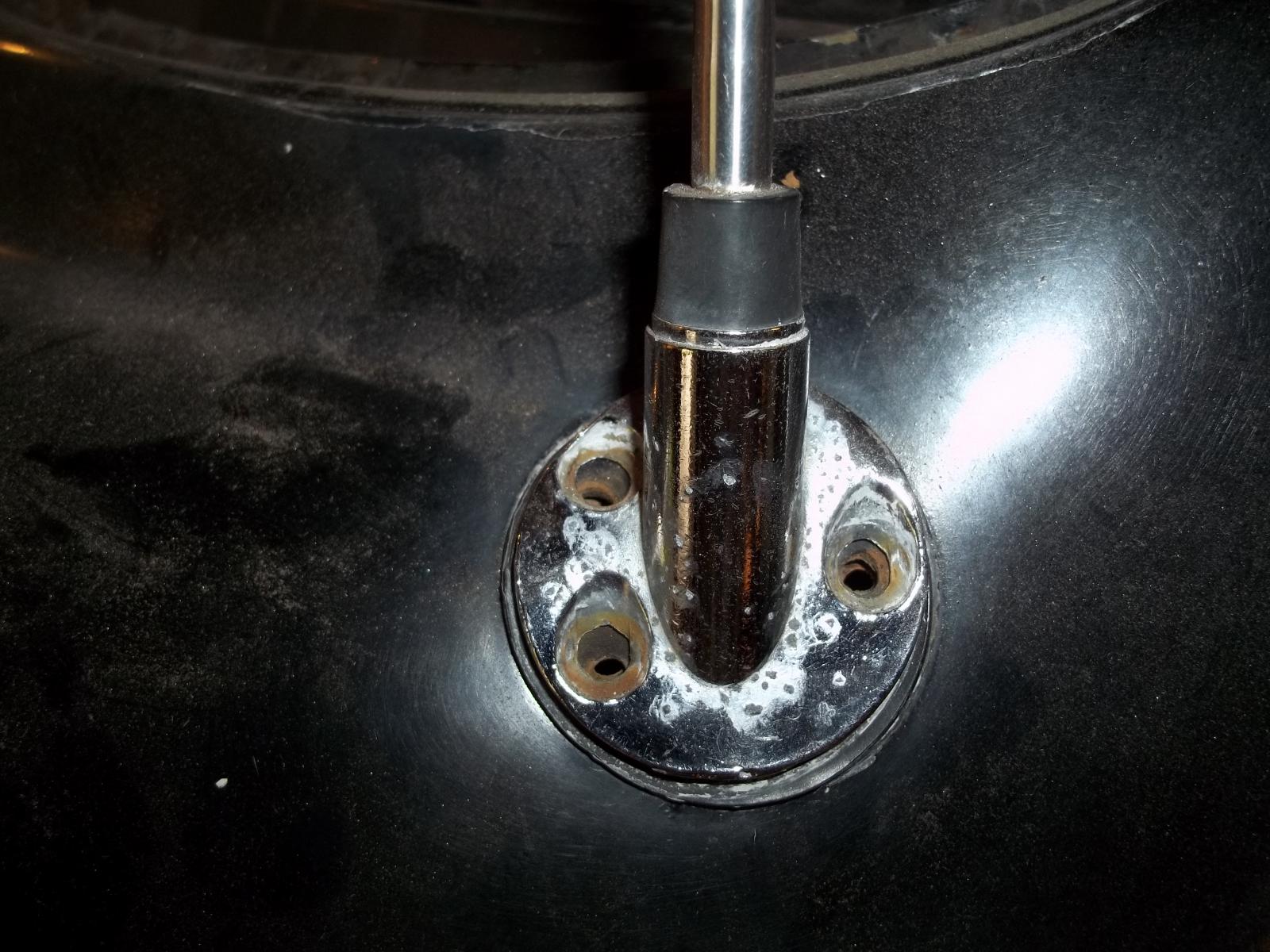

Here is a pic of the antenna on my 74 SB. I want to replace it but I can't find one like it. Is this a stock antenna?

On my 74 the hole is oval, my antenna base is different than yours , so id. Say youres is aftermarket.

Stock ones to dot have screw holes... There is a nut under the body.

My '74 Super had the exact same antenna. There was a cover piece that covered the screws so they are not visible. I could not find a replacement, so I welded the screw holes and changed it out to the style that is available.

I never found a replacement that had the 3 screws. I ended up welding the holes shut and went with a manual retractable antenna.

My 1977 Super Beetle Convertible has the same antenna. I think they changed to this style in the last couple of years they imported Beetles in to the states.

I believe that is a Motorola antenna that some vw dealers used . You might try google
