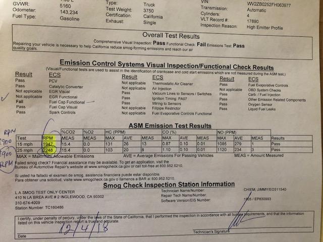

Please post a photo of the printed smog test result from the test station.

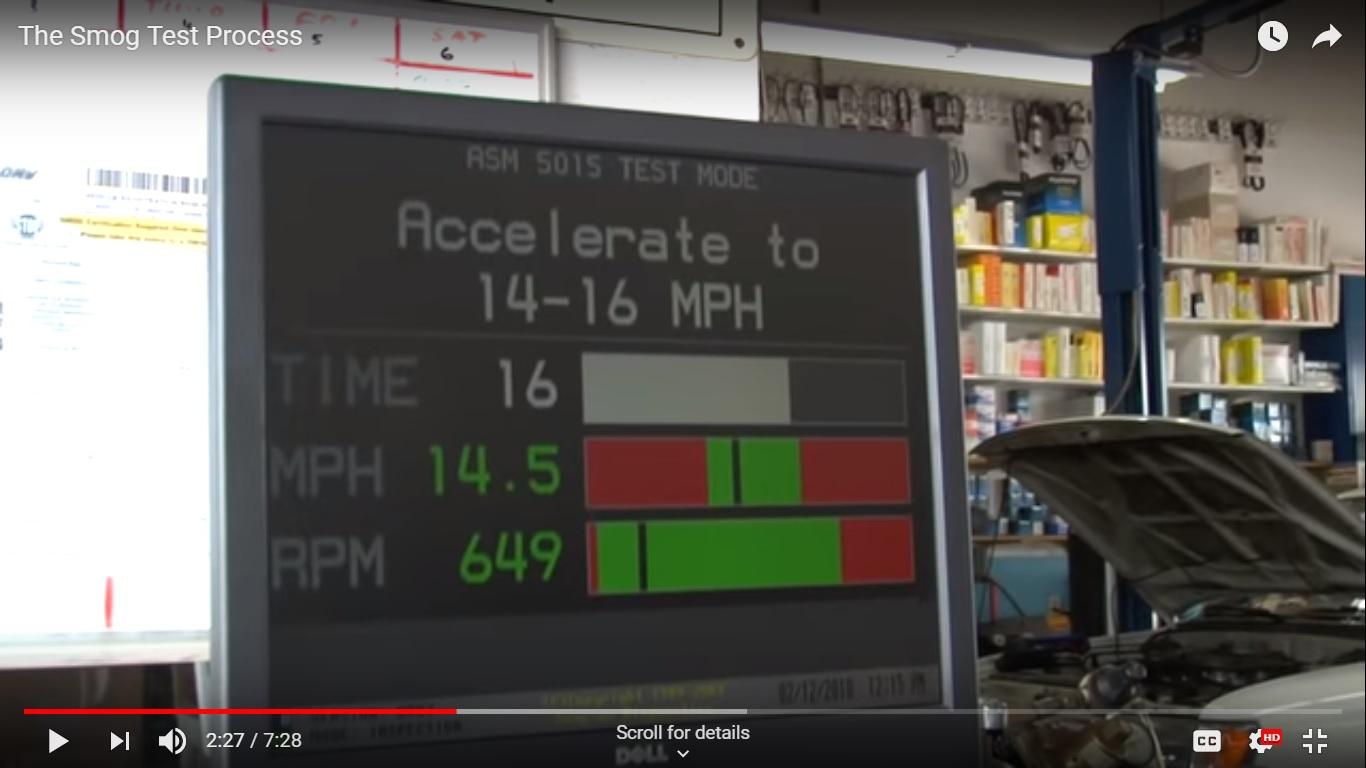

PostPosted: Wed Dec 05, 2018 11:43 am    Post subject: Re: Smog Fail, engine RPM too high at 25mph. Any ideas on a fix? Reply with quote
Your van is performing out of range - note the limited MPH & RPM green band
Did they complete the test & send it off to the state? If so, did it give you a PASS or FAIL?
The reason I'm asking is because this car failed the 25 MPH test as it lost the RPM pickup signal, but it ulimatley passed.
Take a look at 2:35

Lets see this report.

PostPosted: Wed Dec 05, 2018 12:20 pm    Post subject: Re: Smog Fail, engine RPM too high at 25mph. Any ideas on a fix? Reply with quote
Here's the report.
High RPM On both speeds. I don't think he had the right gas cap either.
