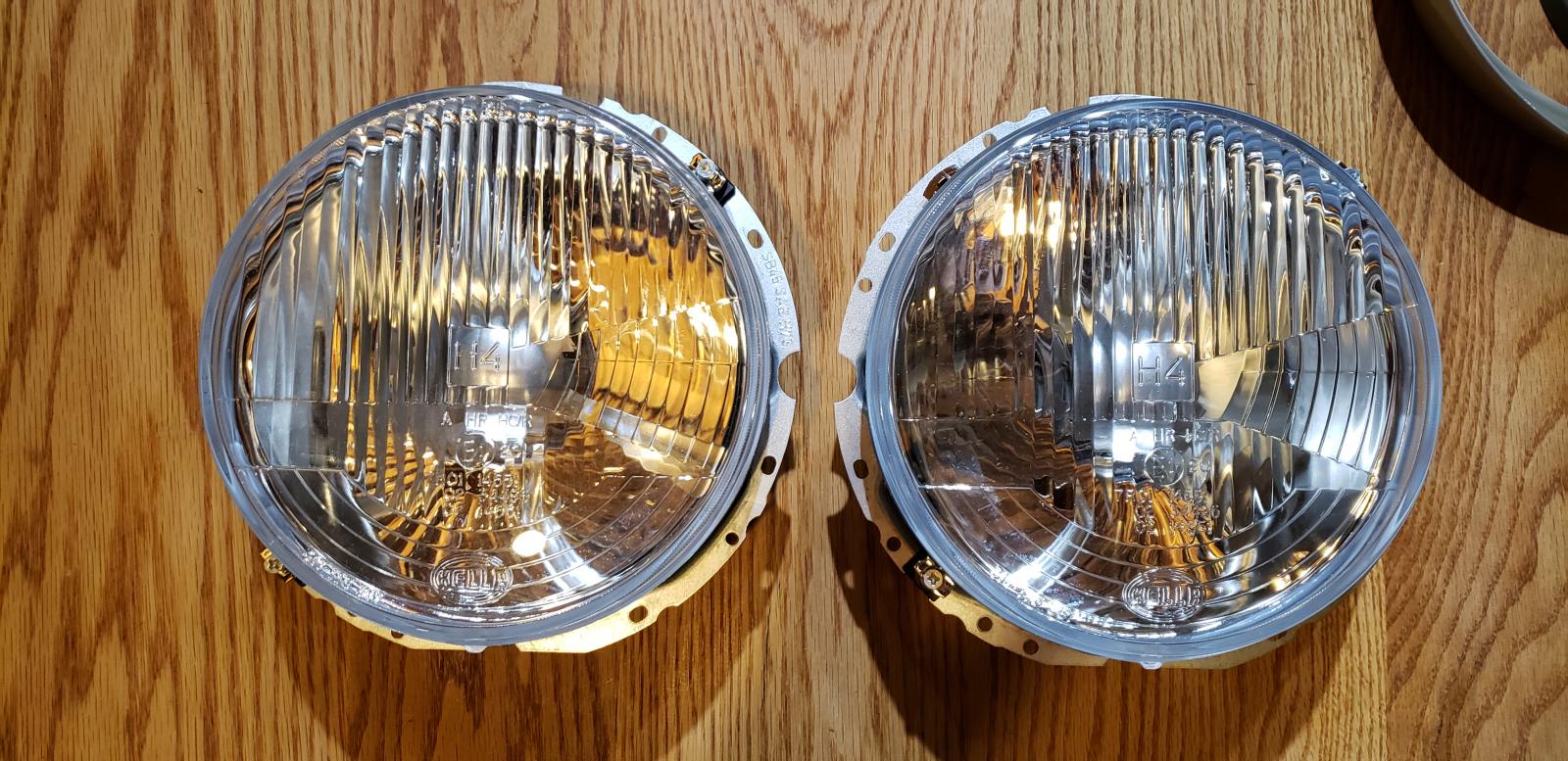

If you order the Hella Euro versions, they have a small second bulb, (for Euro City lights), they can be wired as daytime running lights. I have them in my '96 Mexican Beetle.
This looks like a lens for a RHD car.
Yes, the lens is for RHD cars, it's an old pic from my car, I posted that one as it shows the City light quite nicely.
