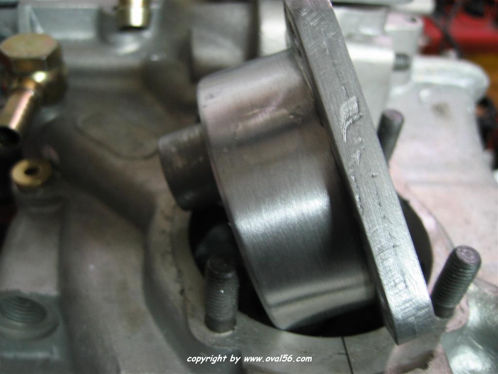

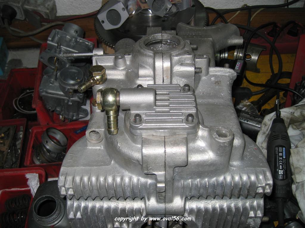

oval56
Joined: July 21, 2003
Posts: 1309
Location: oktoberfest maintown
oval56 is offline
PostPosted: Thu Aug 06, 2009 10:54 pm    Post subject: Reply with quote
jes is correckt, the centers of 8mm studs ar not the same as 6mm studs for the oilpumps..
i have built my first engine, with useing 8mm studs, but i have to modifie my oilpump to get it mounted...

36hplandspeedracer
Joined: January 30, 2006
Posts: 847
Location: Ivins, Utah
36hplandspeedracer is offline
PostPosted: Thu Aug 06, 2009 11:03 pm    Post subject: Reply with quote
If you use 6mm studs or bolts, no modifications will be required!

oval56
Posts: 1309
oval56 is offline
PostPosted: Thu Aug 06, 2009 11:18 pm    Post subject: Reply with quote
Burly
sure, that was the result of my experience after the first conversion also Very Happy Exclamation Idea

Art Thraen
Joined: January 19, 2004
Posts: 478
Location: Utah
Art Thraen is offline
PostPosted: Sat Aug 08, 2009 9:17 am    Post subject: Reply with quote
This is a pic of Justins land speed engine that is full flow'd,, http://blackline57.com
Works great. But the fittings are not the same as a 1600, they are smaller at the return line..
