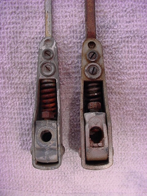

Wiper bases:
Buses use a wiper base with a circular hole.
Example (on left here):

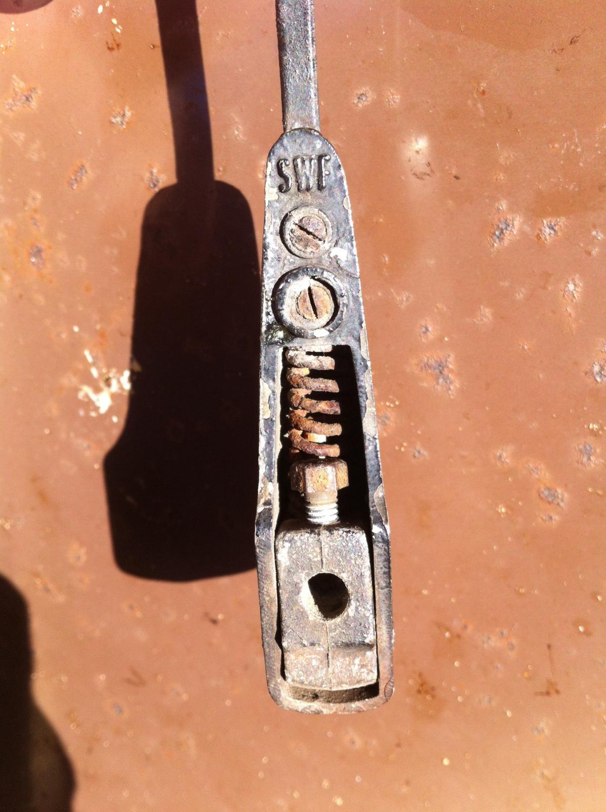

I have seen both VW-logo'd and SWF logo'd bases.
For reference, a low mileage '54 Deluxe thought to be 100% original has wiper bases with SWF logos. In addition a '52 Bus believe to have the original wiper bases also had these wiper bases.
Example:
Other logos
The VW on the left is sunken down vs. the 2nd VW emblem, which is level with the body of the wiper base.

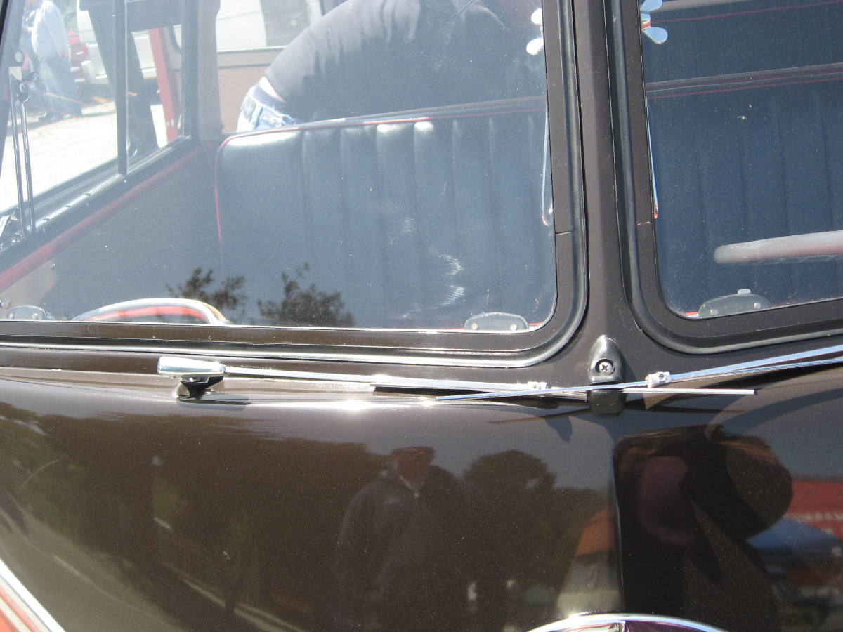

PostPosted: Thu Aug 06, 2009 6:27 am    Post subject: Reply with quote
These are the wiper arms on my 52 kombi:

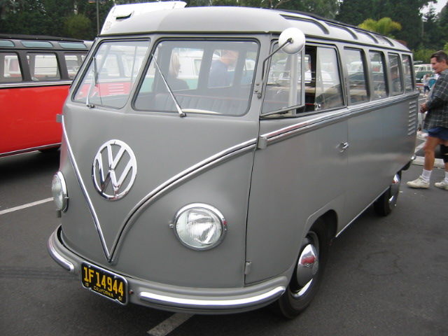

Posts: 71497
PostPosted: Wed Jun 01, 2011 11:07 am    Post subject: Reply with quote
It seems like 54-55 Standards used Black. 53-down are chrome/polished like Deluxes. For reference, the '55 parts book says both Standards and Deluxes had the aluminum-colored ones though.
Canadian photo
Also the Sunroof Standard in Germany

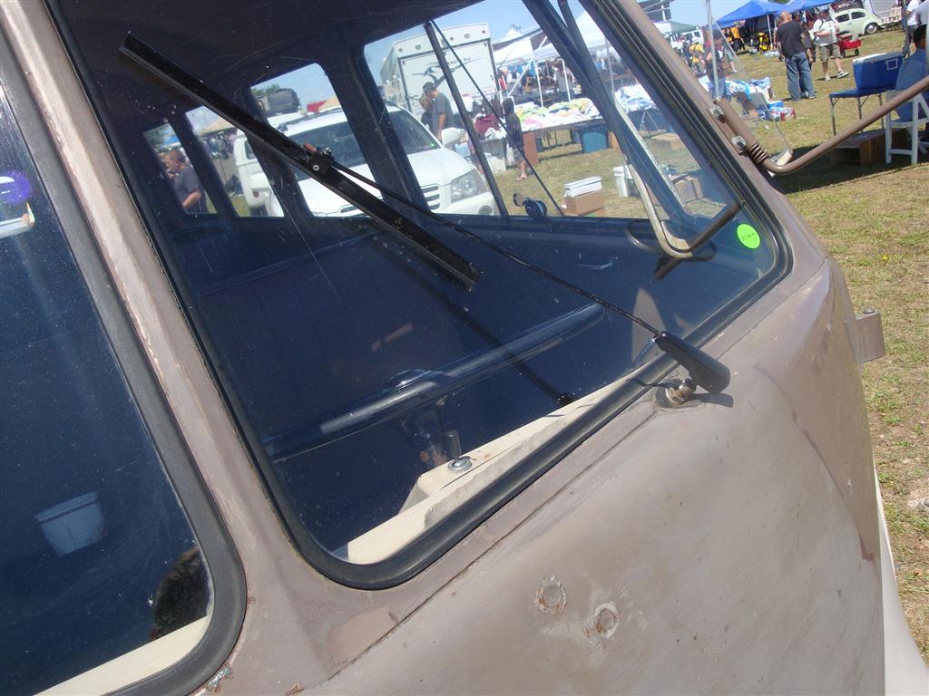

Posts: 71497
PostPosted: Wed Jun 01, 2011 11:48 am    Post subject: Reply with quote
From a '52 brochure (Black parts)
