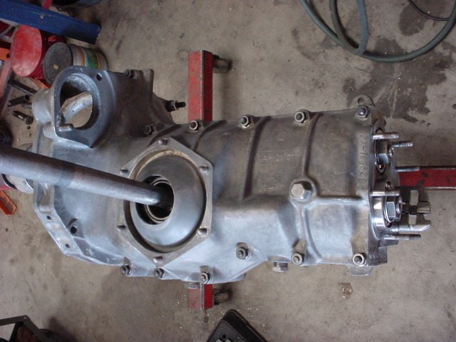

Easiest way to tell a crash case BTW, is the lack of ribs on the side, and the upward facing oil fill cap. Crash case trannies were used past Oct '52 in non-US Beetles BTW. I have heard of standards with CC trannies into the early 60s.

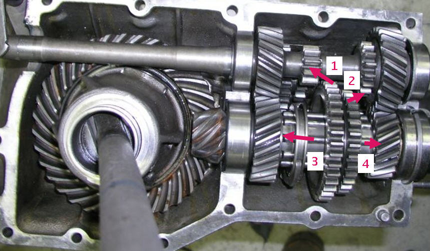

Here you can see the differences for gear change between 1-2 and 3-4. Problematic 1-2 has straight cogwheels need to go each other. When 3-4 has round head pins in gears which change much easier.
Now there's an explanation Very Happy
Yeah, that is pretty cool. Thanks for the pic Mika!!
