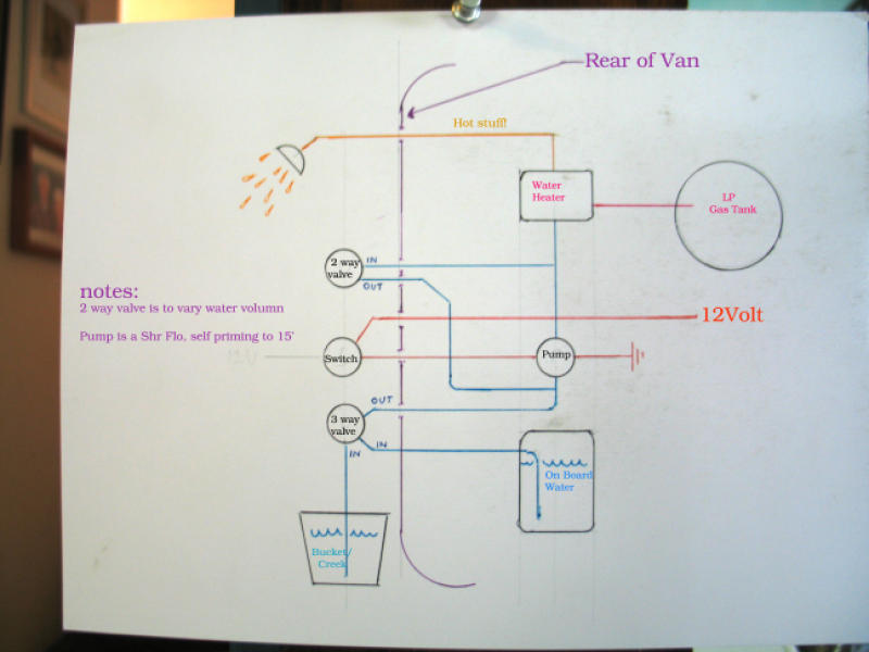

Bill Langan has a system he built that puts the shower hose out the back of the rear cabinet, so he has to open his rear hatch to shower.. and he has a shower head he can clip to the rear hatch..
He posted photos of his system plans here
http://groups.yahoo.com/group/Syncro/photos/album/...mp;dir=asc
and I am attaching his photos to this post.
My suggestion is to share your plans with us for free, and then I do think you might be able to sell a kit to some of us who do not enjoy looking for parts all over town.

Johnathon and tencentlife: Good suggestions. I saw the water heater that Johnathon posted. If they operate the heater in the closet, it is very dangerous. The unit is intended to be used outdoors only. I will post some pictures of my unit soon.
thanks for the warning, Im guessing youre referring to the heat trapped in the closet.. If bill has the back hatch open to shower, and opens the closet the heater is in to vent the heat, would that be safer?
If you design a safer system, that would be a valuable selling point.
And it would be really Deluxe, if there was a kit that permitted showering inside a Westy with the top up. Something along the lines of the portashower Sportsmobile sells
http://sportsmobile.com/1_baths_sr.html
