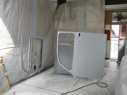

OK, now, sanding, sanding, sanding, spot prime, more sanding. I forgot how much sanding is needed for prepping for paint.
I set up a temporary paint booth in my garage. I hung a tarp along each side hooked onto aircraft cable at the ceiling. Another tarp hung at one end, sheet plastic at the other end and on the ceiling. Covered the floor with some reject rolls of artist canvas. One filtered fan for intake air and another fan and a row of furnace filters for exhaust air.
Body panels are pretty straight now and ready for final primer and guide coat.

Way overdue posting but here's more.
Well it's painted now, but not without a few issues.
I ended up with a bit of orange peel, so had to color sand. Unfortunately the paint seems thin in a couple of areas requiring some respray. My wish list now includes better lights for painting!

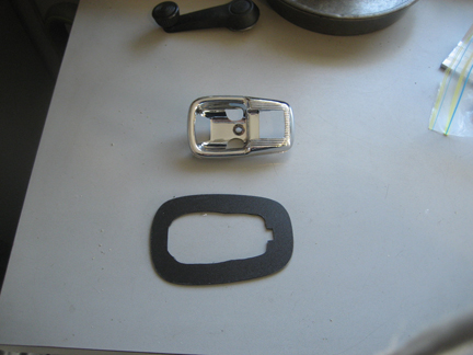

PostPosted: Sat Mar 31, 2012 12:26 pm    Post subject: Doors, steering wheel Reply with quote
Cleaned and rattle canned window regulators and associated pieces. Installed all new rubber seals and felts for the door windows. Hung the doors and installed new door cards and trim.
The PPO had cut out the opening on the door cards slightly too big for the inner handles to cover completely, so I made up a trim piece, from some 0.050" sheet PVC that I had, to cover the mess he made.
I had already replaced the original steering wheel previously (left pic) but I had since picked up a Grant Chevy wheel at a swap meet (right pic).
I checked my spares and had an adapter for VW that fit perfectly. I didn't really care for the full billet look this wheel had so I started messing around with it, removed the chevy horn button and underneath it was a complete black horn button assembly (it had Grant GT on the center button but I turned a new all black plexi one on my lathe to replace it). Re-arranged the order of a couple of pieces, polished it up and am quite happy with the result.
Thanks for looking,
Randy
