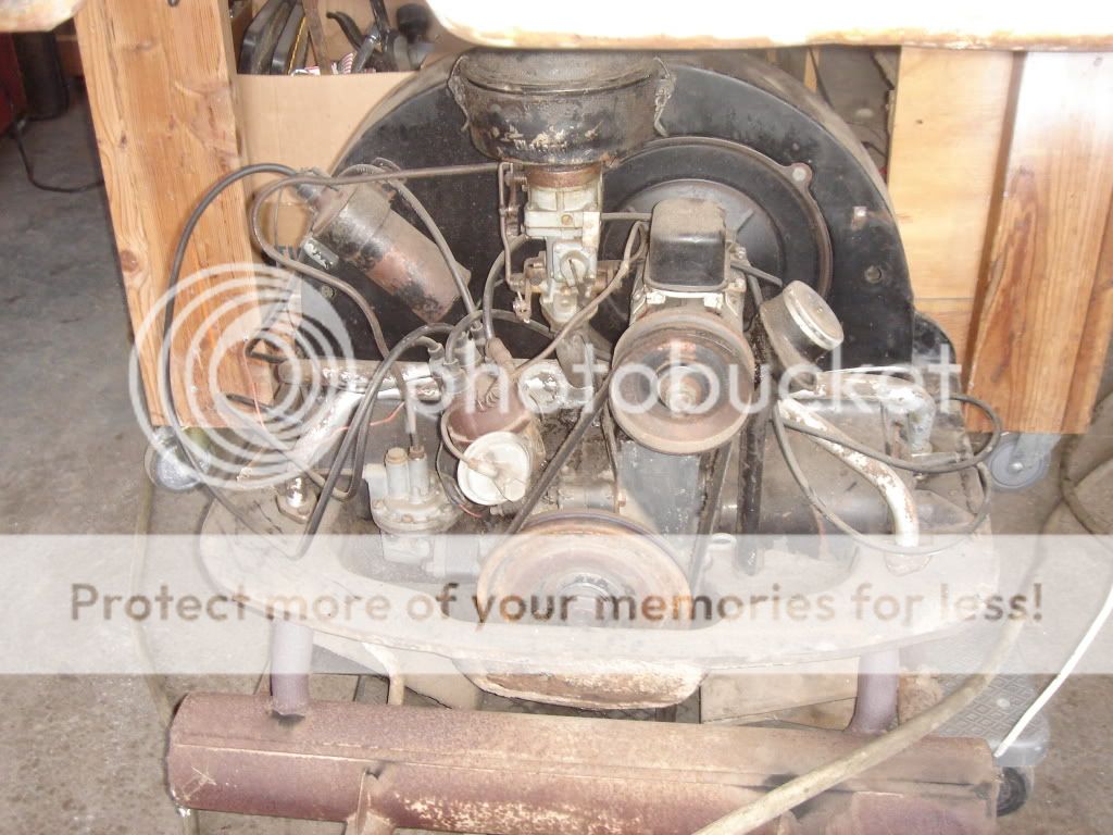

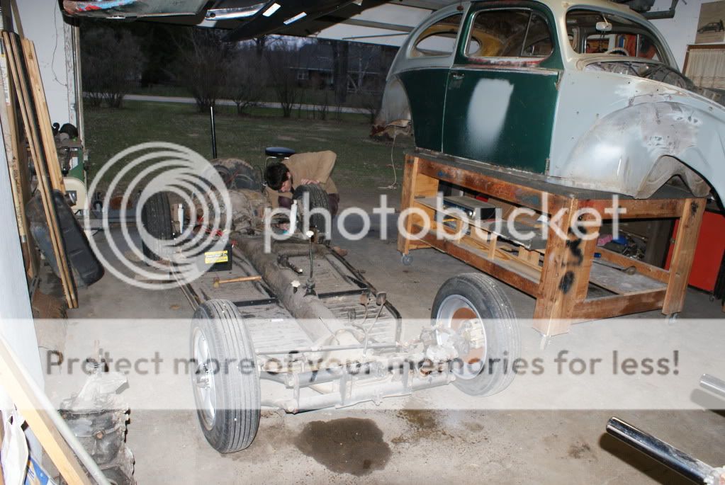

Finally! the back garage has room to finally separate it! and 50 bolts later... voila! Houston? Go! for separation!
Its really nice to have matching shell & chassis and its original pans 100% intact for a change. Every other car I
used to get back in the day for me was riddled with Midwest rust... this is a treat!

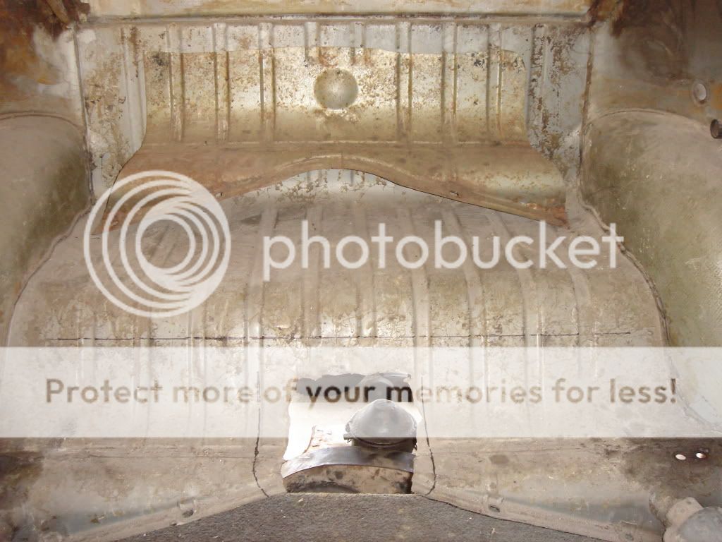

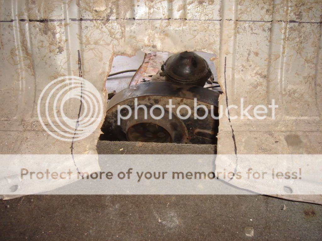

...Unfortunately from the PO being an idiot I have to address this....

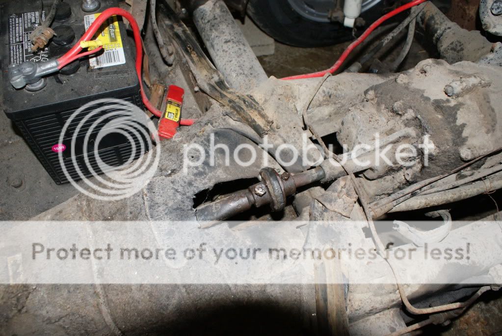

And this as well... I seen someone here wondering what looked wrong about trying to swap out an early
trans for a later trans and something didn't look right... well in case your reading this is what happens when a hack
does it... screw the T2 nose cone and the hockey stick... just bend the shift tube and hack a hole in the frame tunnel

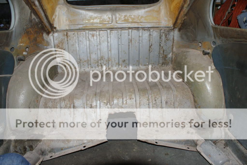

the size of your fist in the luggage area... and this is what you get!

3, Dealing with a fist sized hole in the frame tunnel and luggage area...

And hey whad'ya know... part of the fist sized hole is gone!
...Though I wish he would have at least ground down the welds a bit considering the grinder was only 10 feet away... No biggie there's still a small tab we need to fit into place so we can put the access cover back on again. So it will get cleaned up before the body gets mated back to it.

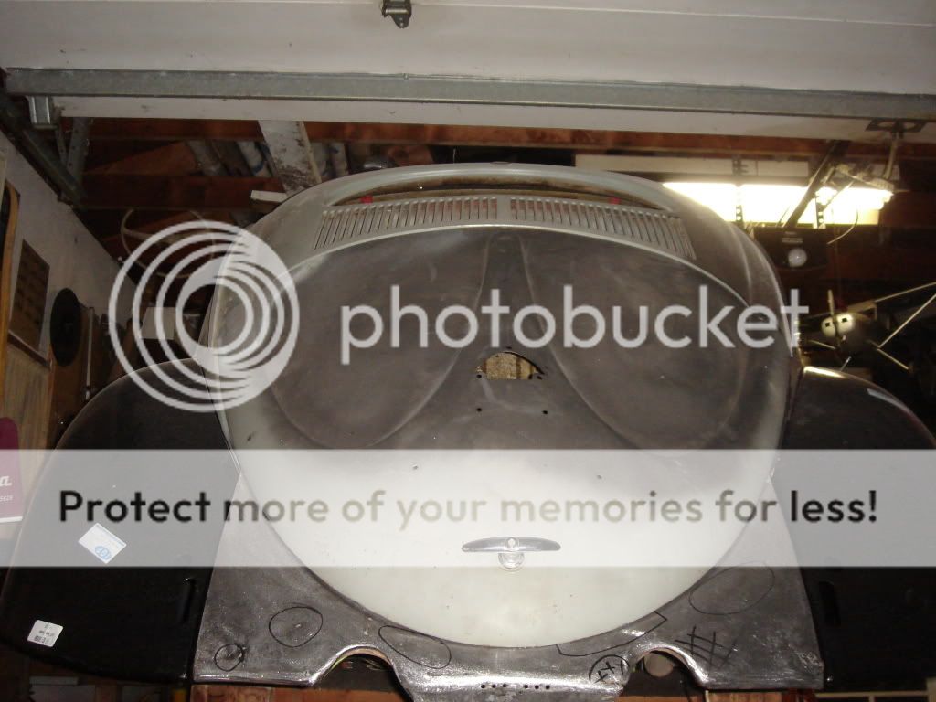

So anyways... since we're just kinda waiting on WW, CIP, Midwest and just about every other vendor you can think of that actually has their crap IN STOCK...
Why not work on some other parts...
Fabbed up the cover for the incorrect year fender to at least make it look like it has Euro wings again... While I do the fitting, cutting & banging... my son does the melting (my eyesight and too good these days I just try and not tell anyone)
And in the end once the fillings done these is going to be looking pretty good and good old original German steel to boot... And I did manage to make him see the how to butt weld.. and the pro's & con's of going over or going under or to stitch (which will be next week maybe) and that metalwork only hinges on strength & it's end finish work... I'm not complaining at all.

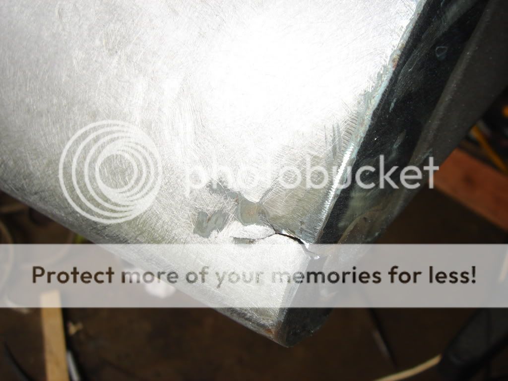

Looks not to bad considering I ran out of Argon... will finesse it up a bit after the big strip down of it all...

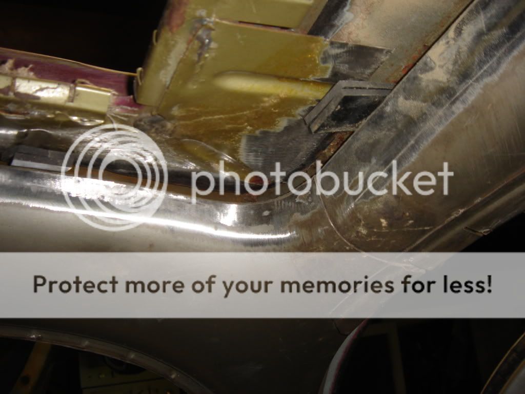

and the second question it put in my head was fro this pic...
While I do remember the gap in there and it was just shy of being 1/4" thick to accept the finished headliner. But I can't remember how deep it was ... anyone here know about how deep that clearance is so I can keep a headliner in its place? ...I really don't want to make up some cheesy Masonite headliner insert (unless that how they originally were but I doubt it)... but with not seeing what was (or supposed to be) ever or heck even seeing a completed original rag model that actually had an completed interior it I kind of... have a lack of of hands on information... Anyone can shed some light on this 'detail' for me?

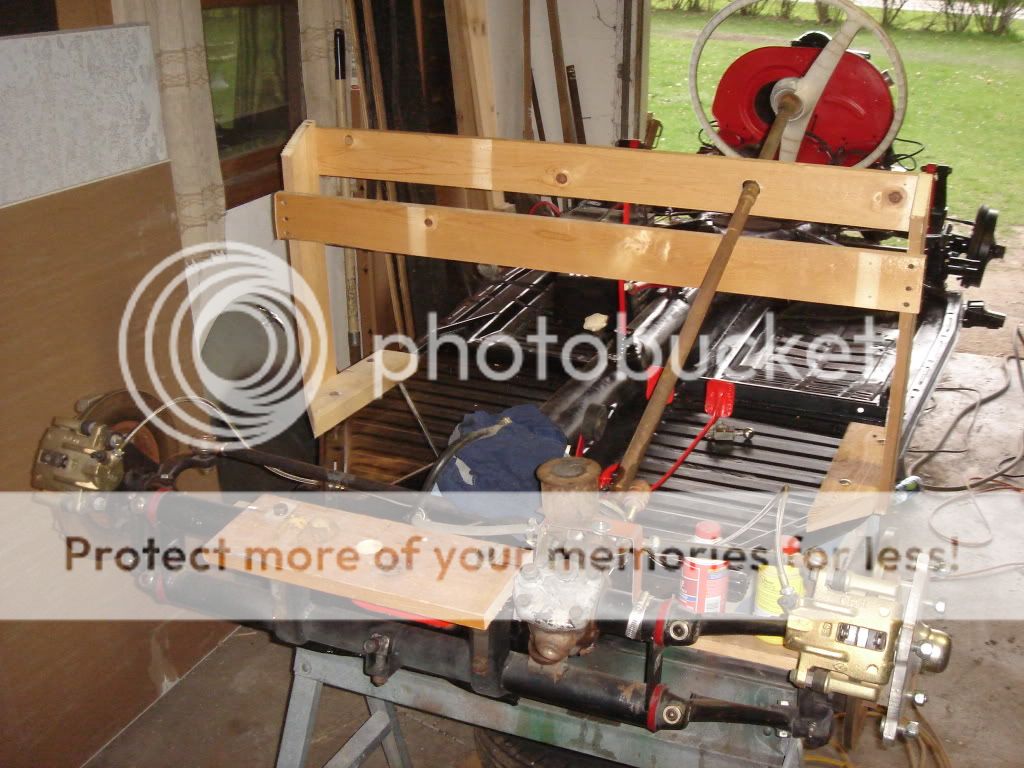

Then clean up all them burs above and below as you want this all laying as flat as possible.
Since no one seemed to know how deep the original gussets are to accept the headliner... The only thing I could come out was these little clips I bent up... And in the end I think they will wind up working very well when we get to trimming out to the headliner.
And seeing as I had little extra time I nailed down the final little stopts and get the twist out of the rear apron and now the rear lid fits tight all the way around... YAY! nno more 1/2" gap on the drivers side!
And while I'm not worried about this yet, the only way I could get to the backside to re work the outer apron I had no choice but to cut the inner apron as clean as I could and the drivers side was already missing anyway... now that the other spots are all straight & good now on the outer skin... I'm not sure how I'm going to reattach. If push comes to shove after the final strip off while I can easily fashion some small v clips and just roll over then and re-weld those. But . .

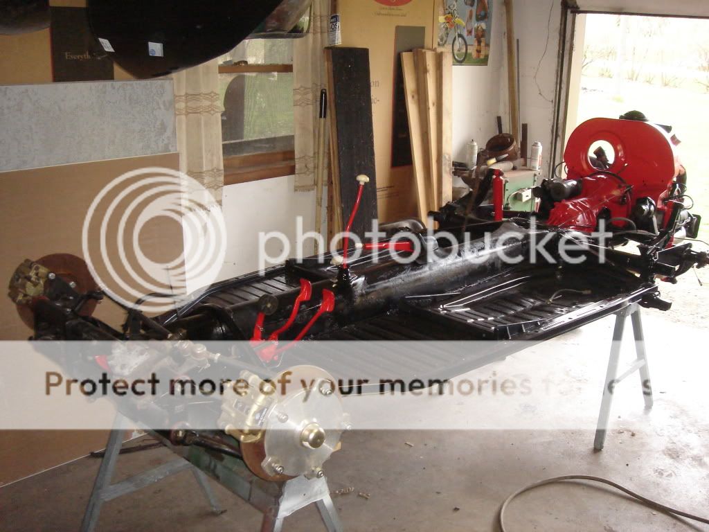

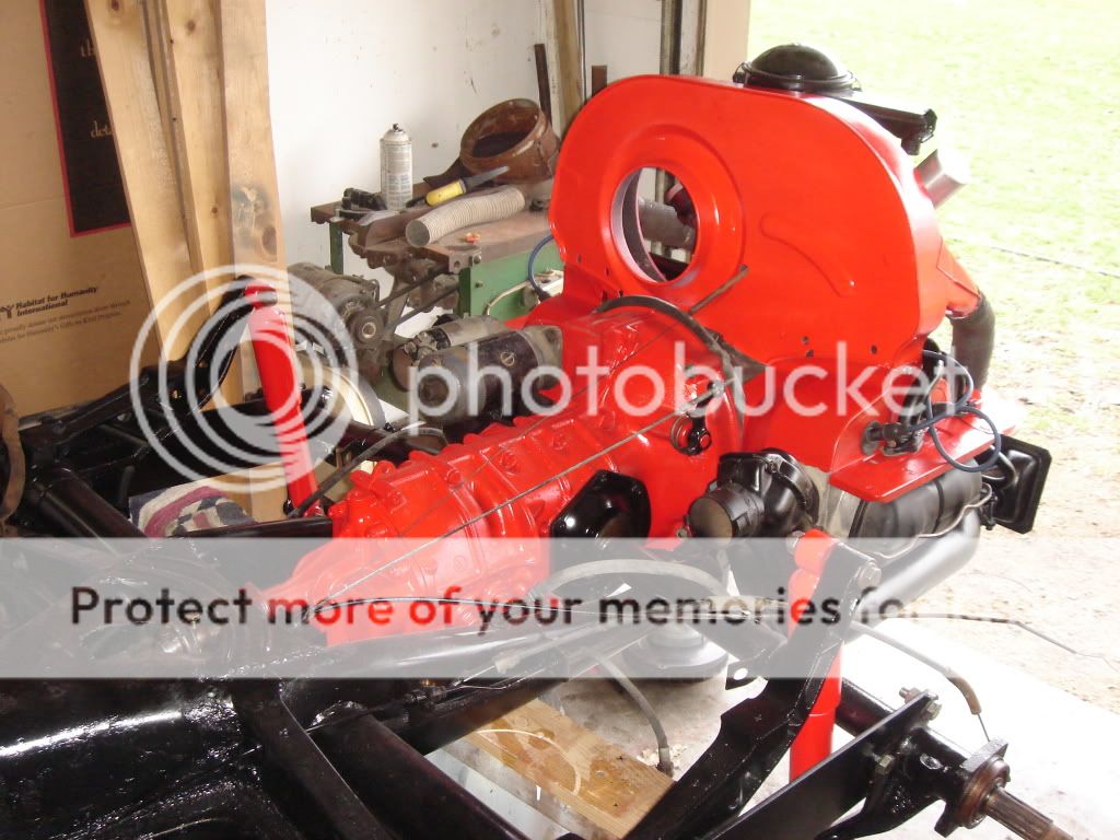

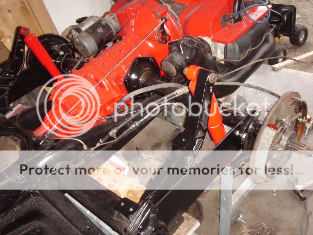

Houston? We have a nearly completed rag graft done right!
And Brakes and new lines as well!
Also the new gaskets and window trims came in to today... so I will be busy for the next week or two.... Now if I could just dind a good set of rear pop out frames... dont need ones with glass were doing alll the glass in the car in Light Gray glass... all the side window got trashed from the PO and were going the red and black theme so... it's-a going to be a clean eye catcher when its day comes...

PostPosted: Mon May 02, 2011 8:45 pm    Post subject: Reply with quote
0nebadbug wrote:
You might want to recheck the way you have done the clutch cable, you haven't fitted the bowden tube or its bracket, which bolts to the top studs of the split case.
Aust. RHD 66 Type 1
Aust. RHD 57 Type 1 Oval
modok wrote:
I am an expert at fitting things in holes, been doing it a long time
0nebadbug
Joined: October 01, 2009
Posts: 1087
Location: Rockford, Illinois
0nebadbug is offline
PostPosted: Tue May 03, 2011 6:25 am    Post subject: Reply with quote
66brm wrote:
Yes I know its on the growing "part$ we're mi$$ing" list.

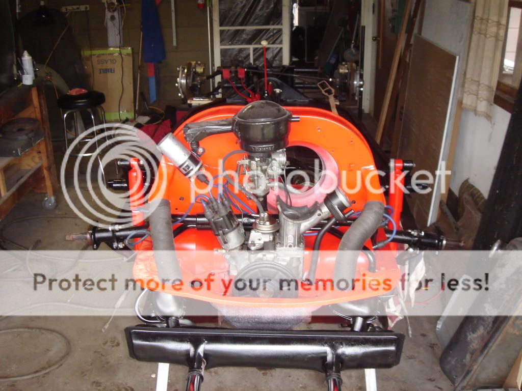

Well I guess it'll go at lest 60 mph for a couple of miles... Drained the trans and no funny things came out, a good sign I guess... got her fired on the stand and went through all the gears (no load obviously) and was silent and the gates were tight and miles less sloppy than my sons trans which has less than 2k on it... The guy I got the trans from said it was originally rebuilt 2 decades ago for a dune buggy application but the guy blew the motor 3 weeks later and ... more or less got abandoned afterward.. so far so good I guess..
all we need to do is bleed the brakes, rig something to hold a gallon of gas, wire up a kill switch, slap the seats on (why not bring a co-pilot!), ,
Whats even funnier is I might drive it like this to a small local drive-in show (thank god its only a mile and half away) just to see what they say maybe... LOL!
WIRED AND FIRED! *giggles*
Got a start on making the template for the windshield and all the custom glass that is going to go into it (haven't decided on Grey or Bronze yet)... would keep the original glass... but it is so pitted and scratched... and me being a glass person.. well? ... it just irritates me... all the new glass will be hand fabricated, by me.. and then sent for tempering... now if I just could get someone to trade me old motor for a nice set op pop out frames and there hardware I'd be in serious business.. as soon as this chassis hits the ground and is rolling again... the body is coming off my glass table and I can cut all these up!
Nice kill switch eh? anyone know what it is?
Got it out of an early 50's VW Ambulance many, many moons ago... no markings on it but it works & built like a brick shoe house... so it works for what I need... might make a hidden security/cutoff switch of of this piece when this thing is done maybe...
More to come ... maybe I should strap the vid cam to one of them wood slats when we take her off which should be in the next day or two, weather permitting... not that it matters... but everyone seems to like this kind of schtick these days... Me? I still look at a streetlamp to tell realize what time it is... And I still use this thing called pencil to make lists on white analog ruled paper....

PostPosted: Sun May 08, 2011 5:29 am    Post subject: Reply with quote
Yaya out of the Grange and off to the road...
I think I may need to get license plates that just say.. LOW N SLO with a bright red reflective frame around it.
And C'mon! ...How can you NOT take if for her first Joyride!
