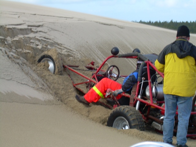

We Run Rancho RS9000 socks on our rails and have had great success. I have stock boxed dog legs and stock torsions.
They sure soften up the ride.
I am using RS99287s on the rear and are 18.5 compressed and 30.5 extended.
They have 9 different valving settings from super soft to super stiff.
I have them mounted as close to over top the bearing housing as possible and about head hieght in the roof down rights.
Here is a pick showing 1.how soft the sand was that year and the shock set up.
