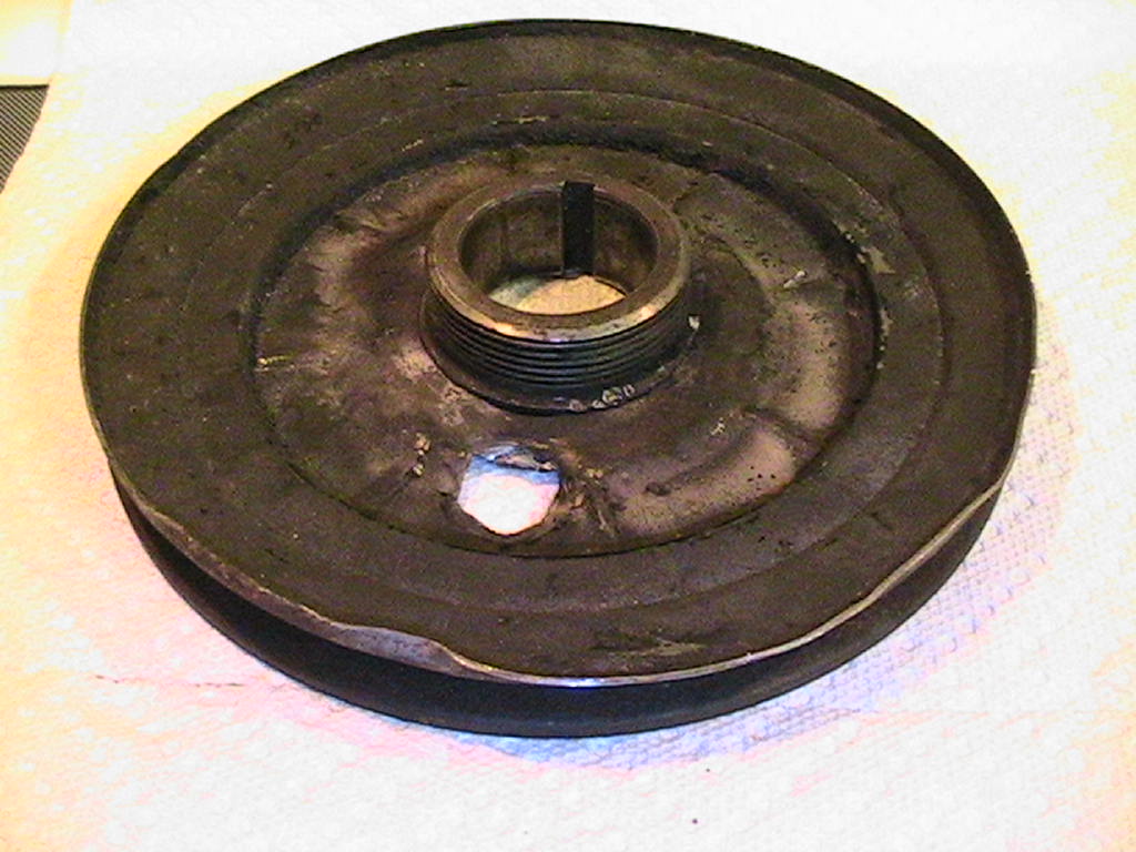

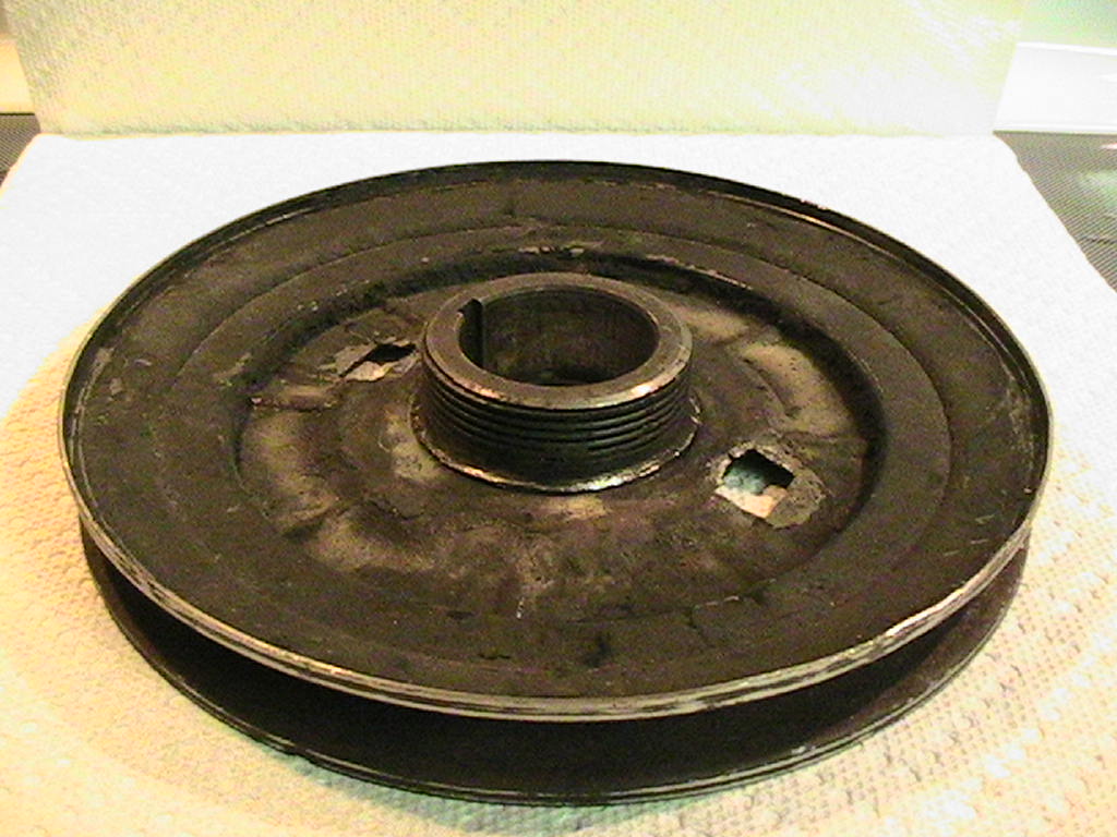

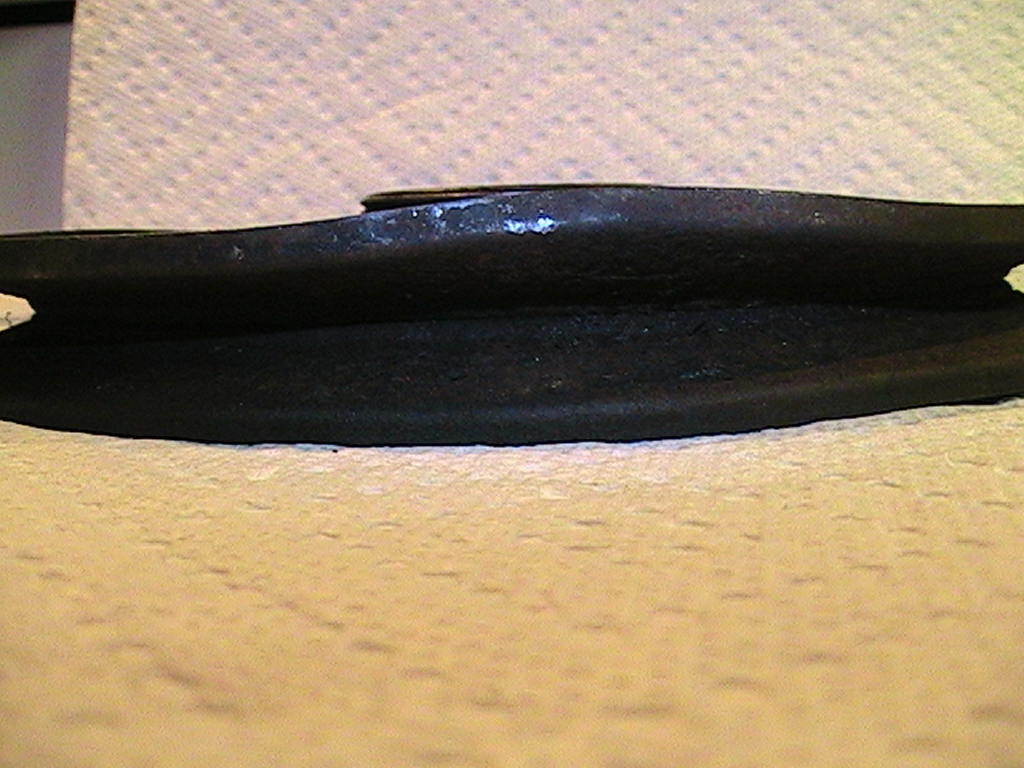

We had a few 25hp crank pulleys laying around that were bent and distorted. I needed to find at least one that I could use on my August 1949 engine rebuild so it was time to figure out how to get at least one straight and round again. We had good success on one so we have done a couple of others.
Here are some before and after pictures of one of the worse ones.

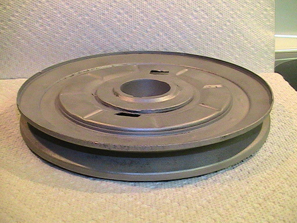

After some straightening work, the same pulley now looks like this:
After a quick trip through the bead blaster it's nearly ready for paint:

It's a combination of 35 years of experience doing metal work and auto/truck/semi tire/wheel balancing and trueing.
We took the principles used to straighten a wheel and machined a mini version of the equipment.
It's tedious work, even the "nice" ones seem to be bent or have some type of runout or wobble. Make the mistake of dropping one, and the lip is so thin on the 25hp variety they nearly always bend. You cannot really see the wobble until it is mounted and the engine is turning at a low RPM.
