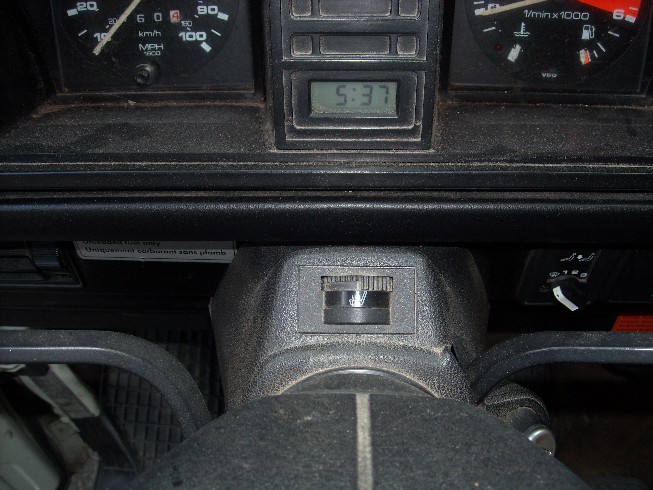

Any chance of someone posting a pic of this rheostat? I'm curious.
Oh if anyone is pondering the salvage yard route, Saab 900's had heated seats.

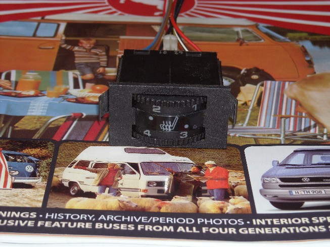

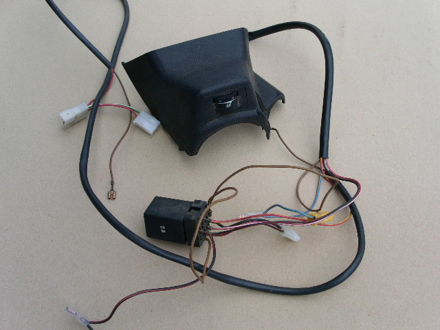

PostPosted: Sun Jan 03, 2010 8:05 pm    Post subject: Reply with quote

SAAB seat install- http://www.sthwark.demon.co.uk/syncro/syncro_projects.html#Saab

I think that they did come in brown. The column cover could be bought as of last year when I checked but the dial switch was over $150. Then you need to source a heating element for the seat and figure out the wiring and relay to make it work.
That seat heater only controls a heated seat element for the driver's side. Do your passenger a favor and buy a aftermarket unit so that they can have toasty buns too. Smile It'll cost less in the end too.

I have them in black and brown.
Yes the switch is expensive, $150+.
I was lucky enough to buy them years ago.
I have a few extra that I would be willing to sell.
pmail if interetsed.
