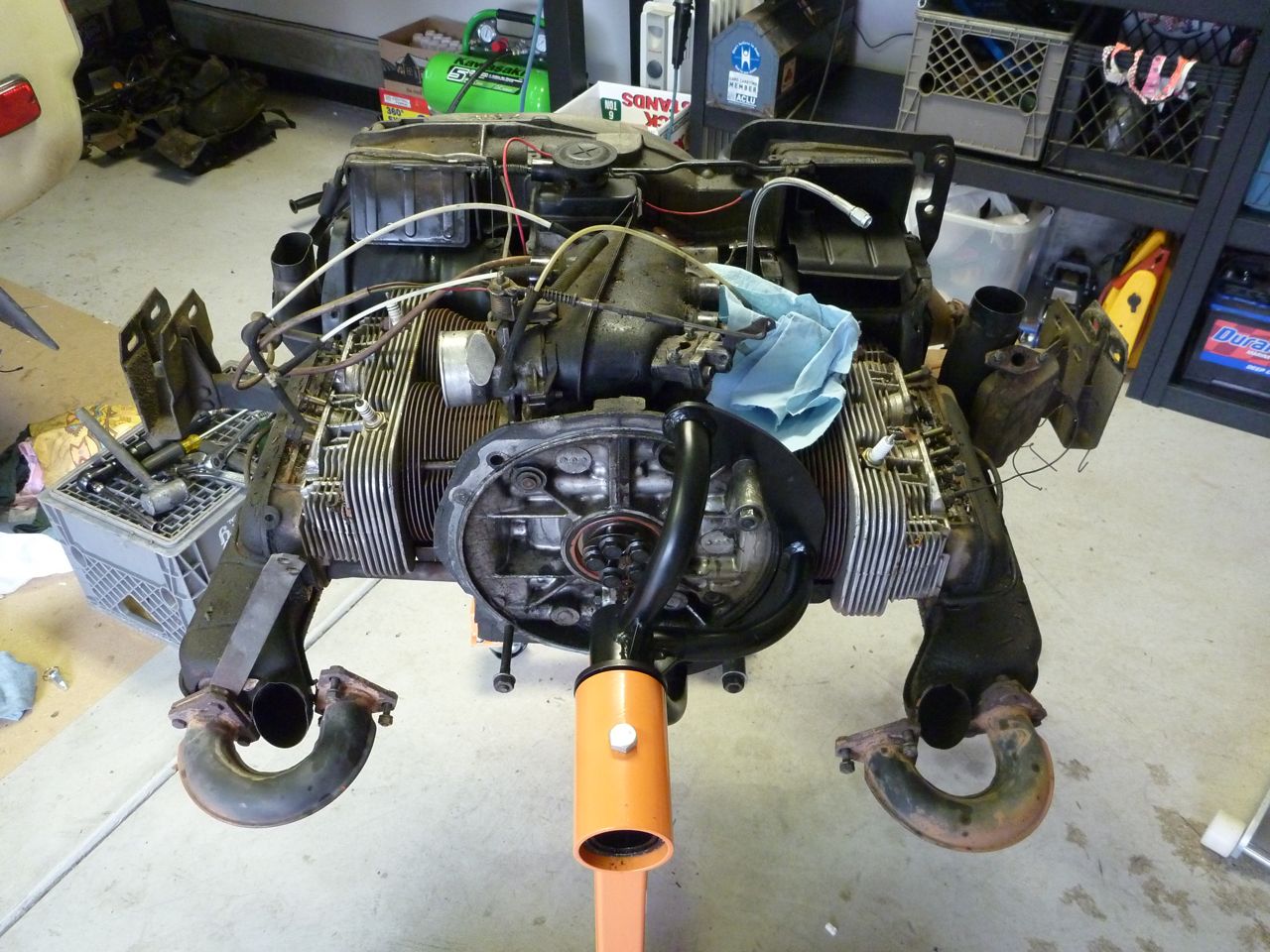

Just removed the engine/transmission per ratwell.com
Engine on the stand. I found the excellent yoke on the samba classifieds (search for "yoke").

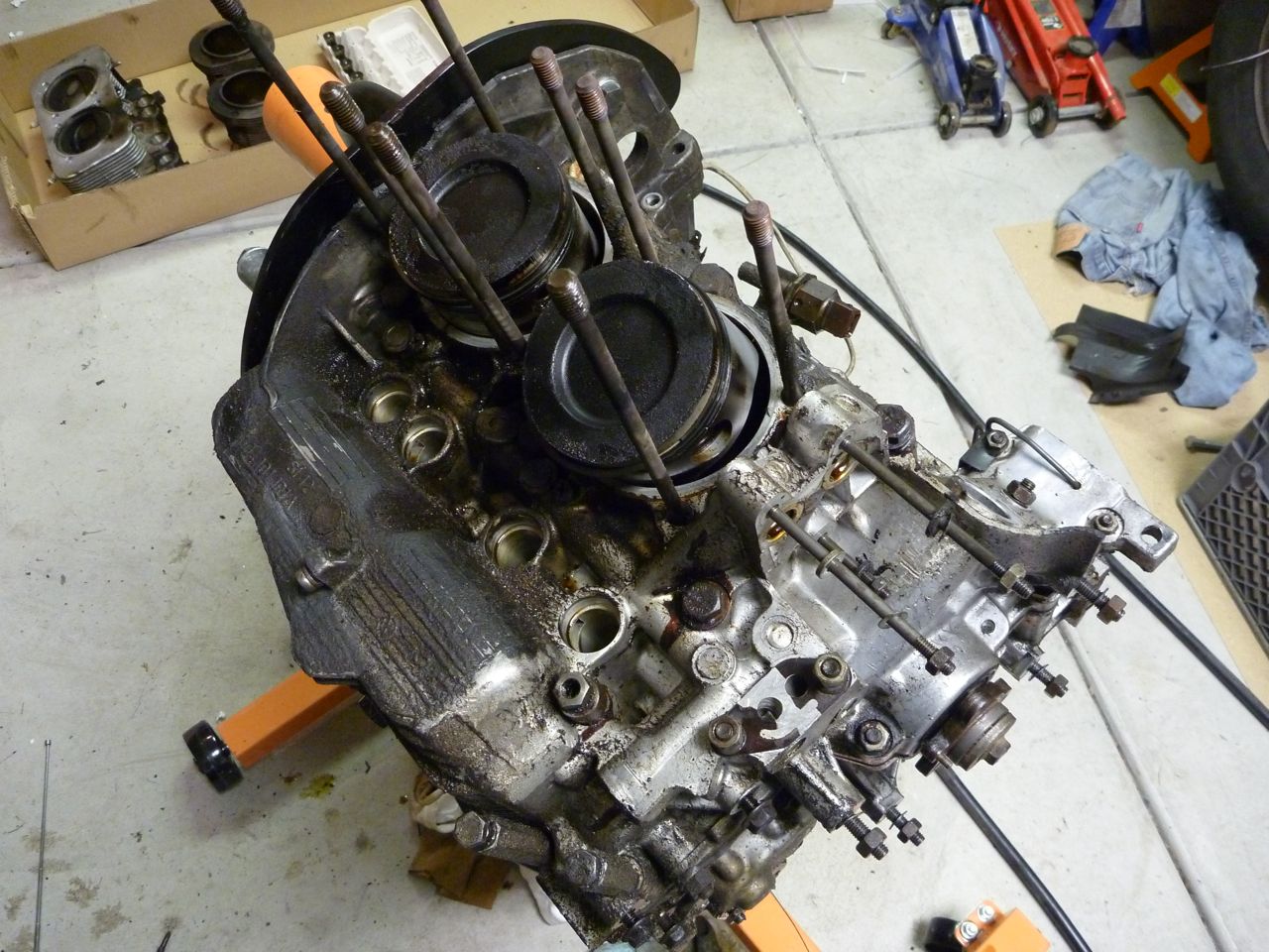

Pulled the heads/cylinders.
Scuffing on the side of the piston (only one). Wilson tells me this is a sign of overheating, which my CHT/oil temp gauges told me.

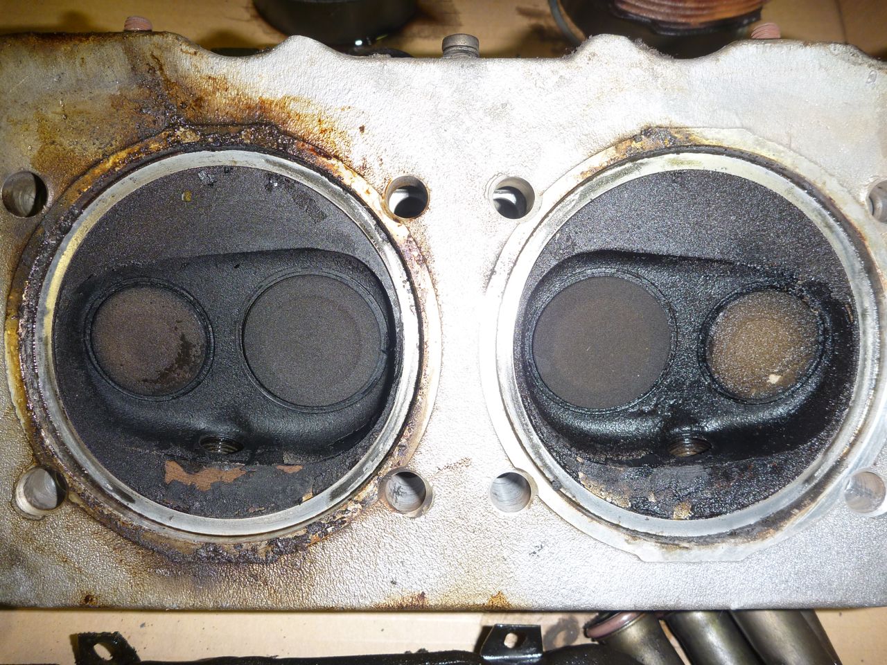

One head. Is that burnt part from a leak?
The other head has the same kind of burn too.

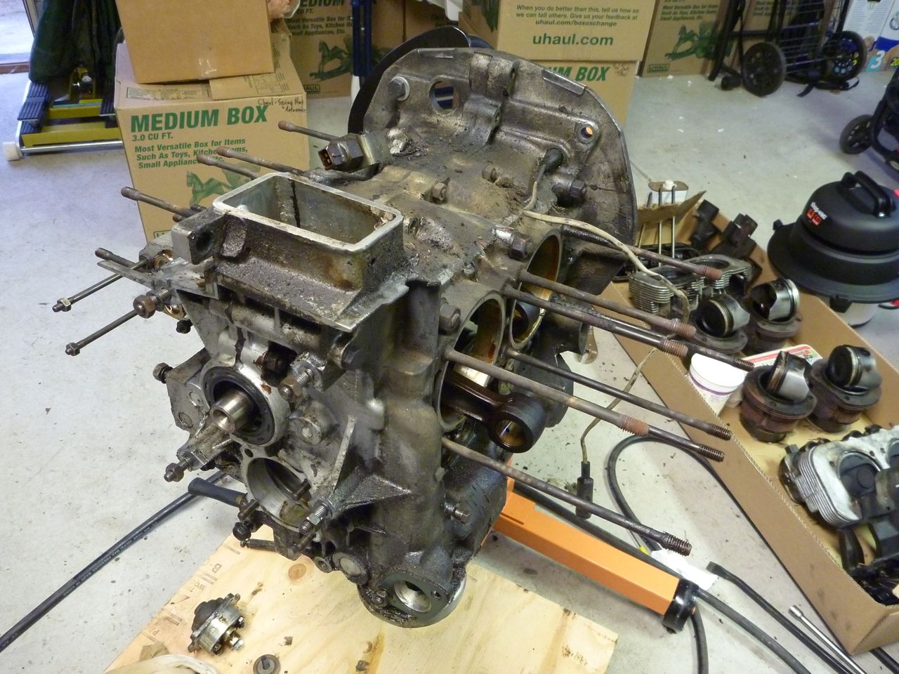

The block waiting to be split.
Block viewed from the front.
Viewed from the side.
The block did not want to come apart. Does anyone know how to remove that flywheel sensor on the bell housing?

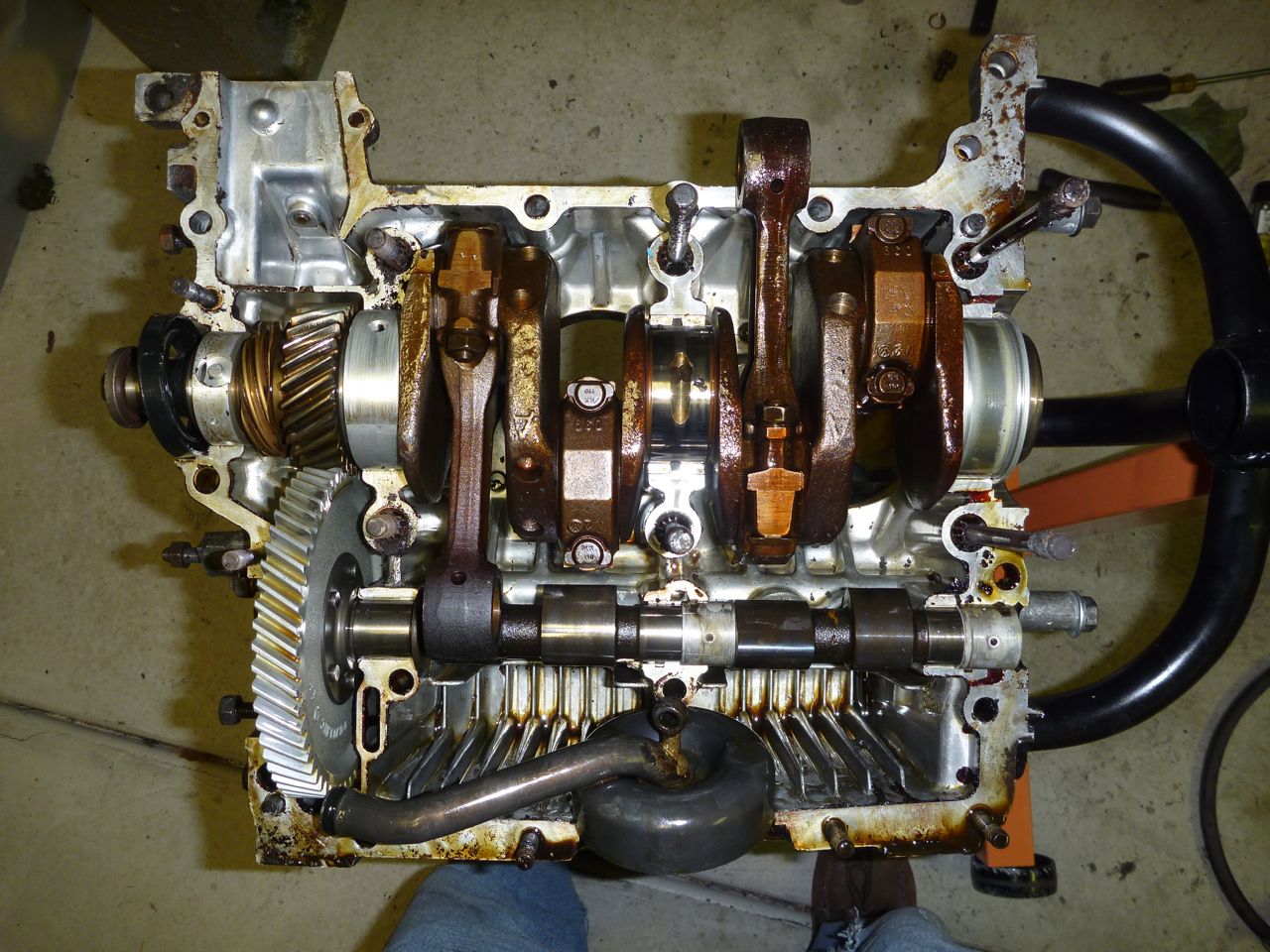

Success!

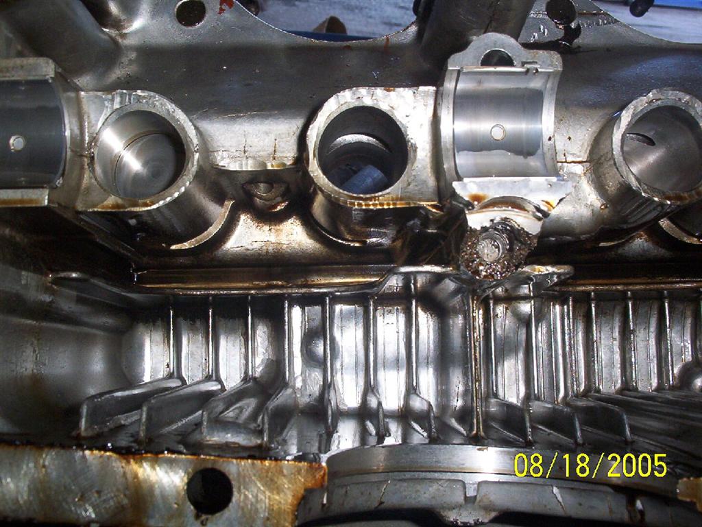

Doesn't look too dirty in there. Look closely at the hacked oil pickup... also missing the "windage tray".
View of the oil pickup in its proper location. It looks like someone over-torqued the oil screen and repaired the damage at some point.
Broken case at oil pickup.
Main bearing seats. Notice the deep wearing on the middle one that has occurred from the crankshaft.

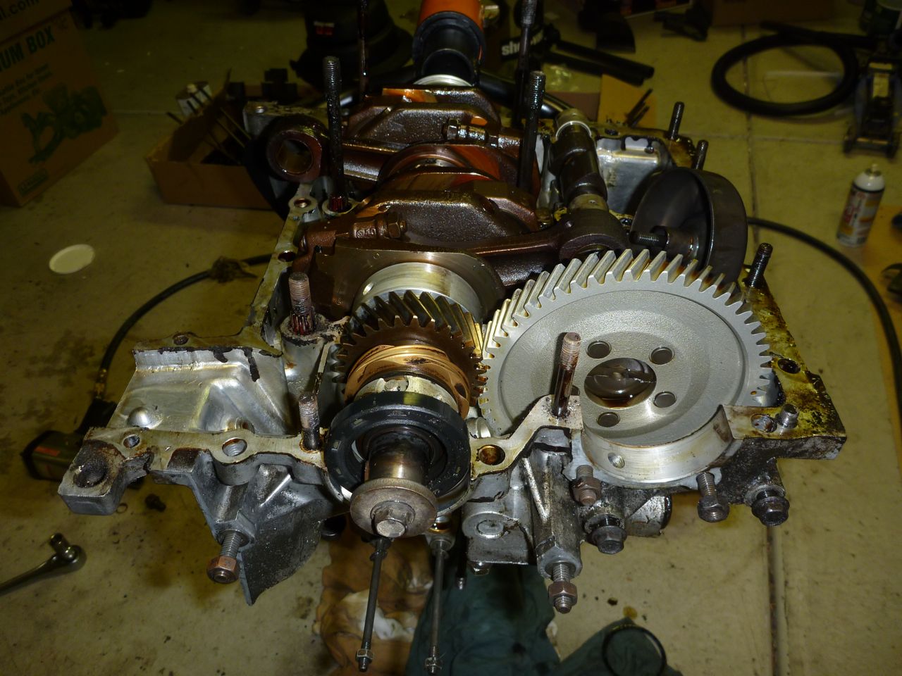

Crank and distributor drive gear.

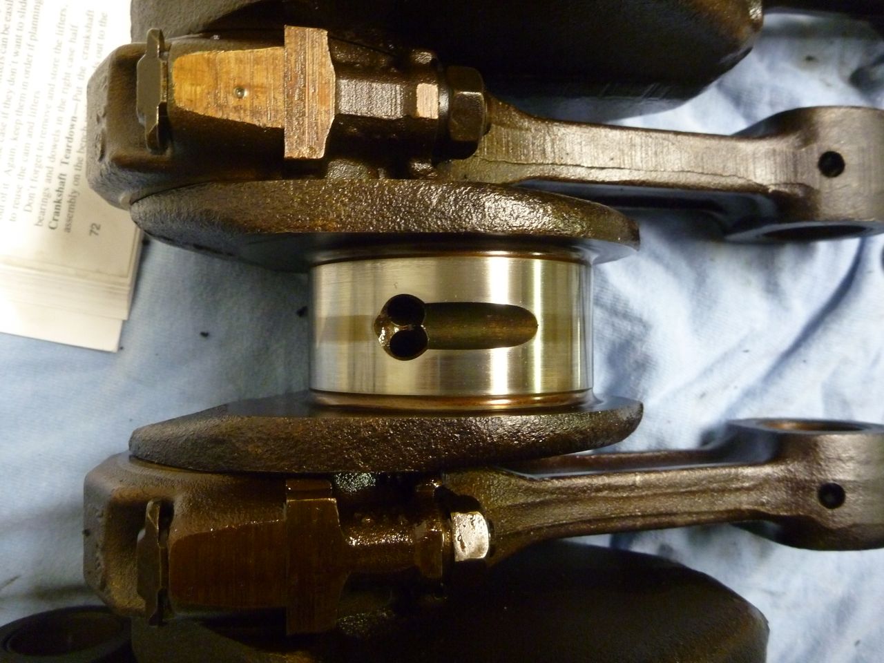

Crank journals look okay so far.
Center journal on crankshaft.
Another shot of the same.

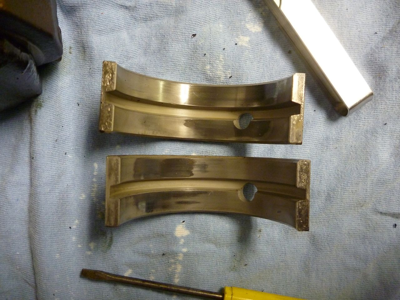

Center crankshaft bearing has some shiny spots...

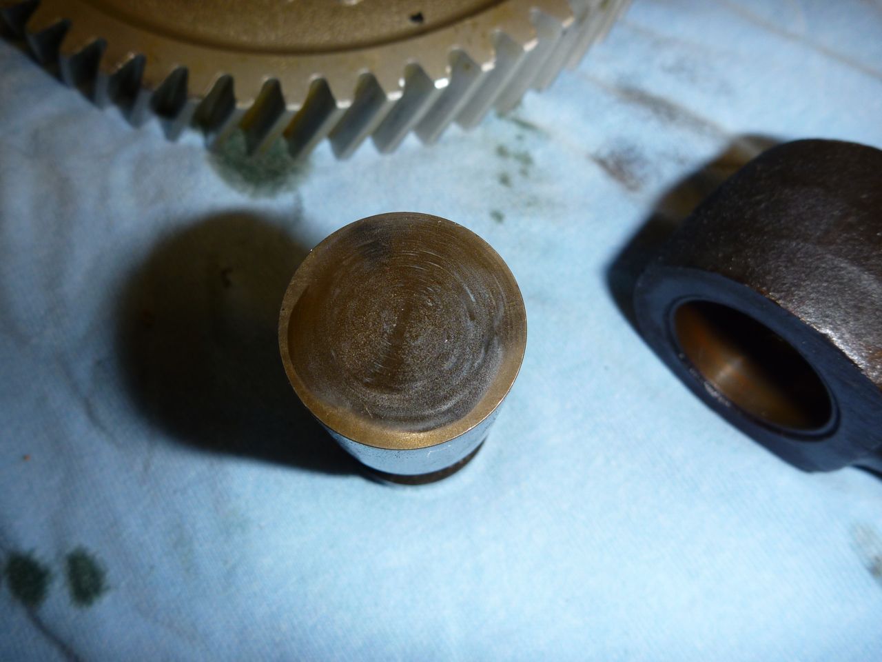

Camshaft isn't worn too badly.
Lifters all look like this one. Not bad.

That engine must not have had too many miles. I don't think I have ever seen a T4 cam that didn't have more obvious wear than what you have. The outside of the engine appears to be amazingly grime free as well. the lower several rows of fins on the cylinders are often totally clogged with dirt, while yours were clean.

Yes, that is a low mile rebuilt engine but the pistons suffered from overheating and oil leaking into the combustion chambers (leaking rings).
Send out the heads to Headflowmasters for a complete rebuild..

The bearing wear is typical and looks good.
So the oil pickup was just sitting in the bottom of the case without being installed?? great...

The oil pickup was properly plumbed into the right side of the case (you can see it in one of the pics) but its mount is a hack to make up for the damaged case. and the engine is missing the windage tray as a result.

I would be looking for a new case.
RIMCO in CA used to be able to fix the "type 4 syndrome" (over tightening the oil pick up tube bolt), but those guys are all retired I have heard. I have never used them though.
You might call Adrian to see if he can fix it. I would have him improve the valves at the same time if it were me.

Are you talking about the brazing of the hole to mount the oil pickup tube?
Also not all these engines came with a windage tray... 914 engines yeah...
That case does not look broken to me... or is it cracked and hard to tell in the picture.
http://www.headflowmaster.com/Home_Page.html
That's what I was afraid of--does the broken oil pickup tube mount really mean a new case? It worked fine like this for at least 16k miles and the rest of the case _appears_ okay (I will know more once I wash it). What would be the problem with using it like this? How could Adrian fix the case in a better way? There is a complete 1.7L 914 engine for sale in my area; I think I could use that case as a 2L with a little machine work on the cylinder bores--does that sound right?

I'm not seeing the problem, any closeups?
THIS is broken!
Shocked Laughing Wink
Thanks for the pic Keifernet! That makes me feel better. Plus I saw this pic of Bob's Bus:
http://rides.webshots.com/photo/2248335840087888626OKuCwa
...which looks identical to mine. I just figured that when the windage tray was missing and I saw the welding on the pickup that something had been repaired. There are no cracks on the case near the pickup.

The brazing on the pickup tube is normal... that's how they were made. And unless my old eyes are letting me down, I don't see where your case is busted?
This thread has many more pics to view.
http://www.thesamba.com/vw/forum/viewtopic.php?t=367562&highlight=oil+pickup+tube

I thought it looked broken, but I will defer to keifernet. He knows a lot more about these than I do (thank god).
We might need some better pictures.[/img]
