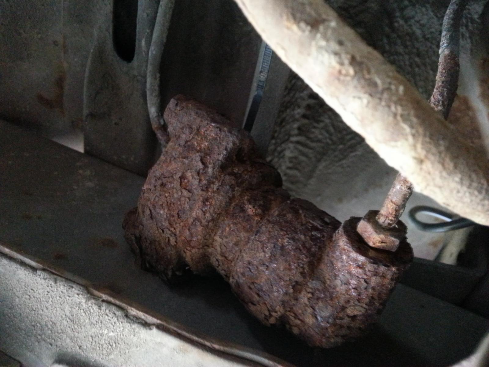

mine's in extremely rusty shape and from past experience I am assuming things will shear off when removing.
I'm planning on replacing all the brake hard lines, and of course that means dealing with the rusty objects the brake lines screw into.
Replacing the brake tee's just because they're so inexpensive. but the proportioning valve is quite a bit more pricey.
So, looking at mine should I just remove and take a wire wheel to it, and repaint it? Or will there be things unforseen that will result in me being halfway through the refurb when I find I just should have bought a new one? Are there any rubber seals or parts I would need to do a refurb?
here's mine:
dude in nova scotia had a similar looking one...

PostPosted: Tue Aug 12, 2014 12:51 am    Post subject: Reply with quote
i would assign that valve to the scrap pile, and find another

PostPosted: Tue Aug 12, 2014 1:53 am    Post subject: Reply with quote
Clean it up and see if it works.
Use flare nut wrenches to take off the brake lines
don't take it apart
don't let any dirt get inside
OG is usually better than replacement parts
Aloha
tp

PostPosted: Tue Aug 12, 2014 3:14 am    Post subject: Reply with quote
don't take it apart
Aloha
tp
I agree with everything that Tom says here. Yours does not look that bad. At the time I was working on that one above in the photo, I could not quickly source a replacement, and I was keen to get the brake lines all replaced. I have since purchased a replacement, but I keep the new one as a spare, because the old one works fine.
Those brake regulators can look very bad on the outside (yours does not look that bad to me) and yet be perfectly fine on the inside. The steel is very thick, and as long as the inside has not been exposed to the elements (e.g. open brake lines) then the inside can still be like new. There is a valve inside that re-proportions brake line pressure front/rear during hard braking, so that the rear wheels don't lock up as the weight transfer occurs. It is easy to check if it is working. I would do this…
Brush the loose rust and dirt from the regulator and brake lines. Soak the fittings and the mounting bolt with a good penetrant for a few days, then loosen the lines and remove the regulator (so you can treat the rust in behind). When you have it off, give it a gentle shake using a rocking motion. You should hear the proportioning valve rocking. If you don't then it is bad. That is the first test. Clean it up, de-activate the rust, paint it a pretty colour, and put it back together.
The second test is to do some hard braking and see if it works. In a safe location of course. Under hard braking the back wheels should not lock up early. That is dangerous. If they do, the valve is not working and will need to be replaced, but now it will be much easier.
I see no harm in trying, and my rationale (as Tom has said) is the the OG internals, as old as they are, might just be better quality, and safer, than a replacement of unknown quality. We hear all the time of replacement parts failing very quickly, and I don't want to take that chance with brake parts, if I can avoid it.

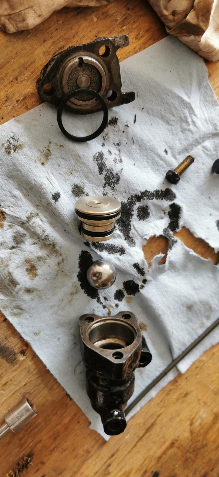

PostPosted: Tue Jul 07, 2015 3:23 pm    Post subject: Reply with quote
don't take it apart
Aloha
tp
Oh pishsaw! Don't Take it apart? It isn't a bomb for goodness sake.
It has a big ball bearing it the rolls forward on hard braking and adjusts the brake pressure to the rear drums.
Take the top off, clean it out, it's full of brake fluid crap.
I got a cup of dirt out of mine.
Dave
Ghia
Vanagon
Beetle
Vanagon Nut
Joined: February 08, 2008
Posts: 10522
Location: Sunshine Coast B.C.
Vanagon Nut is offline
PostPosted: Tue Jul 07, 2015 8:57 pm    Post subject: Reply with quote
Thanks for that pic David.
Got any more shots of that part?
Are the halves sealed with a rubber O ring?
Thanks.
Neil.

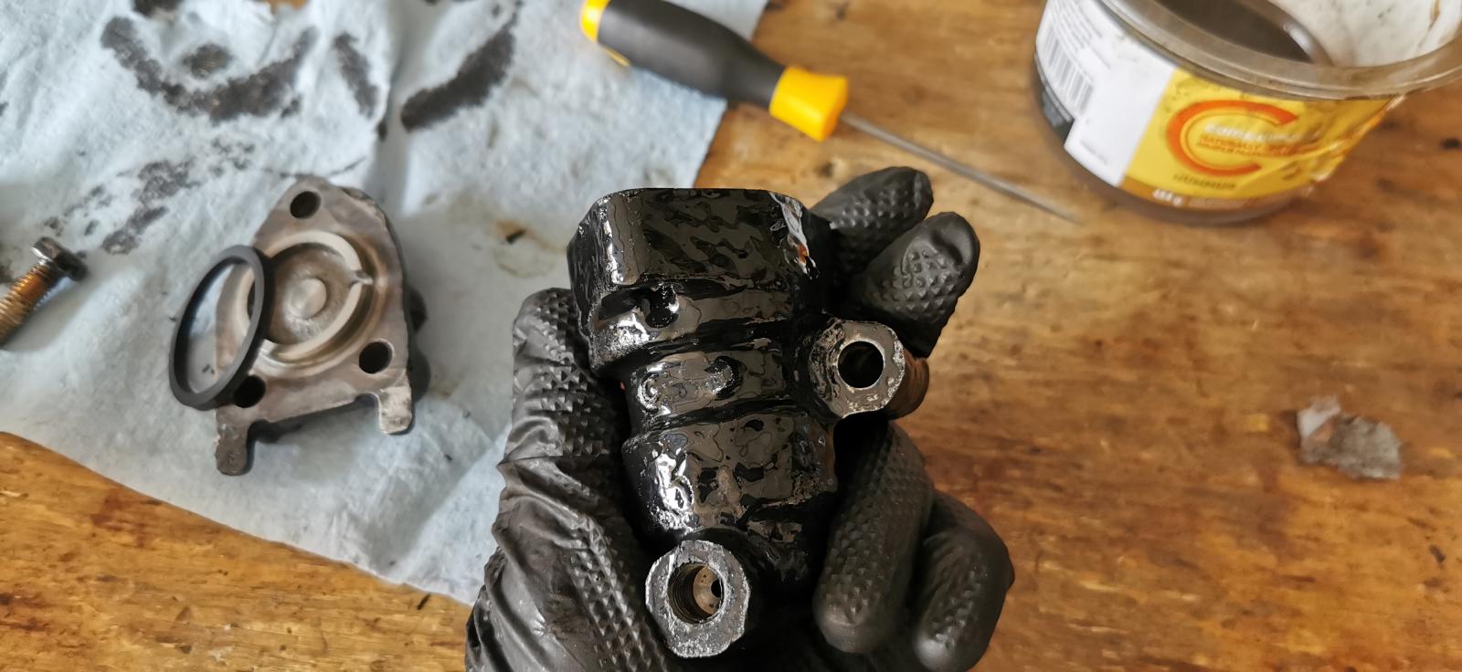

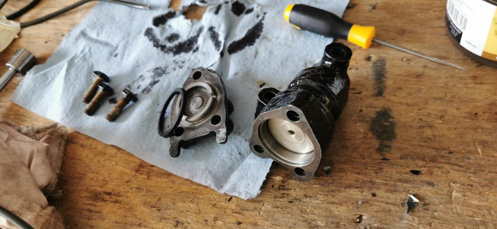

Matt & Stan the Van '
Joined: June 04, 2022
Posts: 16
Location: NOVA SCOTIA, Canada
Matt & Stan the Van ' is offline
PostPosted: Sun Jul 28, 2024 7:31 pm    Post subject: Reply with quote
These posts from 9 year ago and more continue to have value for us newbies, and I appreciate the discussion.
I had the same gawd-awful looking valve on my '88 that looked like a rusty grenade from WWII, every bit as hopeless as the above posted photos, and I thought I'd have to get a new one.
But I did all the stuff you all talked about here. Had to use extractor sockets and impact wrench on the badly corroded flare nuts. Put rubber stoppers in the fluid ports. Soaked the body, still bolted together, in Evapo-rust for 2 days, then beat it up with a brass wheel brush, down to bare metal. Unbolted the cap so as not to paint it shut. Degreased and painted with POR15. Let 2 coats dry.
Once the paint dried, I investigated inside... the insides looked good, if grungy. I sprayed a ton of brake cleaner into the piston hold, and it drained out of the bottom brake fluid port, but i felt I wasn't really getting it clean. I wasn't sure how to pull the innards out of the valve body -- not obvious to me, and asked ChatGPT. So I used an air compressor with a rubber cone nozzle on it, and shot air into the brake line port at the bottom, BUT first made sure to bolt the cap back on the valve body very loosely, partially, with lots of play; I wanted the cap on to prevent blowing the contents out all over the garage. (I've seen the power that nozzle had on brake calipers and pistons flying out.) so then I got the inner piston and ball bearing out and it was interesting to see inside. It was gunky so I'm glad i removed this and cleaned it out with brake cleaner. I wished I had seen photos so I'm going to post mine here in case it helps anyone else. If I can do this, anyone can!
I got all the gunk out of the body and cleaned up the gunky piston and O rings. Looks great now. There was one part of the piston piece that I did not frig with: on the side that faces the ball bearing there's another small seal. I decided to leave that alone, figuring there can't be a lot of gunk in that small space. I didn't want to tear the seal and end up having to buy a new valve after all! The O-rings were fine. The seal ring on the cap was fine.
I agree with the above posters comments that the original is going to be better than a replacement, and the insides were like new. I'm convinced my PValve is 98% like new now after refurbishing. I did a similar process on my propane tank few years ago which also looked like a rusty bomb. As DJKeev points out, it's not a bomb....
