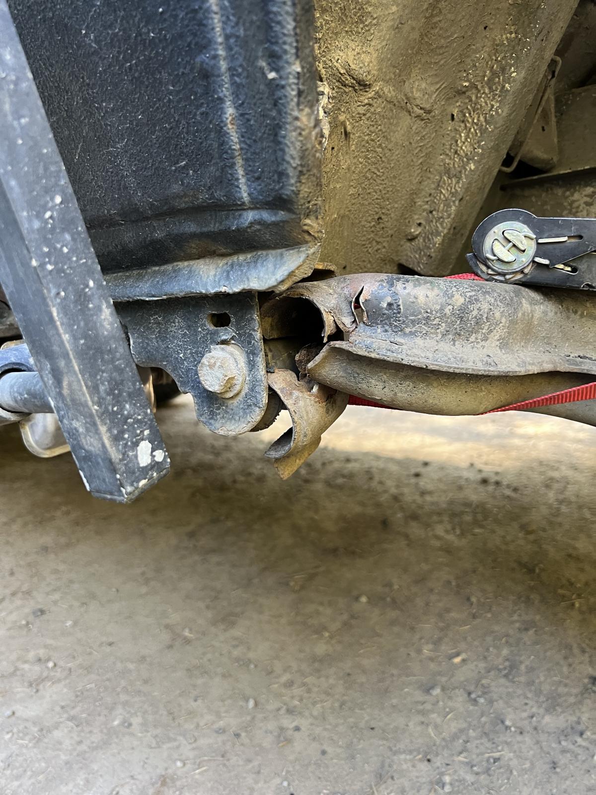

We are stranded in Hood river in our 86 Westy. The left rear control arm imploded on itself beyond repair. Please let me know if you have one available at your earliest convenience. Thanks

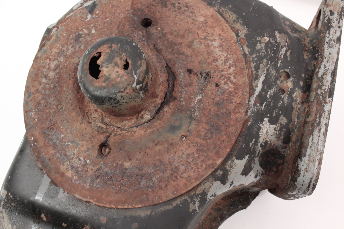

Just curious--What causes a rear control arm to implode?
VicVan
Joined: July 01, 2015
Posts: 1936
Location: Vancouver Island, BC
VicVan is offline
PostPosted: Sat Apr 20, 2024 8:07 am    Post subject: Re: STRANDED IN HOOD RIVER OREGON Reply with quote
My money's on rust...

Not sure exactly what happened but the hoop where the bushing is pressed had separated causing the spring to shift and break off the seat causing the suspension and wheel to collapse on itself. Tire was rubbing on the frame and spring real bad. Here’s my current limp set up. :/
Bingo.

Probably should do both sides. The rear will need alignment once repaired. Other than the spring perch which is available as a repair part, I'm pretty sure the arms are interchangable side to side if you deal with the spring perch. I mention this only because you are on the road and if you can get the opposite side near by, it could be adapted to get you moving.
My diagnosis is between the heavy duty shock, spring and those trick rear brakes, that point was seeing some load. Wink

Note to self; pack a coupla ratchet straps for roadside repairs.
OP, AWESOME use of straps!!!

I did source a part in Portland via Halsey referral. Someone working there had one in his personal stash. 300$ ouch 🤕 but it’s the part I need and should get the van goin by tonight or tmw morning.

Honestly just grateful a fellow enthusiast was willing to help in a pinch. Avery’s air cooled had one available too. Thank god for the northwest. Very grateful the rest of the system wasn’t damaged beyond repair.
Now to wrestle the bolts out of place.
The upper spring seat has also decided it’s tired as well.
I’m sure someone sells a replacement? Weld in im assuming?

I don’t recall seeing a replacement. A local welder could fabricate something pretty easily using the rubber spring pad for dimensions out of some spare metal. If all it did was spread the load across the good metal that would likely be enough without welding it in. It would be nice to have the bump stop support welded to it. Should be fixable local to you.
