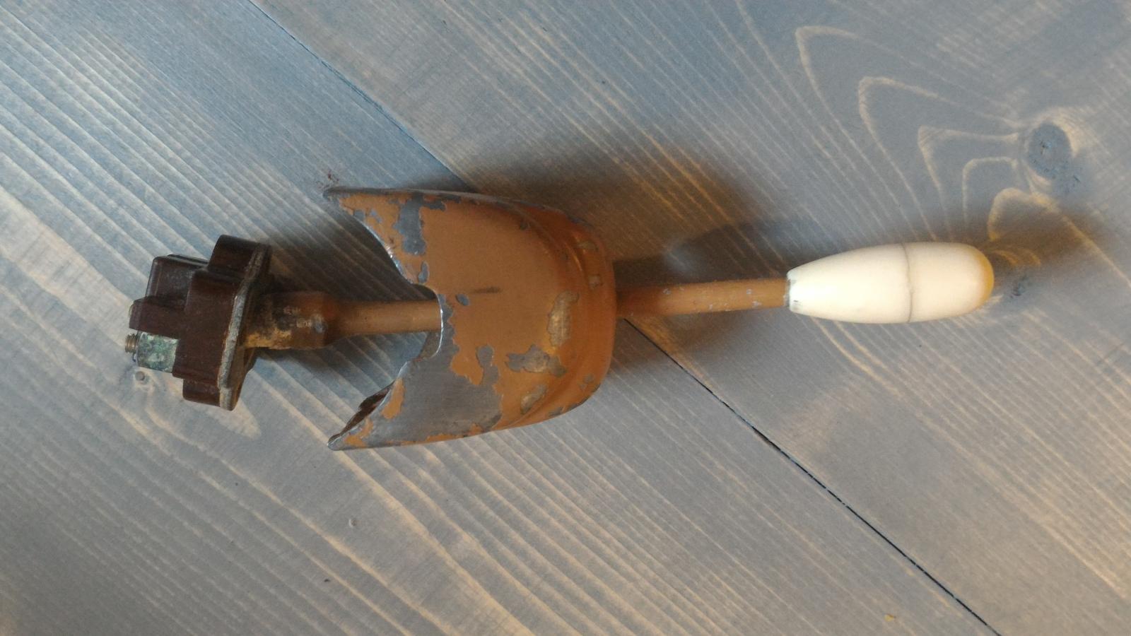

Gurus:
Is there a proper name for this type of switch housing?
I can't find a 3-wire replacement switch. Anyone know of a source for the 3-wire switch for this semaphore EuroBug?
If not, does anyone have experience fitting the WW 6-wire Repro into this housing?
Thanks--
IndyDave
mukluk
Joined: October 18, 2012
Posts: 7452
Location: Clyde, TX
mukluk is offline
PostPosted: Wed Jun 26, 2019 7:34 pm    Post subject: Re: '58/'59 Beetle Discussion Reply with quote
The same switch used for US market Oct '52 through mid '55 was also the one used for European/semaphore cars Oct '52 through the '59 model. Part number 111953511A.

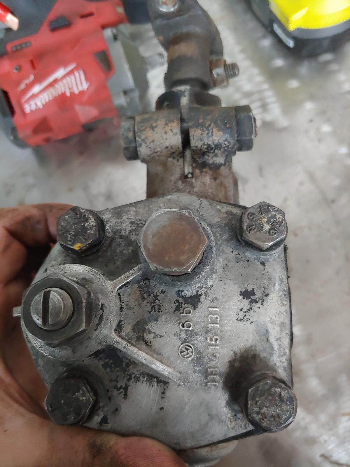

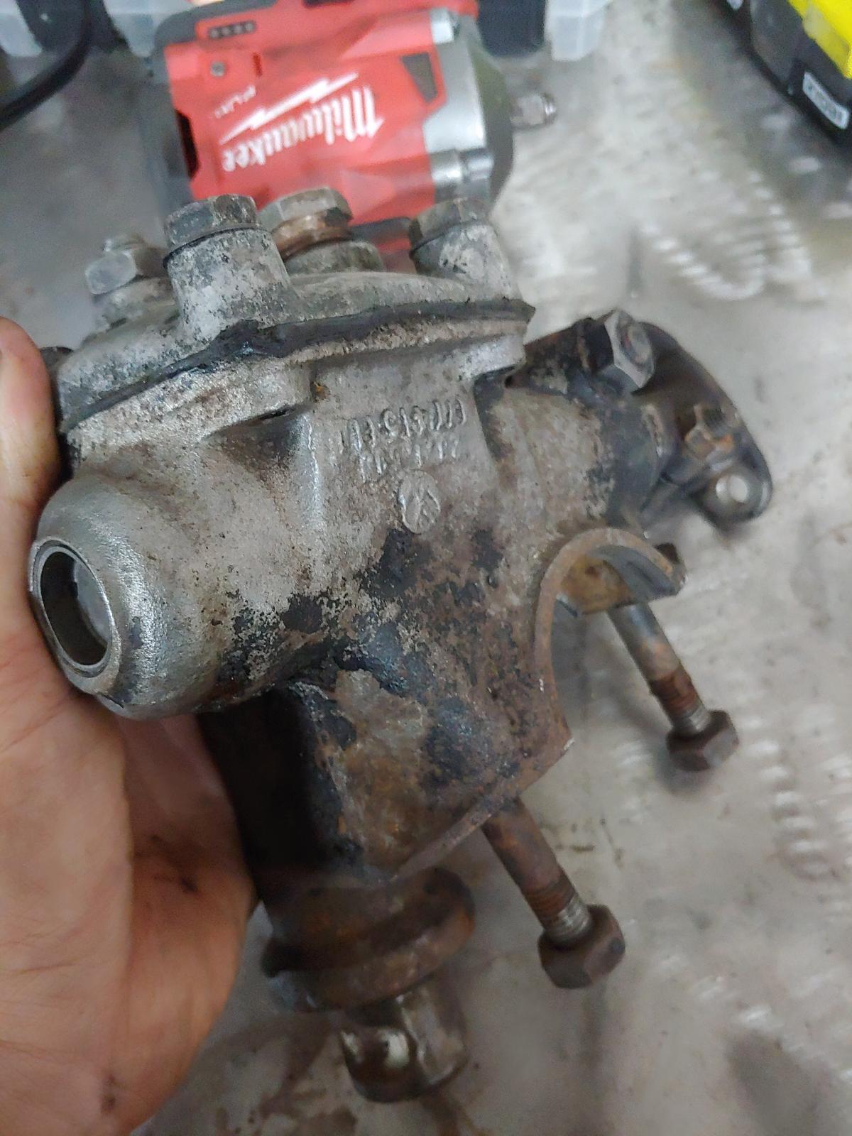

Okay so I have an April of '59 and my Dad has a June of '59 Beetle. His car had steering box 311 415 131 and mine had steering box 111 415 131. Which steering box is correct for the 58/59 models or are both steering box models we have correct for the car?
This one off of April '59 car
This one off of June of '59 car

PostPosted: Fri Sep 20, 2019 11:18 pm    Post subject: Re: '58/'59 Beetle Discussion Reply with quote
I have the same steering box like you on my beetle 59 from april (european model). The date stamped on this box is 18/03/59
Beetle convertible built 06/66
Beetle ragtop built 28/04/59

PostPosted: Sat Sep 21, 2019 4:51 am    Post subject: Re: '58/'59 Beetle Discussion Reply with quote
I didn't even think to look at the date stamps! My steering box is Jan 28 59 his is Nov 5 62 so it must of been replaced at some point.
