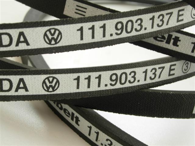

You should be able to get the correct 11.3x912 belt from your local VW dealer. They may have to order it but the part number is 111903137E. Not cheap but it is correct and you can save a lot of time trying the wrong belts. Good luck

What Viande said: genuine VW fan belt
