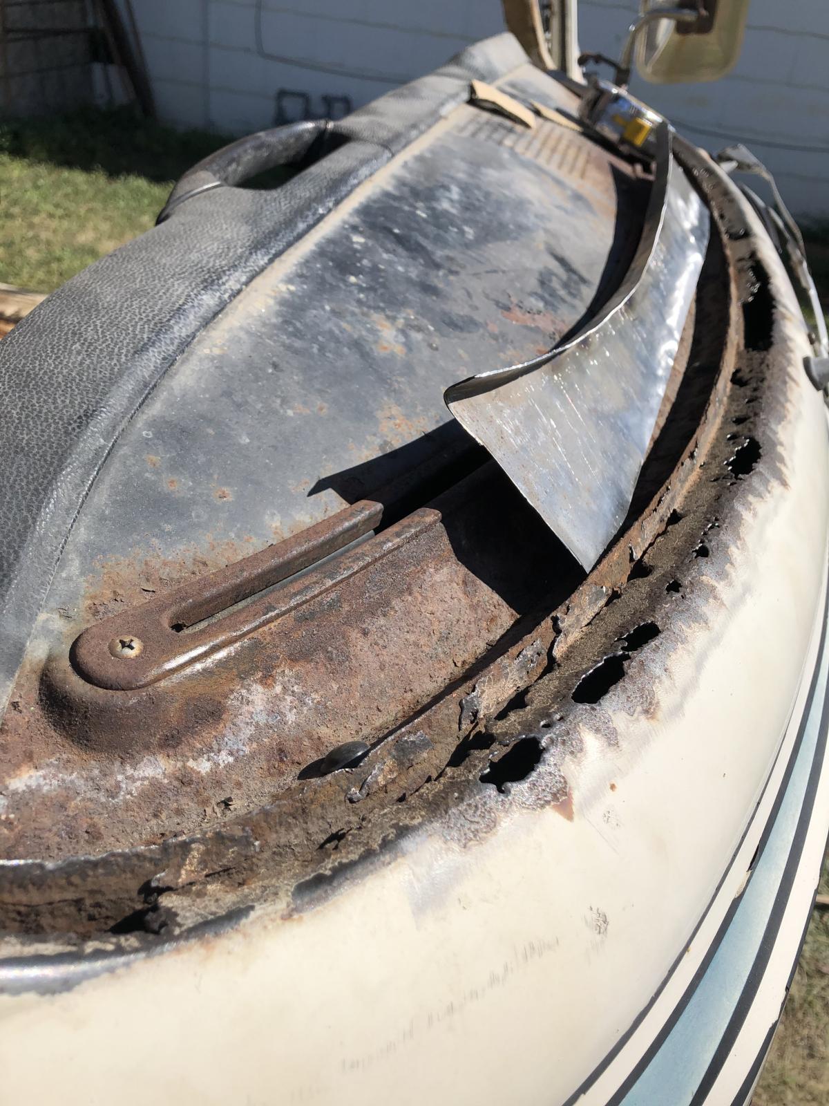

you'll never create that profile with rudimentary tools or skills. I know you don't want to hear it, just buy the panel
it will be the best 250 you can spend
https://www.klassicfab.com/product-category/bay-window-bus/windshield-repair-panel-bay-window-bus/
http://www.wolfsburgwest.com/cart/DetailsList.cfm?ID=211805040
I only have experience with the KF one.
seriously, don't waste your time.
judging by your pic, you won't hit weldable steel till at least the tops of the squirter jets. honestly you'll spend more in buying tools to try and do the job.
if that sill isn't perfect, you'll end up with issues either installing the windshield or with leaks. that is an area you don't really want any body filler in either

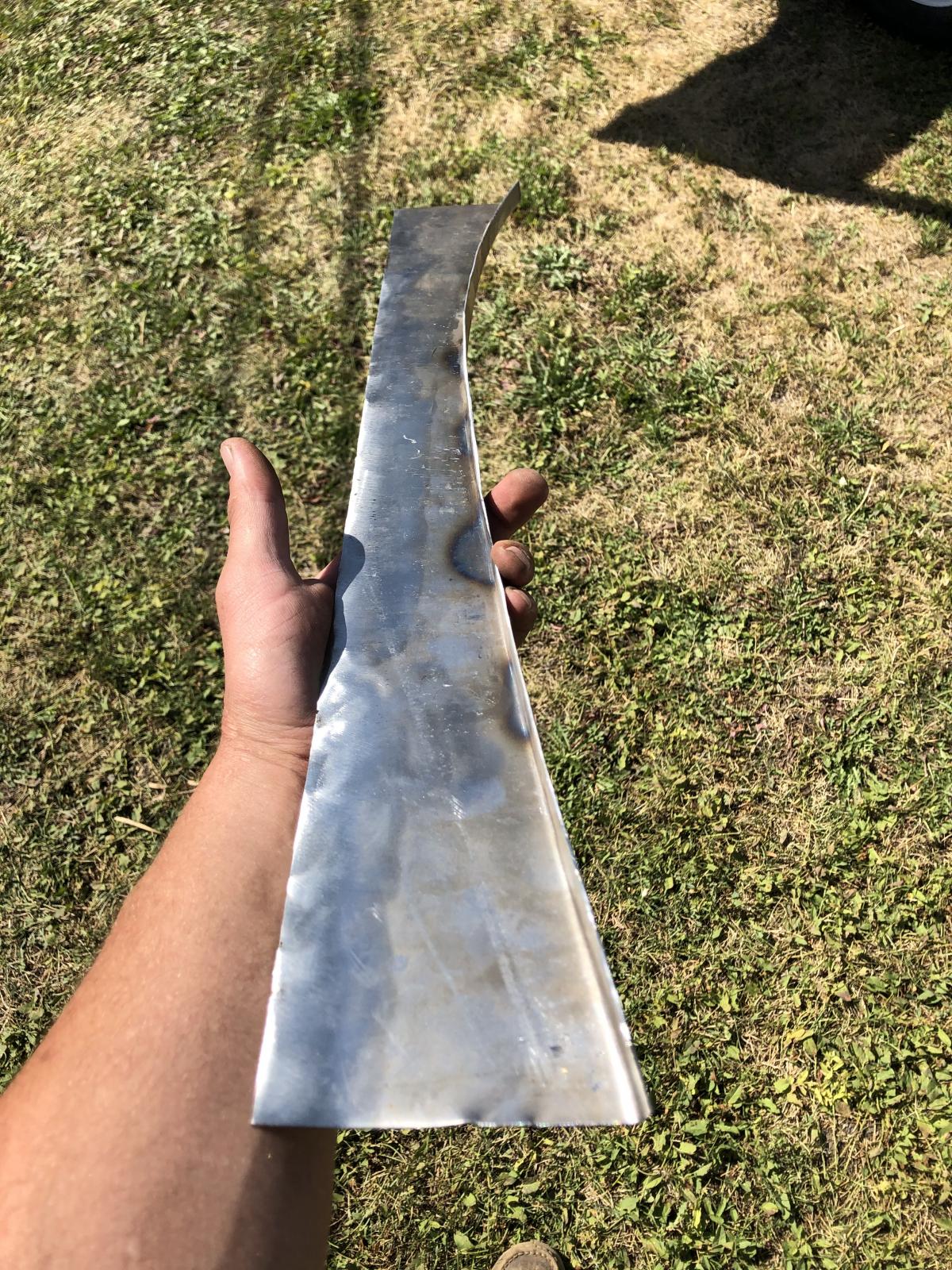

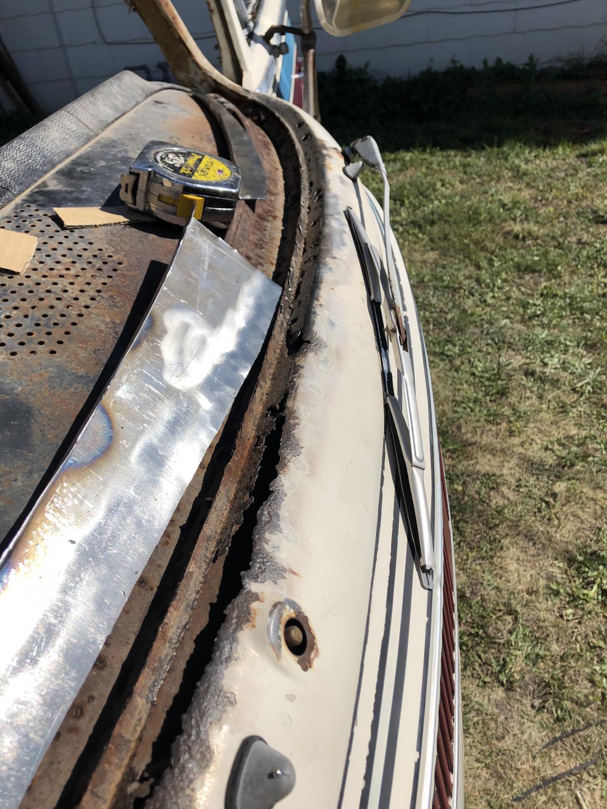

Well got to say I ain’t surprised with the response.. ok guess I’m on my own creating the panel repairs. Money wise I’m fine I’m just very picky with what I spend on. Maybe I should’ve clarified I do have work but not at this time. Anyways... I’ll need to do three different panels. You will see why I’m doing this. May need to buy a shrinker to make this work out.... I basically have sheet metal sitting around so I have nothing to lose but time.
Created a template to hammer the sheet metal into 90 degree using that as guide.
Looking good so far liking the curve now just need to buy the shrinker to match even better.
Another panel created. Again need shrinker for that.
Third will be easy to make since it’s in the center and flat so no problem there.

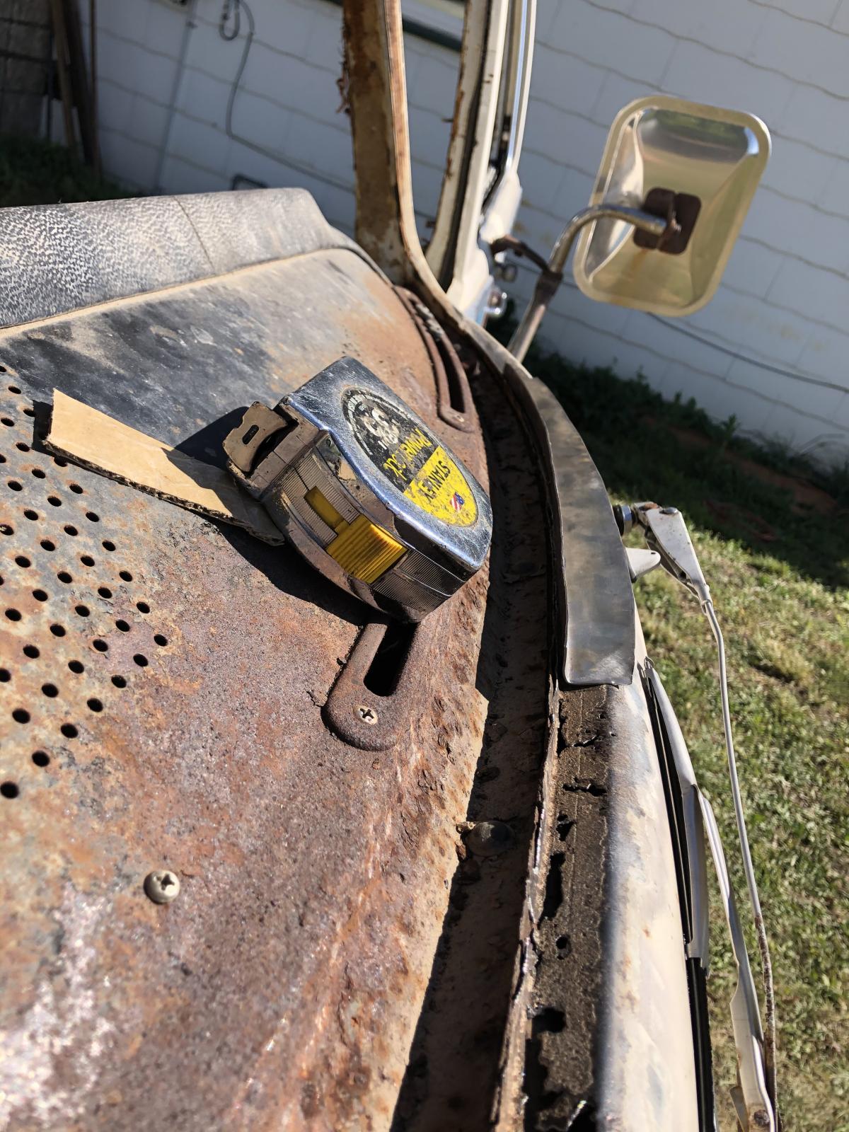

Lemme pull up more pics to give you better idea .

I did it that way, but my windshield surround was in way better condition. You would need to put another curved bend in you parch panels for starters. My repair came out good but I would have used the panel if I had known one was available even if I had unlimited time. Even if you didn’t factor in time I don’t think you would be saving much money.

Way too big on the lip, if you are bent on doing this with a shrinker/stretcher the horizontal lip must be of even size and narrow enough to almost fit into the stretcher's jaw (even width legs on an L). Then make the lower vertical part where the wipers stick out by shrinking the edges to curve and bulge it, there's no getting away from a seam where the horizontal meets the lower (exposed) section.
Or alternately build it in 2" wide vertical strips, much less welding going horizontal though.
By chance did you make some cardboard templates of the entire windshield hole, the loser curve and the vertical profile in numerous places before you started cutting?, if not fitting the glass back in may change your mind about home metal repairs. Wink

Yep I used cardboards to make them plus made the curve on that 1/4” plate so I can make the panel repairs. Don’t worry not even done with them still more to go. Like having plenty of metals on them until I finalize everything and happy with the results.

i'm not saying it can't be done...or you can't do it. when someone prefaces a conversation with I don't want to spend any money, it makes it hard to get on the "you can do it" cheerleading squad.
the problem with just doing the "shelf" is you'll lose the rolled edge where the seal sits if you cut too far into the bubble/belt line if you're not careful.
like I said, at minimum I would be cutting to the squirters and put a new panel in. you really don't want weld seams in a channel that is known to hold water. I have done a lot of these repairs, and have seen people fall into the trap of making that lower shelf a hard ledge. your windshield seal won't do much if that's the case.
just trying to save you from yourself and not discourage...many that posted here are trying to do the same. learn on a simpler, less critical area would be my advice.

You don't 'need' a shrinker or stretcher, but it will make much faster work of it.
The hammer-form you made isn't necessary either, though it looks like it's getting you in the right direction.
To shrink: Use some needle nose pliers or a tucking fork to put tucks or puckers into the side of the flange you want to shrink. (Think of the edges of a bottle cap). Once you get close to the curve you want in the panel, clamp it to the bench, heat the tucks until glowing with an OA torch and flatten the tucks. Heat isn't necessary, but it will make the process go faster.
To stretch: Use the chisel end of your hammer and tap at the outside edge of your flange to stretch the edge working your way into the corner of the flange. The outside should receive more taps than the inside. Think of the flat section you are stretching as a folding fan. The outside will have more surface area due to it stretching than the inside of the flange which will not need to be stretched as much.
You can make that panel in one piece though I guarantee it will drive you nuts as there is a lot of shape. When I did it I split the panel in the middle and did two sides. You are going to have a difficult time turning the flange at the outer section of the repair panel and doing the visible nose skin. I would just patch those sections separately up to the skin to channel flange before doing the inner channel. Once you cut the rusty flange out it will give you back side access to the upper nose repairs so can metal finish them.
You wont lose the shelf transition if you put it into the new panel. It just takes a bit more work. Scribe the width of the channel and slap the transition in over a soft edge stake.
With all that said, if you do this properly to a high level, the cost of the replacement panel will look like a bargain!
