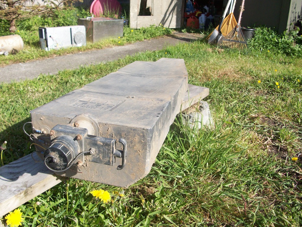

If anybody is looking for a real nice greywater tank that sits tight against the body I have this one for sale that was on my Adventurewagen!

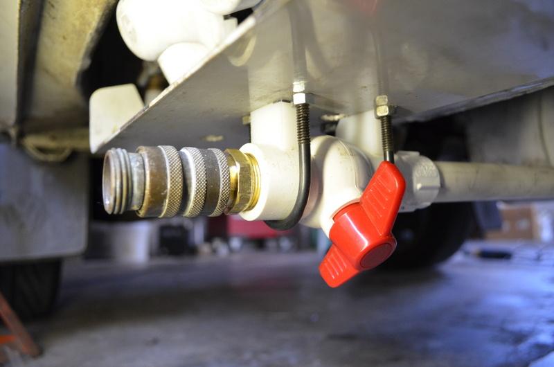

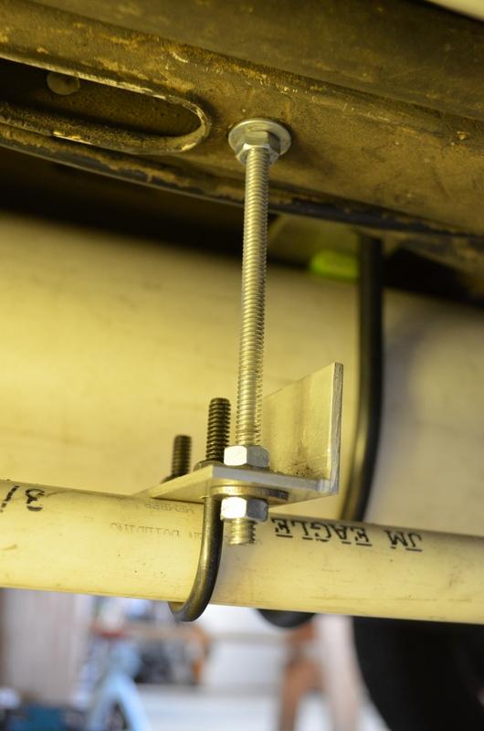

Here's a photo of the brackets. They are made from aluminum strap 3/16” thick and 2 1/2” wide. This is just happened to be the size I had in my scrap aluminum box. I moved the brackets further apart after the photo.
This is the drain to the tank. I'm not really happy with the vinyl braided tubing I used. It tends to crimp when it's curved under the frame. It works, but there are probably better choices.
Overall view of the drainage system from the tank and a closeup of the bracket that holds the PVC.
I drilled four holes in the LPG tank guard. The drain valve was spaced down with polyethylene blocks so the drain would be below the level of the tank.
I had to modify the drain pipe under the sink because the water flow was so slow. I did it in 1” PVC. I cut the original connection to the bottom of the sink with a tablesaw so I could use the threaded part to connect to the pipe. There's probably a fitting at Home Depot for this but I got tired of going there. I had to drill a hole to move the shelf opening about 3/4” forward to make room for the pipe. It drains great now.
We just got back from a 5 day trip to the Okefenokee Swamp area and nothing fell off, so I'm optimistic that this installation will last a while.
