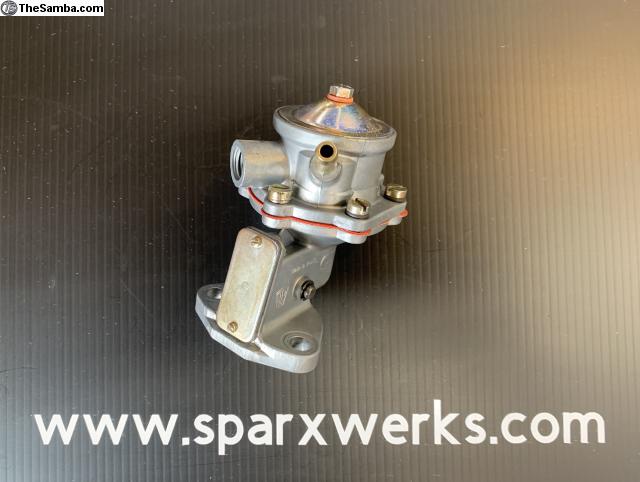

Try to return the Brosal pump and buy the correct German rebuilt pump from Bill.
https://www.thesamba.com/vw/classifieds/detail.php?id=2435397

Thanks, Glenn. I haven't purchased any pump yet. I contacted Bill to see what he has available.
I have an alternator but my fuel pump push rod is the long 4 1/4".

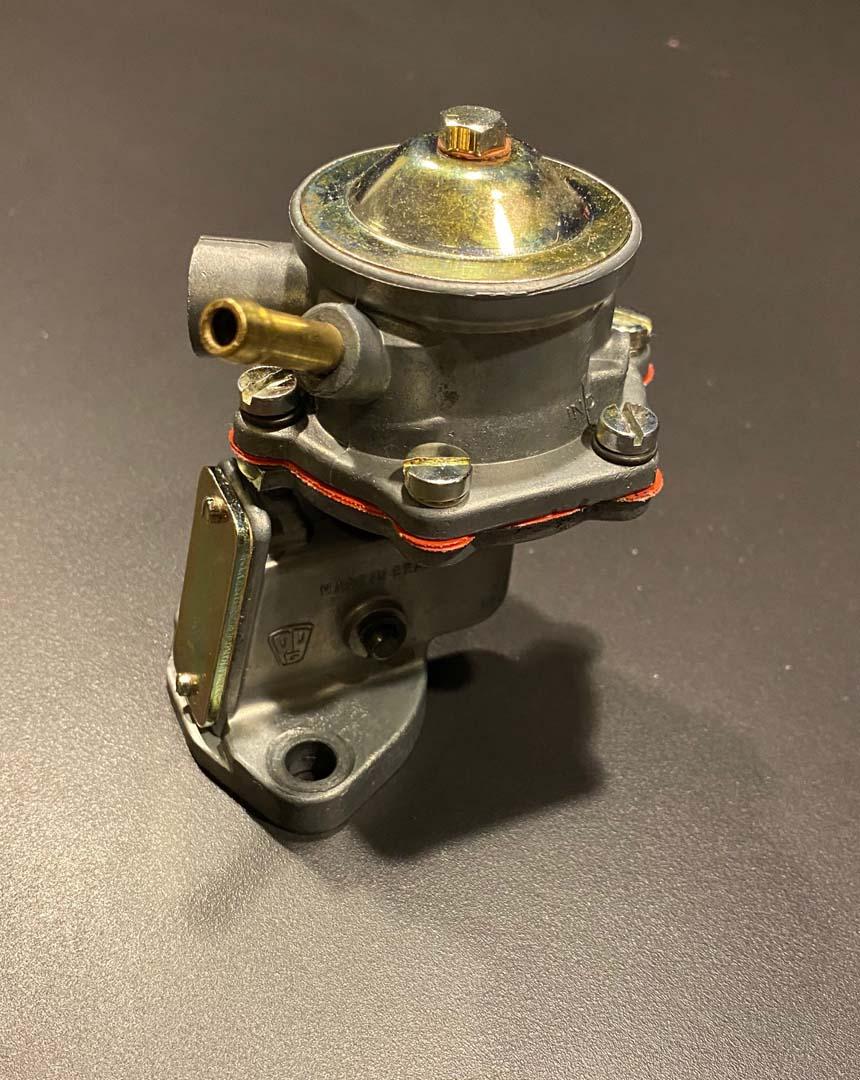

Here is my new fuel pump from Bill. Installing today.
'63 23 Daily Driver
www.scottmooreart.com
Scotts 63 23
Joined: March 09, 2002
Posts: 1280
Location: Somewhere in my mind... The Real er Laguna Beach :)
Scotts 63 23 is offline
PostPosted: Tue Dec 22, 2020 10:04 am    Post subject: Re: New fuel pump. Fuel line from tank question. Reply with quote
Fuel pump went in flawlessly. Back on the road.

PostPosted: Sat Jul 09, 2022 6:25 pm    Post subject: Re: New fuel pump. Fuel line from tank question. Reply with quote
Regarding the inlet pipe on the fuel pump discussed in this thread, they are supposed to have a pipe that comes all the way from the front of the engine and around the shroud. The pipe is secured with a compression ferrule and a compression nut.
Does anyone know of a milled fitting that is all one piece that threads into the inlet and has a stubby pipe inlet to simulate the later pump with hose fittings for the inlet and outlet.
I know people have cut off the pipe style to make a stubby inlet but I'm asking about a brass milled piece that does it all as one piece.

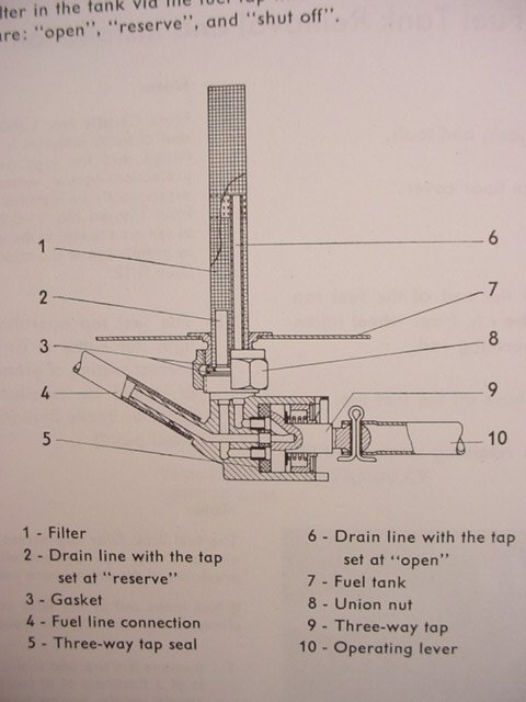

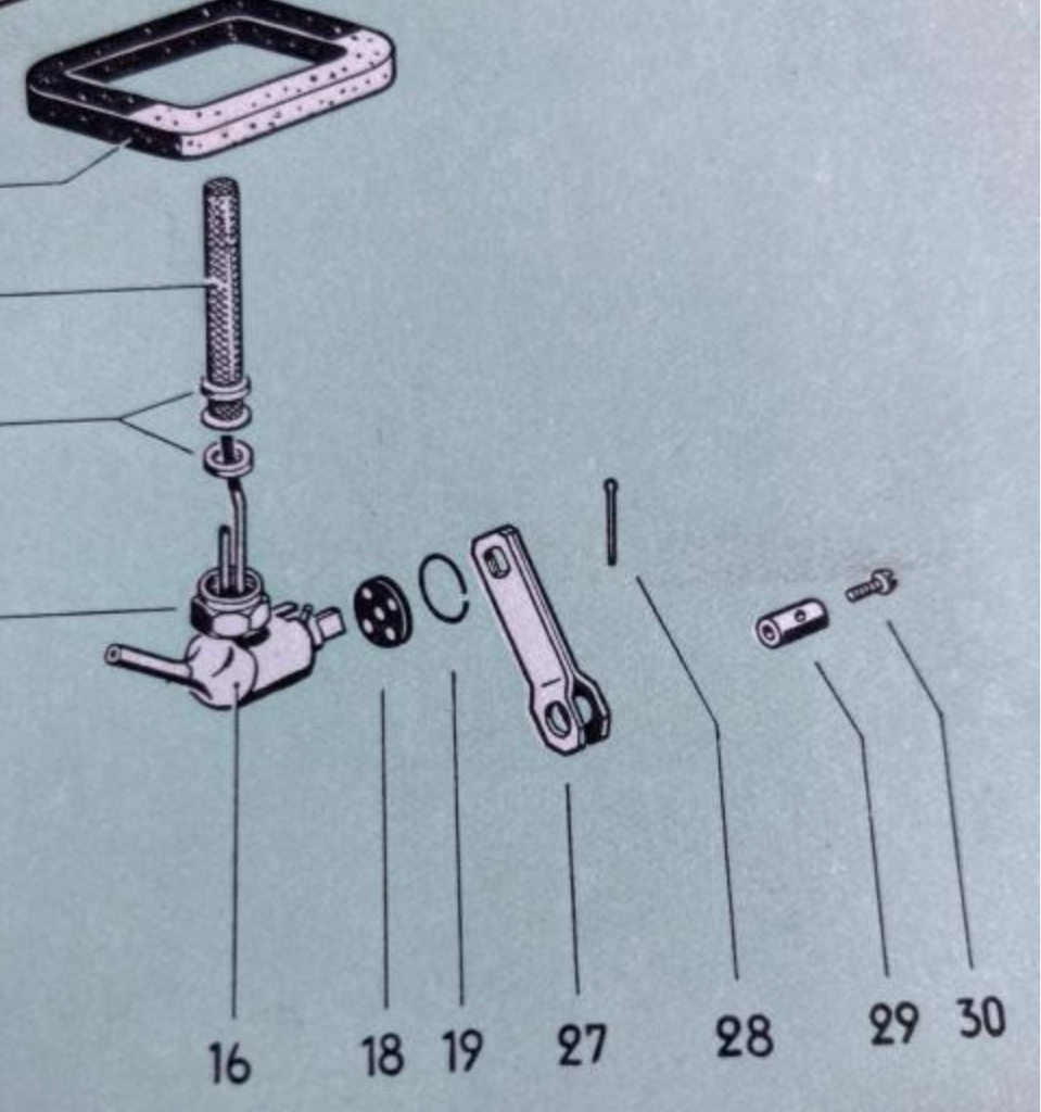

https://bbs.homeshopmachinist.net/forum/general/72731-copper-tube-work-hardening
Been using the stock fuel tap for the type 2, it goes into the outlet opening of the fuel tank. One could use a type 1 fuel tap that fits in the tank the same way, The type 2 tap has a lever on its side to be connected to a cable, while the type 1 has a kind of ball shaped connection on it to allow using a tube (with bent end for a lever) over the knob to be cotter pinned into place. Both the manual choke and fuel tap for the type 2 were a VW dealer install options thru 1967 model year. All ambulances had reserve fuel tap as stock til at least end of 1967 model year. Thinking of installing the reserve tap in our SO-34 with a cable just short enough to get the knob into the closet. Then when we need to leave the westie somewhere we can not keep an eye on it, the tap can be set to the off position leaving only at most 2 minutes of fuel in the carb. That way when someone hot wired it, they would end up with a non-running VW in the street, which draws way too much attention for a thief. Will be also installing a shifter lock.
From the type 2 parts manual:
Type 2 fuel tap:
In situ viewed from driver side:
Fuel tap from type 1 parts manual:
Type 1 fuel tap:
type 1 fuel tap in situ:
The type 1 could be used in the bus by drilling a hole (then install the grommet) in the main frame member and make a longer tube rod for it. That would make it easier to reach without having to slide under the bus. Right now with our 1963 SC have the type 2 fuel tap and have to slide underneath to operate it.
Type 2 fuel tap:
Type 1 fuel tap:
