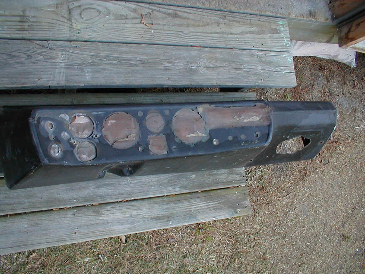

I have been working on the dash.
Pretty rough to start with.

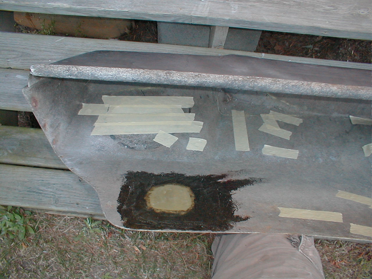

I sanded filled and reinforced it.
Primed it and tried to keep the original "vinyl" look. I could only keep the edge joint. (Black in the picture) The texture was lost during the sanding stages.

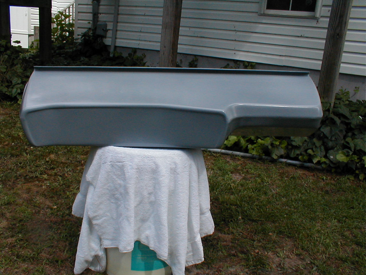

Here is what it looks like now.
It has gray gelcote on it and I think I will keep the gray and do the whole interior in gray. This will reduce heat build up inside here on the beach.

Looks great. Be careful of the light color on the top of the dash. It will put a glare on the windshield. Just a thought.
Put a piece of paper on your car dash and you will see.
Good luck on your build. Nice job on the dash
Have you thought about having it covered with "real" vinyl?
Google this.

Put a mat finish on the top of the dash...

Thanks for the heads up on the light color. I will check it and see if the angles cause me a problem.

I had never thought of using real vinyl. Have you tried it before? It seems like it would work great, I just don't know where I would get it sewn before gluing it down.

That is a good idea, I am trying to stay with the gelcote to keep it durable. But I could "scuff" it with some 400-600grit sandpaper and it should give it a nice mat finish.
