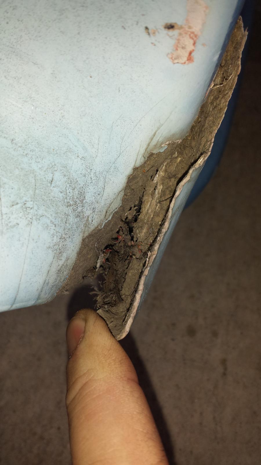

PostPosted: Mon Feb 15, 2016 10:18 am    Post subject: Re: Berry Mini T basket case rebuild Reply with quote
Ok.. So I finally got an opportunity to set up a gallery and would love any advice that anyone can give. Lots of work to be done and any time saving tips (meaning anything that others might have learned over the years so as not to make major mistakes in this project) would be great.
As you all can see, there is some damage to the front passenger side of the buggy where there is clearly some core damage to the fascia so wanted to find out from you how that would be repaired and keep the fascia intact and laminated so that it looks like the original bodywork. Do I cut away all the damage first and rebuild from scratch? Do I just cut away the broken edges of the top layer and remove all of the underlying damage and rebuild from the inside out? Questions questions!
Another area of concern is in the interior of the body where the inner tub seems to have a little bit of a separation at the shoulder on the passenger side where the tub itself is attached to the chopped strand sprayed fiberglass inside the body. It looks like either over the course of the years the fiberglass underneath the tub might have swollen due to heat and or moisture or when it was originally fabricated there was too much chopped strand sprayed into the mold and I wanted to find out from you if you have any suggestions as to how to repair that inner chopped strand that was made in the laminate so that the tub will fit correctly and I can install new upholstery. (The first picture is of the driver side where the body and inner tub fit together correctly. Also I know that some of the photos are closeups but the further out I get to snap photos, less can be seen of the issue at hand.)
I'm sure I will have more questions as I get involved in actually doing the work on the body such as how to re gelcoat or paint and which is better, and finishing techniques after the body work is complete.[/img]
