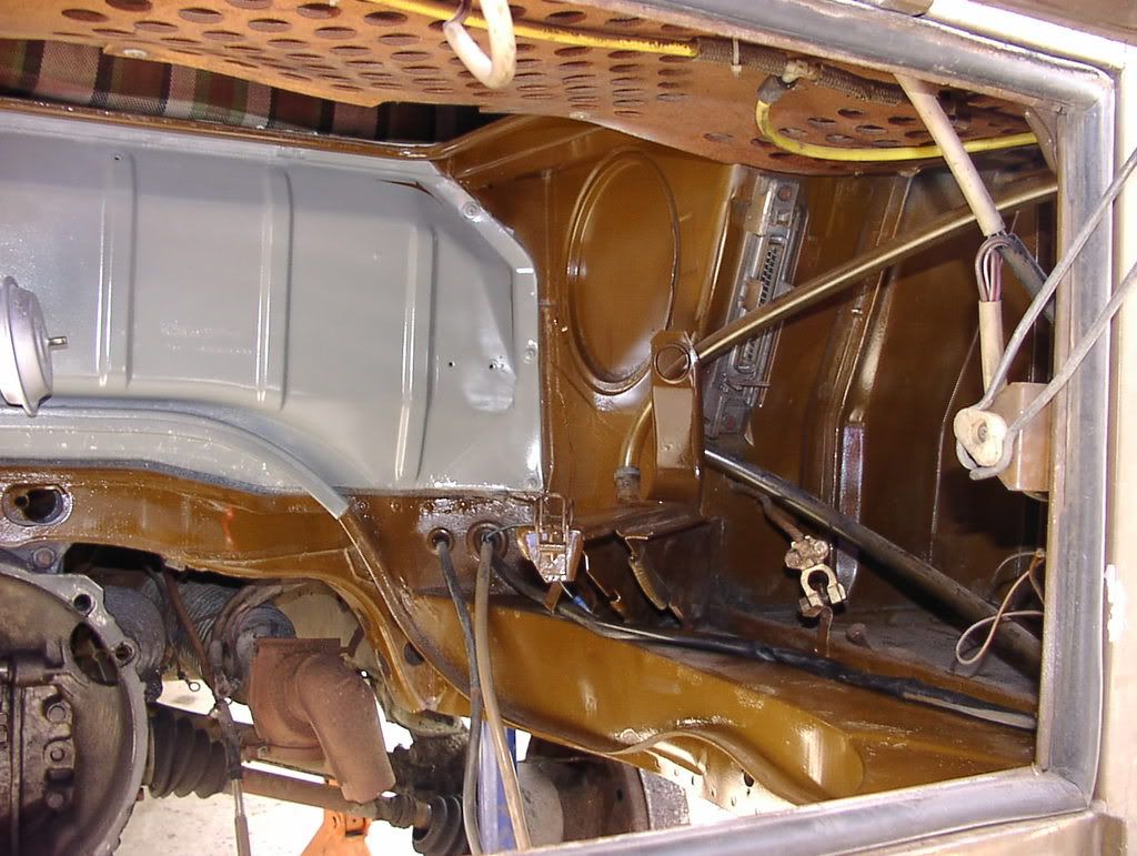

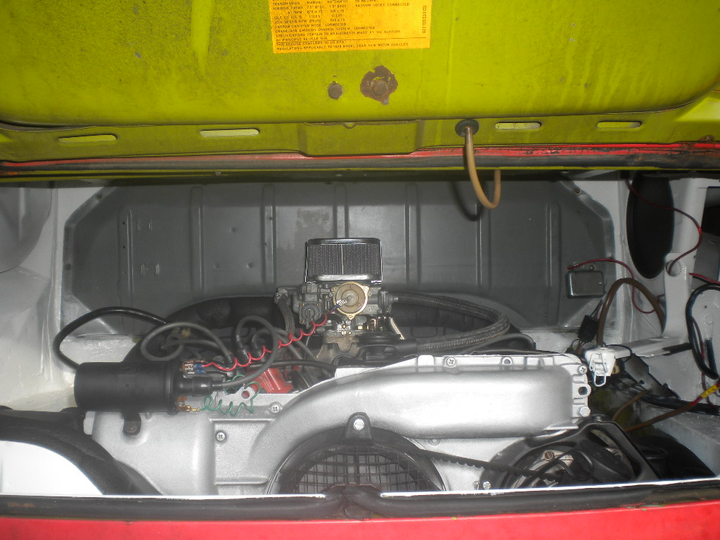

I degreased/ (and used mineral spirits) cleaned up all wires/connections...
then painted tin/fan shroud with high temp black and silver....then used white appliance epoxy spray paint (hardware store) to paint compartment...I used the same white paint on wheels and has held up for years...I didn't remove engine...just removed engine seal/ battery and covered/masked everything up...paint prep time about 20 minutes ( tin foil works great to cover small stuff )

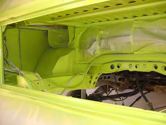

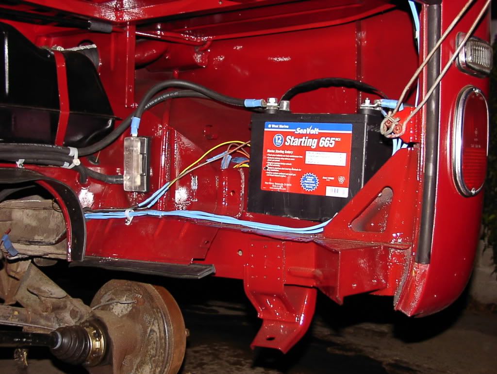

Scrape it with a putty knife and wire brush, wipe with solvent. Sand, 180 or 220 grit, wipe with solvent. Prime the bare spots, sand again with 400 grit and wipe with wax and grease remover. Get some 3M Heavy Duty Drip Check, (One of my personal favorite products, it shrinks as it dries and holds paint very well, cool stuff) and seal any seams that you can get to. One more round of primer, pay extra attention to the battery tray area. But not too thick. Quick sand and another wipedown with wax and grease remover. Wipe down with a Tackey Cloth, you get them where you buy paint and they are a must for a good paint job. Paint it the same color as the body. Single Stage, Omni is what I'd use.The engine compartment is a busy area that hides mistakes very well. Its a good place to start, or learn about painting. This is a project that has a big payback at the end. Mine turned out so pretty I wanted to lick it. But thats another story. Thank God for Samba. Something to keep my hands and head busy. Who needs all of the TV, Talk Radio, Politics, Media Money Churning B.S. . I get all of the Comedy/Tragedy/Drama/And Success Stories that I need right here in the Forums.
Quick P.S. After you have finished putting on the finish coat, walk away. Any boogers will be much easier dealt with AFTER the paint dries. DO NOT TOUCH IT WHEN IT IS WET. Ever. Period.
