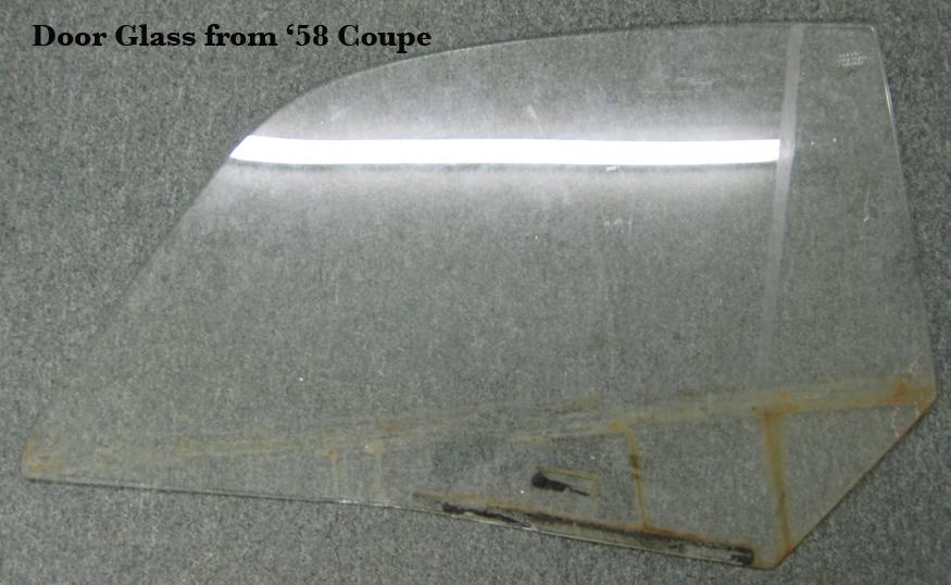

This is the door glass that came with the '59 (marked 58 coupe). It's badly scratched. Probably from the worn out and missing rubber roller (see below).

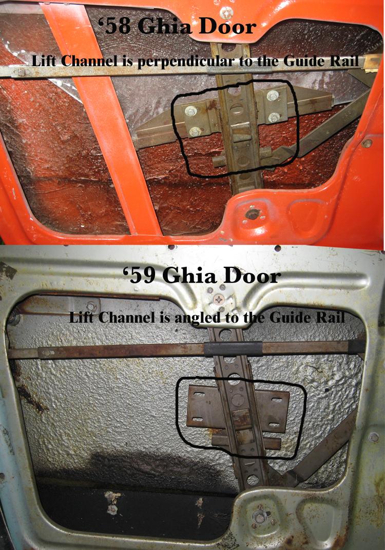

Photo taken from my '58 Cabriolet. Notice the strip of track for the Lift Channel that has a rubber roller.
This is a comparison of a '58 and '59 door.

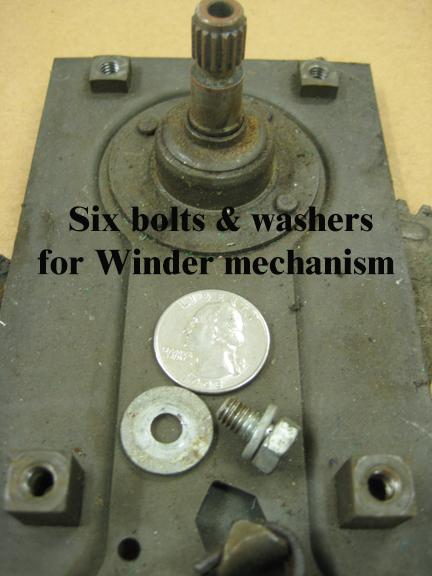

I like to keep a log of screws used for Early Ghias. Here are the bolts used for the door glass mechanisms.
This screw looks exactly like the screws for the door hinges except it's a flat head. A beveled washer is used but not showing.
(6) bolts and washers for the winder.

It looks like you have a late production 59 that would use the 60 and later door glass. Great documentation on the door diferences!

A quick look in the old Ghia parts book provides the following information (be warned that this is just a guide, since there was no hard and fast rule for when the new parts were actually installed)
1. Door glass up to chassis number 2 395 180 (roughly Jan. 59)
2. Door glass 2 395 181 - 2 528 667 (roughly Jan 59 - Aug 59)
3. Door glass 2 528 668 - 141 3200 000 (roughly Aug. 59 - 74)
This would mean that there is a 1/2 year style of glass! Yikes, I never realized this. Does your vin number fall in the 2 395 181 - 2 528 667 range? I just checked and my rough all original 59 Ghia falls in this range. I can take some pics of the door interior if you like?

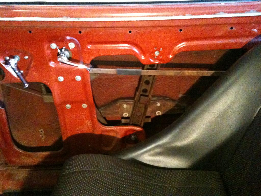

Pics are a little crappy I'm afraid- From the iphone and with the glass installed you can't really see that much Sad
Confused Sorry if these don't help much-

Thanks for sending, Seth. Notice in your photo the window lift is level versus the angled of '58 glass.
I haven't received the glass I ordered from an Aug '59 yet. I'm curious to know about the holes in the glass. Does anyone know what year they appeared? '59? '60? Think
