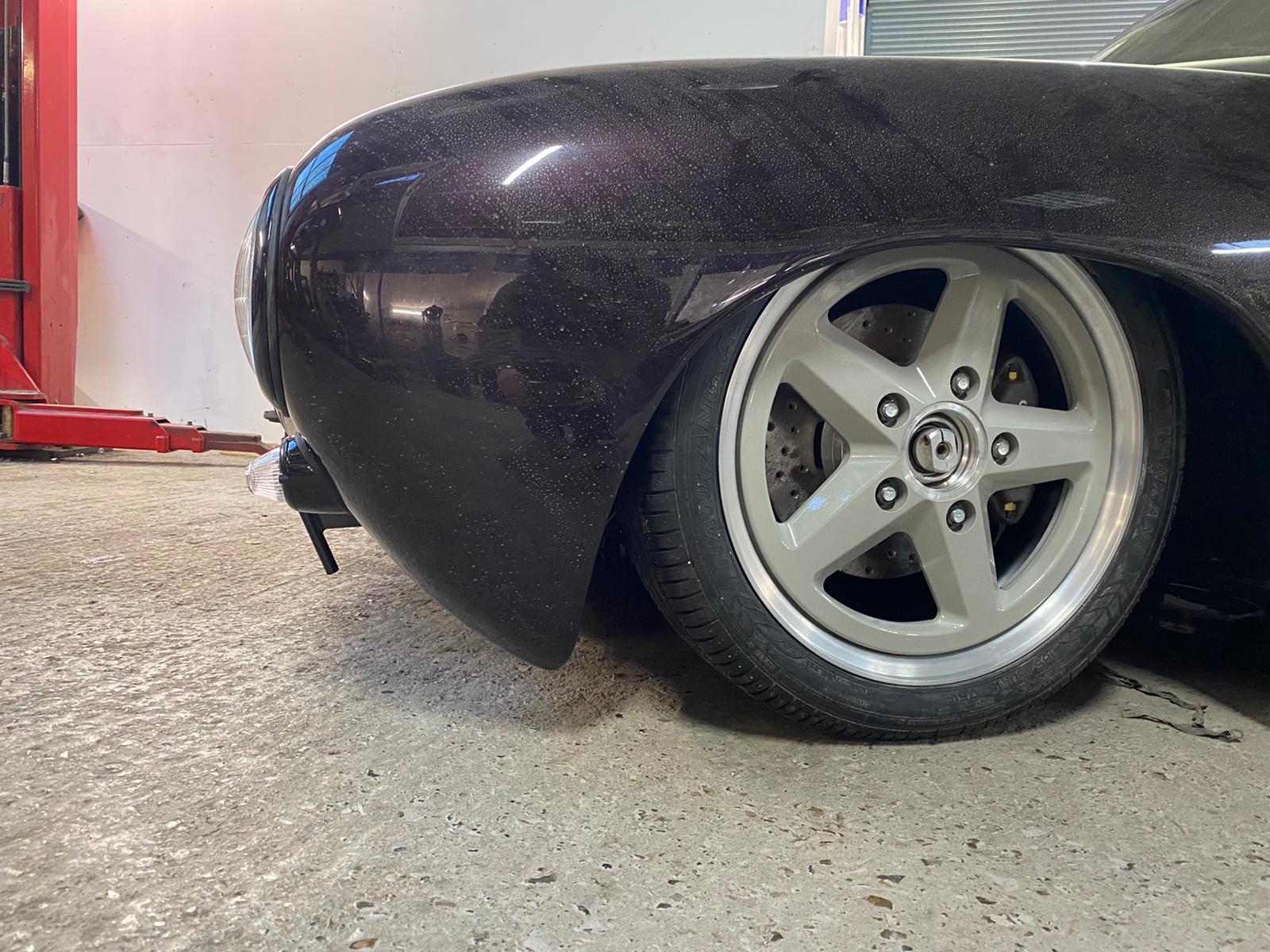

figured it was about time to share some photos and details on this full resto, modified 59 lowlight build........
WIP for the past 2 yrs. I'dd do my best to bring us up to speed ASAP........car is currently 98% done. Plan was always to build this with Volksworld 2020 in mind, but hey CORONA had other plans. Shows get cancelled, life goes on, builds continue.
plans for this car were (are)
full resto, show quality paint.
Airride suspension, 2276cc on IDA's, crank trigger igntion, custom interior with Porsche 914 seats and some nice interior details.....Purists should prob look away. This is a custom build, modified lowlight. I have the utmost respect for anyone who embarks on a stock resto, or anyone who perseveres with 50's mechanicals, but I prefer to do them my way. Way I see it, this ghia was lost to the world, I'm bringing it back to life my way
First off, some photos from the original ad on The Samba, collection at the docks in the UK, and strip down.
anybody remember this rather sad looking lowlight for sale coupel years back? Well it ended up in the UK. Collection day from the docks in southhampton
made it home, in good company
This car was rough - but i knew that going in. Engine fire in the early 90's, sat in a barn since then. No engine, scabby interior, but it seemed solid and had all the right bits i needed. This was always gonna be a custom resto build, i needed a solid body and pan, the window trim, lights, and not much else.
Jumping ahead to how it is today, I'll fill in the gaps but heres a sneak preview
more to come

yeah its a lovely colour, must've been a stunner back in the day.
engine is a CB Performance "builders choice" 2276cc built by GAC in the UK. We changed out the cam to an FK7 for max torque lower down. Fueling is JayCee 51.5 IDA's, on CB Performance magnaspark crank trigger. Bergmann Porsche coooling (yeah I've read the hater threads, I went with it so save me). The Porsche style cooling required Dub Shop trigger wheel and VR sensor mount all made to work with CB magnaspark. Linkage is SyncLink

its running the Limebug (UK) air ride setup, weedeater front beam and their rear suspension cradle with AirLift 3P control. CB dropped spindles up front.
Air tank and compressors are up front behind the fuel tank with the manifold/ECU and wiring under the rear bench
