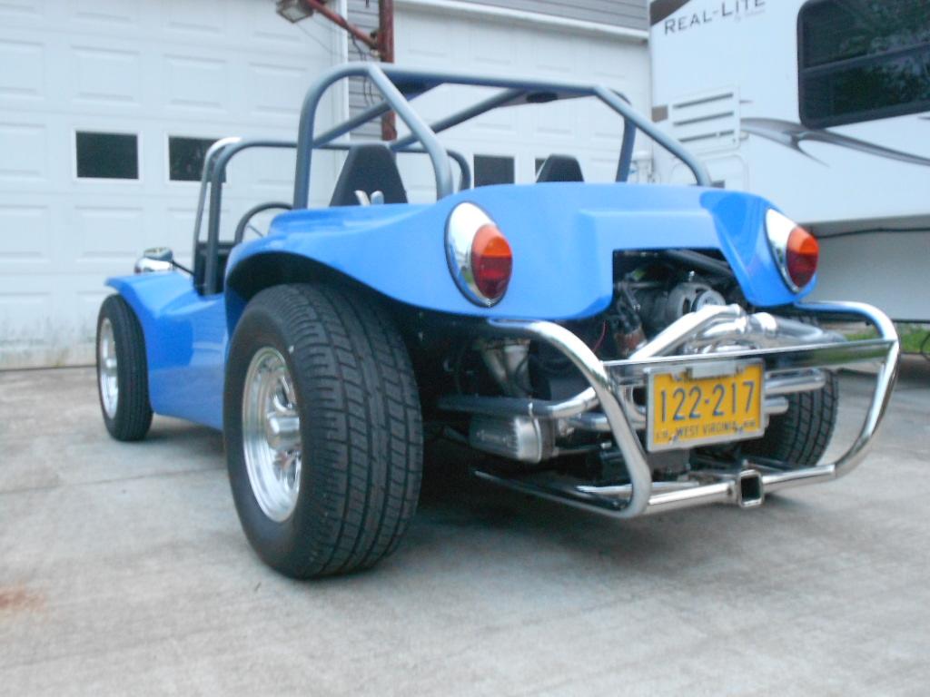

Here are 275 65 15 on a 8.5 X 15 rim with 5.5 inch backspace and a 1/4 inch thick spacer between wheel and disc brake on IRS. The body was 1/4 inch overall wider than my Manx body, (1/8 inch per side wider).
