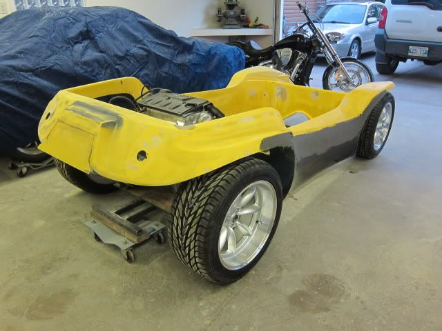

Some teasers of the new project...

That looks insane! I like it a lot!!!!

Nice starting concept! This could work well... what are the plans for the suspension?
I could see Mazda Miata or 2nd/3rd generation RX7 suspension parts being put to good use here.

My new hero!!!! WOW!!!!

A Fiero front suspension would make an easy disk upgrade since you're doing some crazy stuff in the back...not sure if you ever gandered under the skirt of a Fiero but it sure looks like an easy candidate for a front suspension swap...any time at the JY I always take the time to absorb new info that could be promising for future projects.

That's exactly what I wanted to do! Unfortunately when I started I didn't have the ability to get it done plus getting it registered here would have been a major pain. Can't wait to see how it turns out! Which engine is it the 1.8 out of the Corolla or something with a little more juice?

Nice! Concur with the Miata front crossmember/suspension.

Some details...
I ordered a rear deck lid from Mrs. Meyers - Hide that engine.
The rear suspension is from a 300z/240sx with tubular arms and aluminum uprights - Its gonna be tight! But tons of room aft of the engine now.
The front...I have an all new VW narrowed, lowered, disc set up but I really want to try and do a Miata, but I cant find one in any yard around here. Thats why the front is still blank.
The engine is from a 2007 Toyota yaris. 1.5L, 110hp. If its not enough I will be building it with the option of a turbo later.
And...its an automatic Shocked

For the front suspension I'd really like to go with the miata...
If anyone could help in locating one that would be great!! Very Happy

110hp will be plenty unless you really want a handful...you'll still be able to rocket launch that thing with no problem...might even check some of the local automatic trans shops to see if maybe they can modify the valve body for some tighter shifts...even though it's an auto shift car the stock Yaris weighs around 2k so you have removed well over 1200lbs so it should be pretty preppy...a note on the Miata front suspension, if you visit the flying Miata web site you will find any parts you need used or new and race stuff...they even have a full tubular front suspension kit...this stuff is spendy but their parts are top quality and have a nice finish...the auto trans will definitely make for an easy install...I will follow with much interest!

Great news...the last yard to check here in town was closed yesterday. I called today and they have a complete Miata...front suspension? How's a hundred bucks sound? - Sold!
Removed and ready for pickup (hopefully) by friday.

I am not in the know about how a Yaris uses a shifter, but I am going to guess that the different shifter positions are all in a line, which will allow you to use a cable actuated shifter, which would dramatically simplify changing gearshift positions. Very cool build idea.

You are quite right Very Happy ...and an added bonus: more foot room and (of course) no clutch pedal.

Man every time I log in I'm checking for updates on this build be sure to post up detailed pics of the subframe and undercarriage. Good choice on the auto trans to I was thinking trying to fab up a shift linkage for a manual trans would have been interesting...what are you going to do for a VSS for the auto trans? Digital speedo with output maybe? I swapped an 89 Corolla engine into my build now I kinda wish I woulda mid-mounted it like you did but at the time I didn't have the ability plus I wouldn't have been able to get it insured (stupid ICBC) ... Toyota's wiring is pretty simple to especially compared to Subi's. Stoked to see how this goes Exclamation
